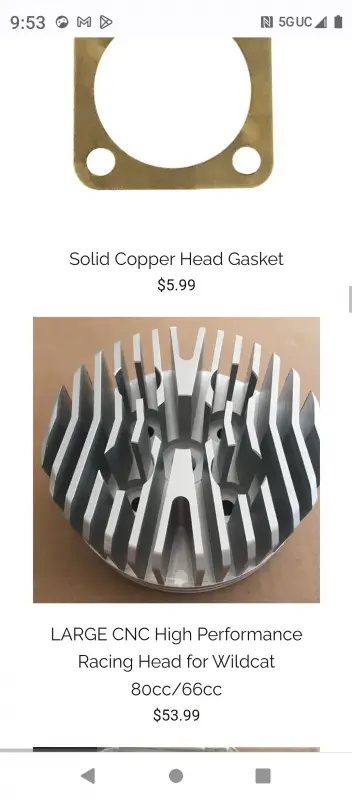

One idea I plan to try is adding bolt on fins to the head to reduce heat, I’ve often thought it would help. When I do this I’ll start a thread to show the results.

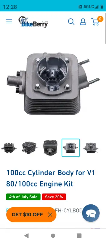

I thought about stripping the fins from the 110 cylinder and using muggy weld to solder them to a phantom jug... With a rag soaked in water to keep the cylinder coating from peeling... Bike berry has a new 100 with fat fins I'm waiting for the cylinder alone to become available... The V1 has some decent cooling... The V2 is set up for a pugeot 103 ?? reed... Every day there's something new... And there's the LD 90 and 100 that are 2 piece... People have been adding a 3rd transfer to those with good results...

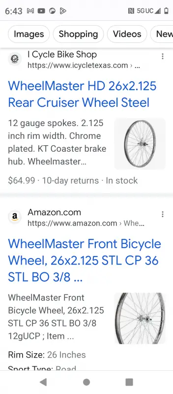

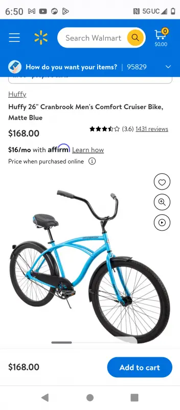

Those Bayside aluminum frames eventually are going to be problems... A steel frame is something that's going to last longer and repair easier... I put together the basic tried and true beginners basic kit... The majority of the builds are on a Cranbrook with wheel master or something similar wheels.... The 14ga aluminum rims Bayside is ... I had one... It was pretty flimsy just pedaling it... Like anything else there's always another upgrade...
