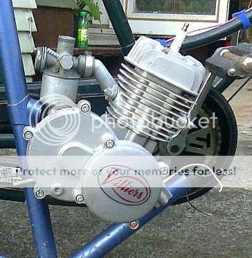

Something I noticed with my China Girl engine that's pretending to be a Villiers engine, - it has an undrilled boss on the clutch cover that looks like it was intended for an oil level plug. Anyone else have an engine with a clutch cover like mine?
No I don't recognize the cover and I dont recognize the carb on your CG there either.
Iteresting though since we have a couple people on here currently working on a possible wet clutch setup for our CG's.
Just wonder if the centrifugal clutch would still grab and hold if it were to be a wet setup..??????
The engine was made to the special order of a trader here in New Zealand. He's no longer importing MB engines and parts though as he's moved onto agricultural machinery.
The carb is the one Villiers made in house for their two stroke engines. Brilliantly simple and very reliable :)
I wouldn't like to say whether or not the centrifugal clutch would still work or not if it was wet and I'm too much of a cowardy custard to want to find out in case I break my nice engine.
Excellent....
There were two versions, one a dry clutch and a wet version.
Yours must be obviously a dry version since the boss isn't drilled.
I believe the wet version has cork shoe faces.
