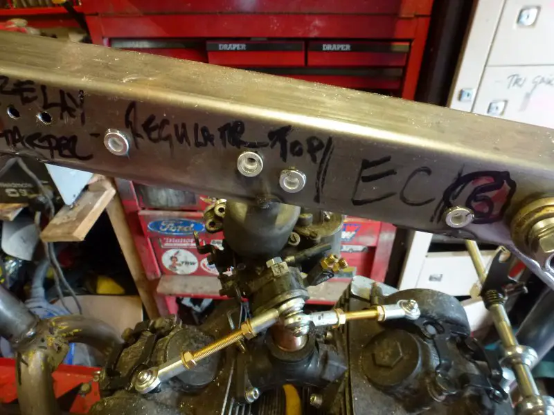

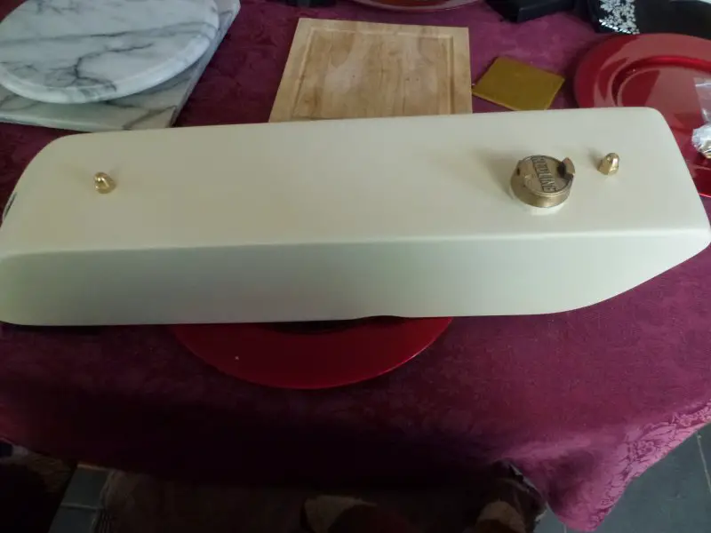

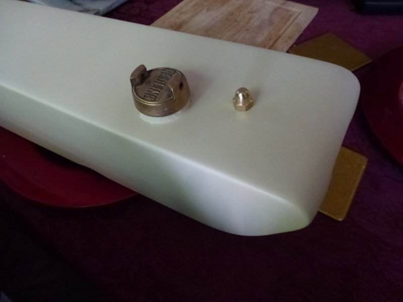

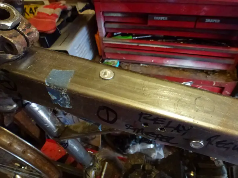

I decided against using a leather strap to hold the tank down and settled on a couple of Rivnuts in the top tube with some brass allthread and domed nuts. Got some nice oversize brass washers to go under the nuts. They are not doing any work as the "tank" only weighs a couple of pounds.

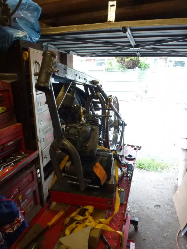

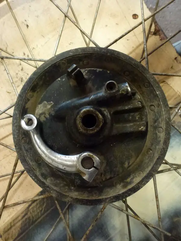

Now becoming a collection of parts again [ !! ] as the POC mock up gets pulled down for the frame to be fully welded, bearings stripped from wheels [ for powder coating ].
Had to skip the mounts for the foot pedals and gear / brake , but I did get a rough mock up before stripping down.
I was able to finalise the front brake plate position and by a stroke of luck the lower fixing screw for the bottom clevis of the front fork hoop can be aligned with the original Honda brake torque slot.
Only major headscratching now is how to get the rear exhaust header in to clear the fuel cell. No big deal if you are a welder / fabricator - there is room - but I need to be able to mock it up accurately for someone else to fabricate.
I need to get the seat and tank back in place and securely attached so I can sit on it and figure out the ergonomics - I want to be able to ride it !! One day.

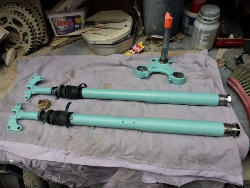

I decided that I didn't like the polished lower fork stanchions against the black gaiters, so took a step back and painted them in the main frame colour. Bit of overspray on the gaiters [ mask up properly ! ], but that will clean off easily enough.
I was a bit reluctant to change from my original plan of Coffee and Cream for the colourways, but I'm pleased with the colour combo.
It's difficult selecting a period correct colour, but the Celeste Blue is the correct original Edoardo Bianchi colour and still used today on their bicycles.

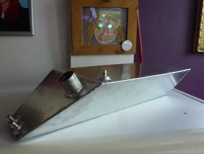

I've ordered some 35mm plastic plumbing fittings ..... my cunning plan is to use these to mock up the rear header to clear Valor tank...................
There is a plan B - ditch the Valor fuel cell in favovour of a tank under the engine - I've done this before successfully [ also my KZ750 Cafe Racer ] .... but the Valor can is growing on me - comments ?

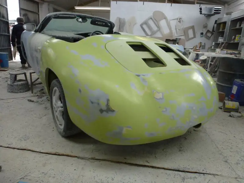

In the days when I had good helath, workshop facilities and a dozen skilled craftsmen working for me I designed, prototyped and built POC machines in my spare time from my day job - designing, building, manufacturing and marketing replica sports cars. That's what paid the bills and allowed me to play with my passion hobby stuff - bikes.
The Oilhead Cafe Racer went from a "whatif" to a riding prototype in 12 weeks, the Boxster based Speedster in 16 weeks from the 1st pic to driving pre-production car.

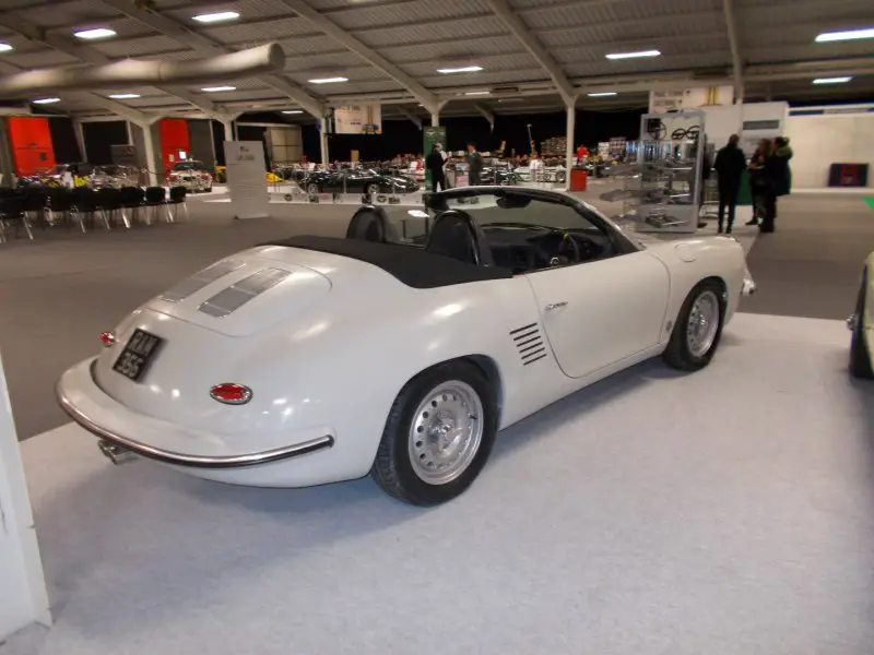

One of the guys in my vintage Volkswagen club has a Beck Speedster replica... It's a really nice car that has a full tube chassis!
You can see some of our cars here... WestSide VolksWagen Club (@westsidevwclub) • Instagram photos and videos
Sheldonhurst Ltd. and Legend Motor company.
Some very nice club cars.
Sheldonhurst was where I designed and manufactured my own version of a 356 Speedster - and later a T4 Roadster. I was also a freelance design consultant for RAM automotive [ Shelby endorsed Cobra ] and Mohr Innovationnen in Germany.
In my Legend days I designed a 550A Spyder as I wasn't a fan of VW Floorpans or backbone chassis.
