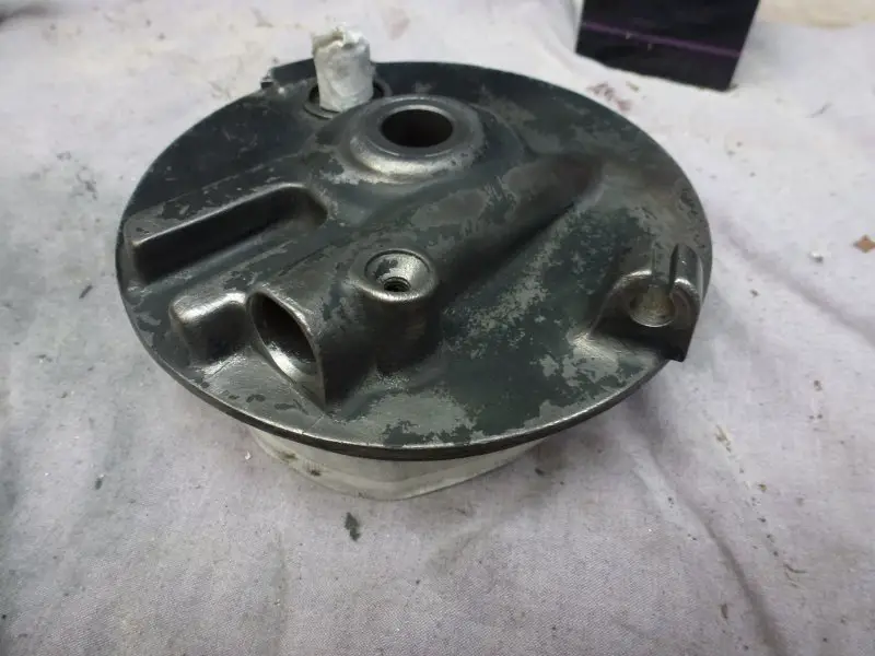

Wheels stripped and bearings out.
Just got to make up a couple of blanking plates to cover the brake surface then they're ready for powder coating.

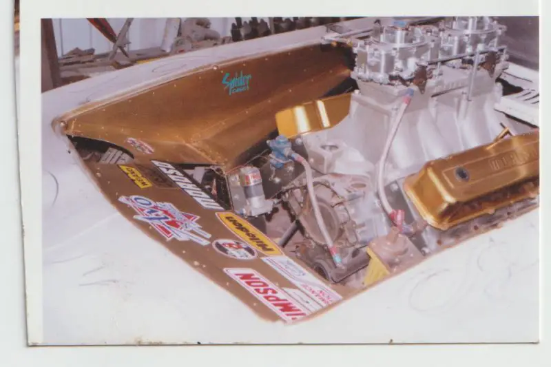

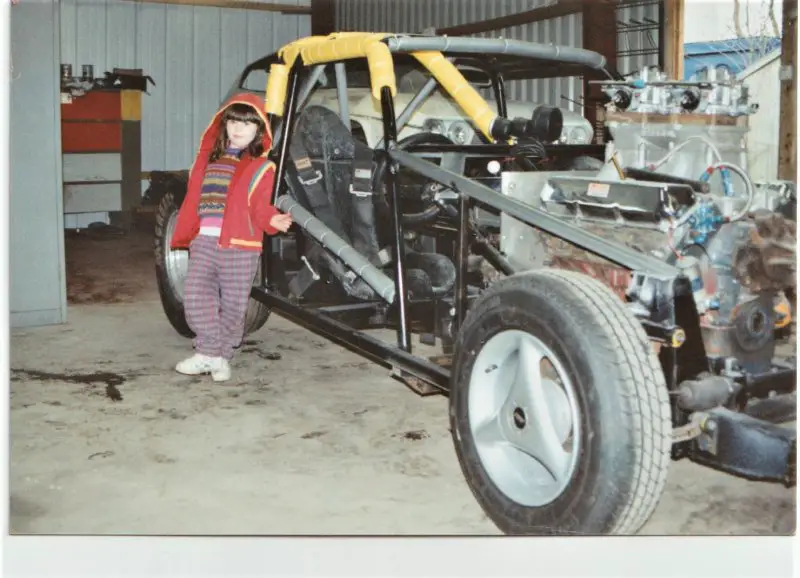

Fortunately I have spent 50 years designing and manufacturing spaceframe car chassis - including a couple of '27T Alky Altered's.
As I have admitted - I am NO welder, but have been fortunate enough to employ many superb [ and coded ] welders during my time in business.
The guy doing my welding is such a professional welder and I'm sure he will work to the advice you have given.

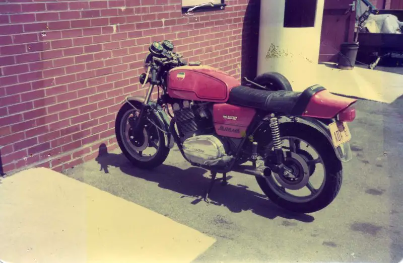

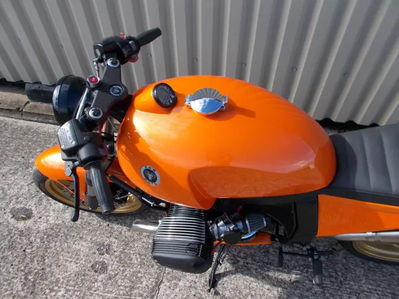

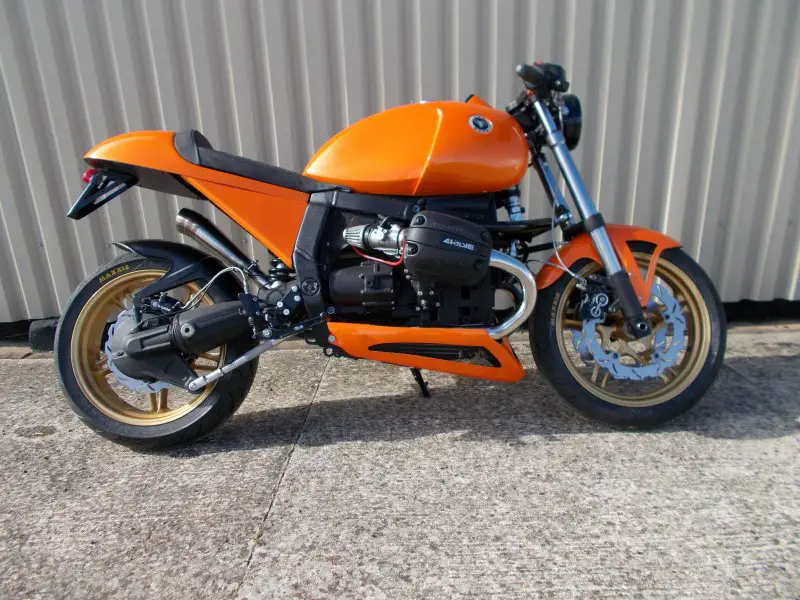

SOME OF MY 100 + SPECIALS PROJECTS............

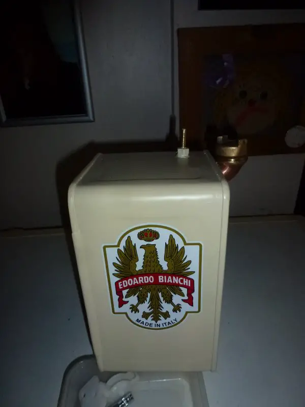

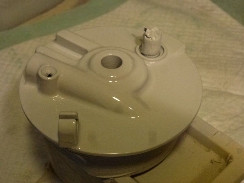

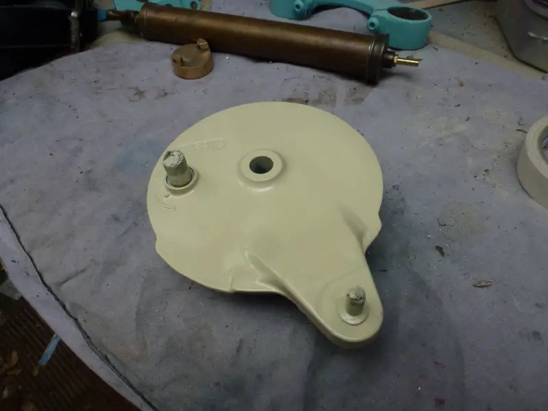

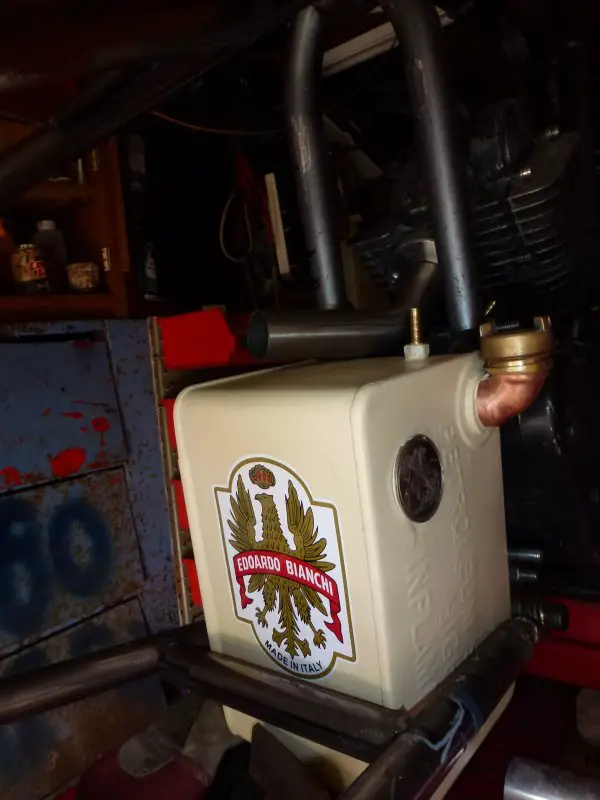

Fuel cell is finished now.

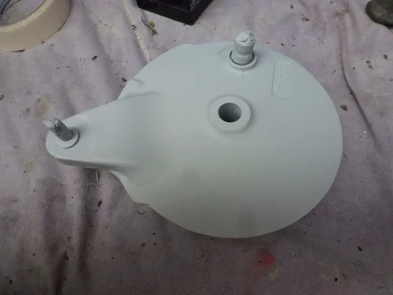

I had to cut off the alumimium boss off the brakeplate [ cable stop mount ] as it fouled on the frame axle plate.
All linished off, primered and finished in light Ivory to match the wheels - which should be back from powder coating next week.

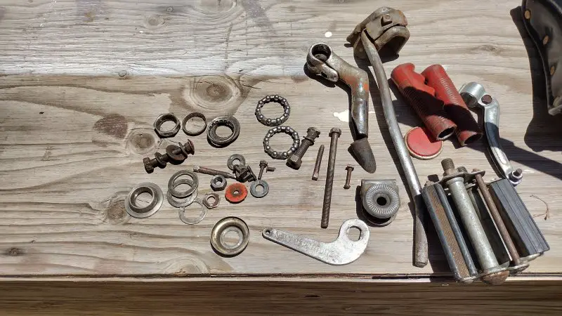

How many times have we built a project around that one iconic piece !!!!!!

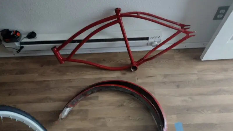

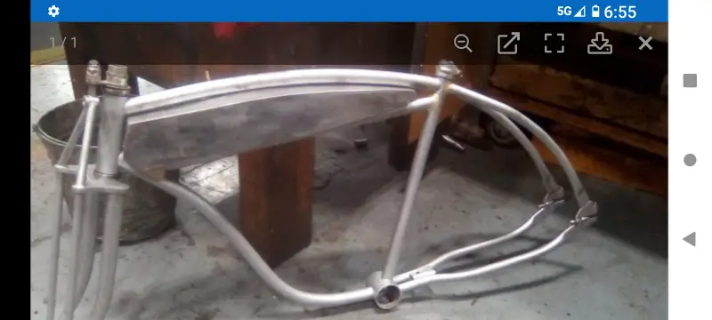

I have this Schwinn 'motorbike water transfer from the 50's both sides and have been looking for a long tank to put it on... And this is going to be perfect for it... There's another project with a double clamp stem and a set of Rupp mini bike bars... And another around a quad spring springer fork... And a 4th around a mongoose 6 bolt stem and matching chain ring... I'm just collecting parts at this point and by spring I should have a better idea of what I can do with it all and sort it out... I'm almost done renovating my place during the COVID lockdown... I always have to have something to keep me busy and it's been a few years since I had a motorized bicycle... My old shop was geared twords Mopar so when I moved I had to give it up and I enjoyed the bike more twords the end...

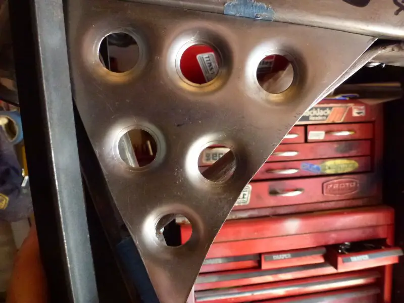

The Dimple Die project didn't work on the front headstock closer panels ..... metal too thick causing loads of distortion .......... back to the drawing board. They're only cosmetic, and my pal decided to put additional holes in which expose the inner braces etc. The new ones will only have 3 holes and probably be 1mm steel or 1.5mm alloy. The alloy ones would be glued in place.

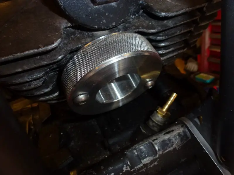

Collected the machined exhaust collars today - spot on. Exactly as they were in my mind !! See the knurled finish.

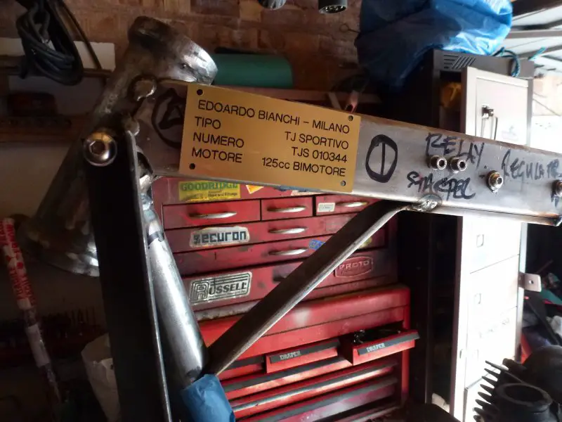

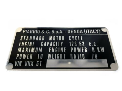

I also found a company that will make me a "proper" chassis plate - just waiting for details.
These are the style of chassis plates this guy makes.
He will do me a one off as "Edoardo Bianchi - Milano" and also incorporate the EB logo.
Dead chuffed to have found this guy.
i approached a couple of others who weren't interested.
Once he was assured that there was no copyright issue he agreed to do me a one off to my design. AND incorporate the old EB logo - all adds to the creditation of what is a Phantom !!
He will also do me a tag for the engine - which will just be the logo plus the original Virago engine number - that will confuse folk even more.
Less than £15 for the main plate and £4 for the engine tag.

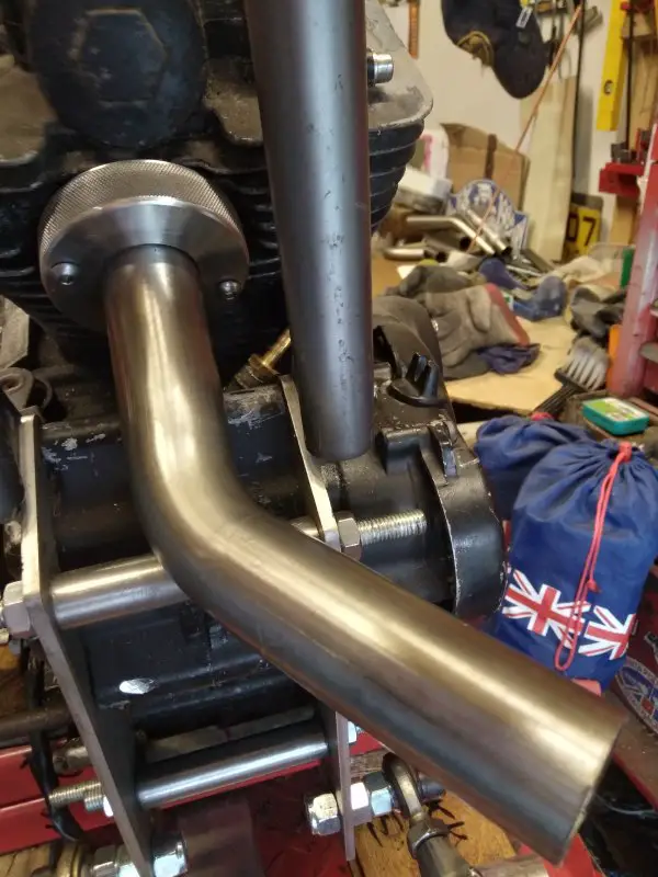

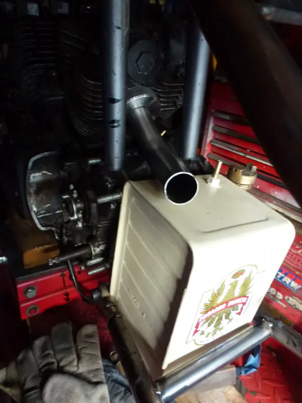

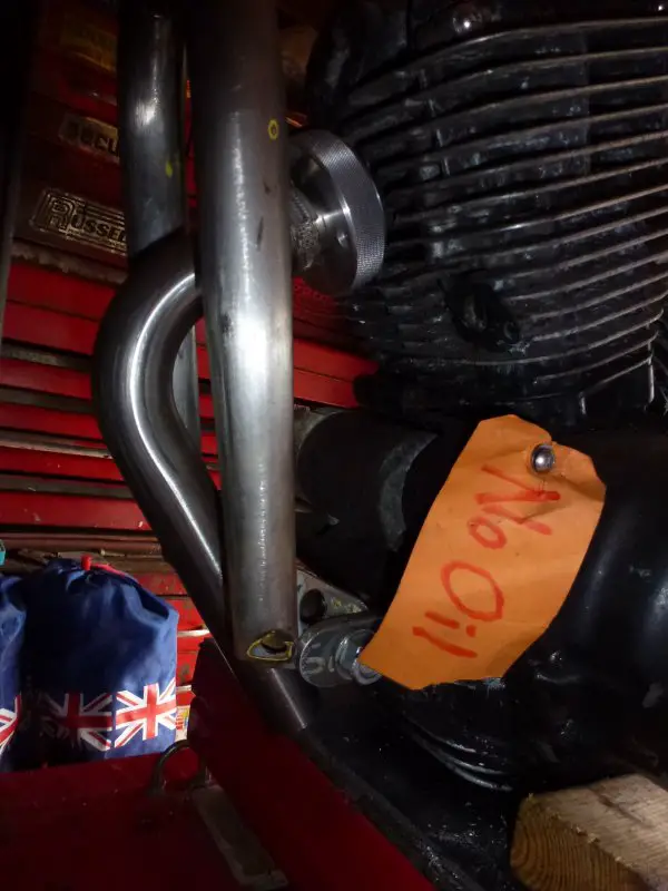

Finally got the headers mocked up in the new collars. Front is dead simple, a 90 degree stainless bend off the shelf cut to length.
The rear is doable now - clearing the fuel cell. I can't finalise the layout until the footrests etc are in place.

My machine shop guy is going to finish off my exhaust headers by welding a stainless [ pipe is stainless ] retaining collar. That will save me having to arrange another job down the line.
