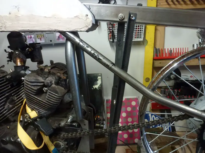

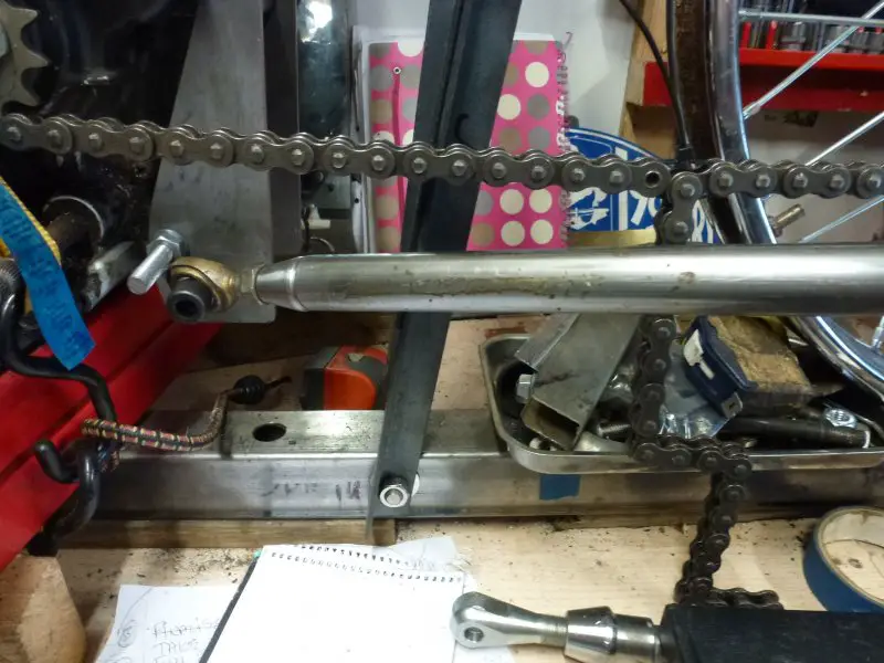

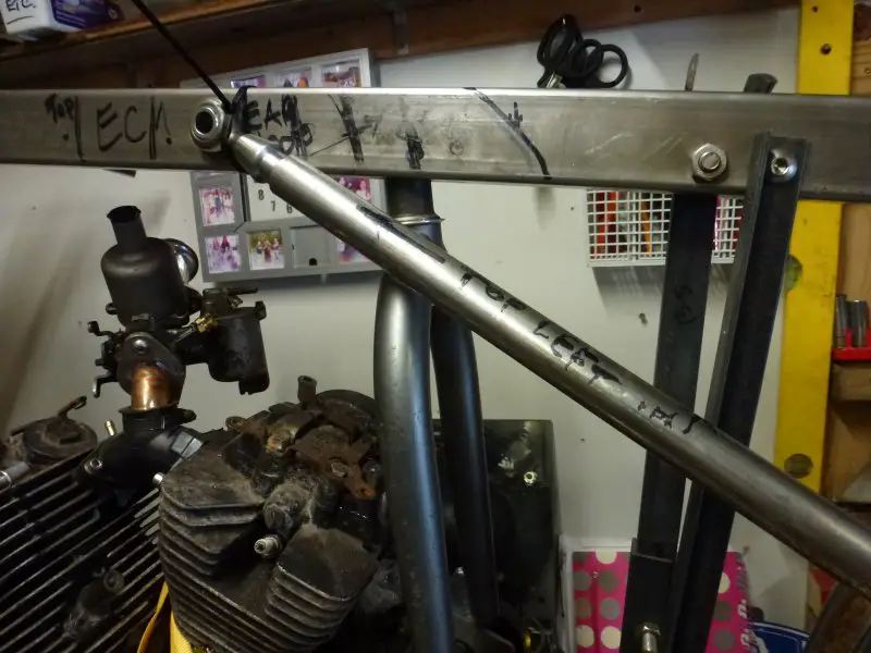

I had the weld bungs [ Rose joints ] turned down today to fit inside the rear frame tubes for the POC mock up.
Chain line is clear and everything lines up as I'd hoped. The top frame tube position isn't fixed yet, I had planned originally to place the top mountings at the rear of the top tube. I'll get the bottom rails finalised and then decide about the top.
Zip ties and masking tape ..... who needs a welder !!!!!

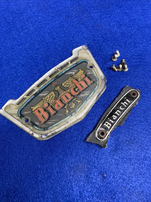

Found these on Ebay for £15.00
OEM Bianchi tank badge and the smaller piece from the OEM seat - back maybe.
Not sure where it's going at the moment, but the seat badge will be rivetted to my new saddle. I have some Lycett badges I was going to use ..... but hey, what's yet another Bianchi referrence !!

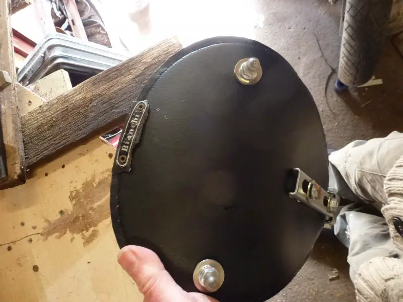

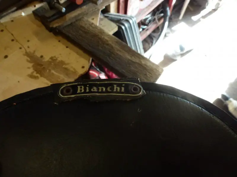

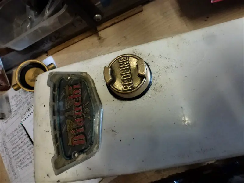

Hmmmm, not sure - nI think I'll try and find another and put them on 9ther side of the tank.
The saddle logo is however spot on !

The single tank badge [ originally side ] doesn't look right on top so i'll hold fire on that and see if I can get a second or even a pair to go on the tank sides.

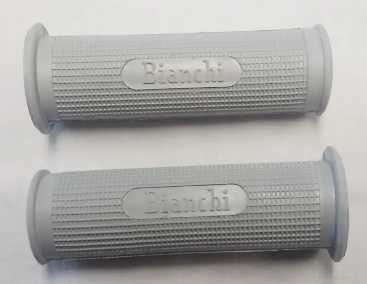

Think I'm getting more obsessed with this "Phantom" idea ......... just found these repro handlebar grips on Italian Ebay for 25 euros.

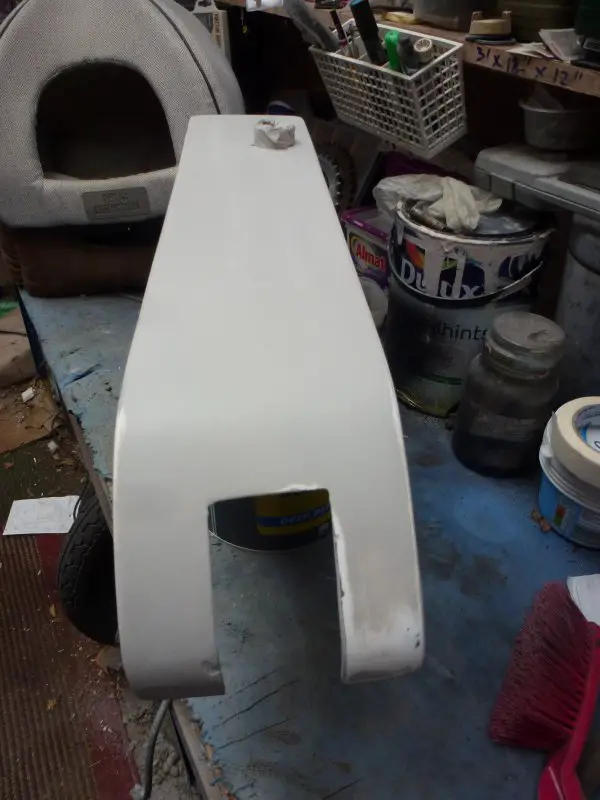

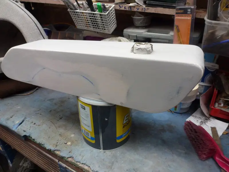

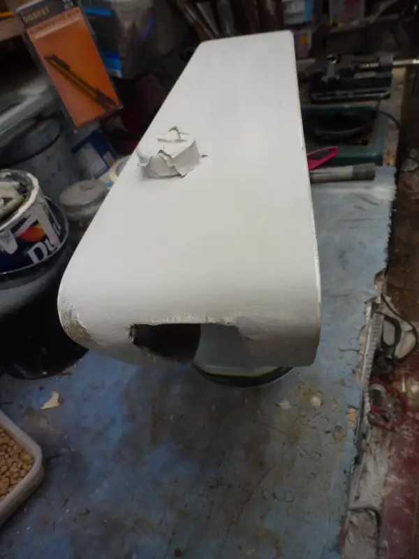

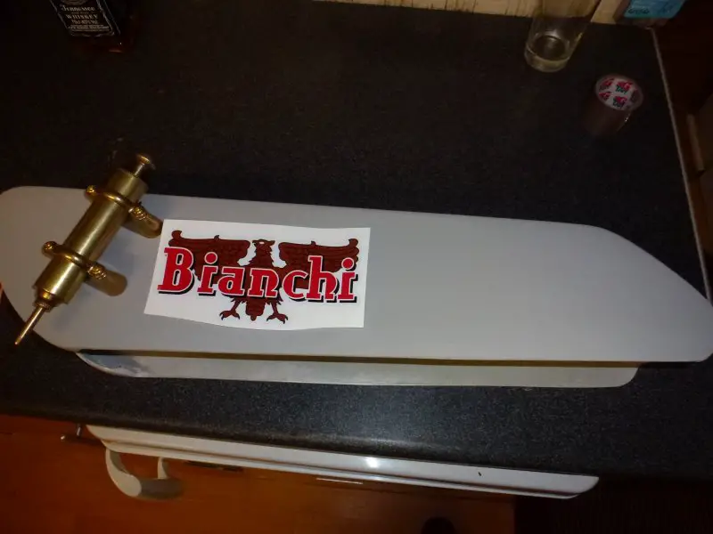

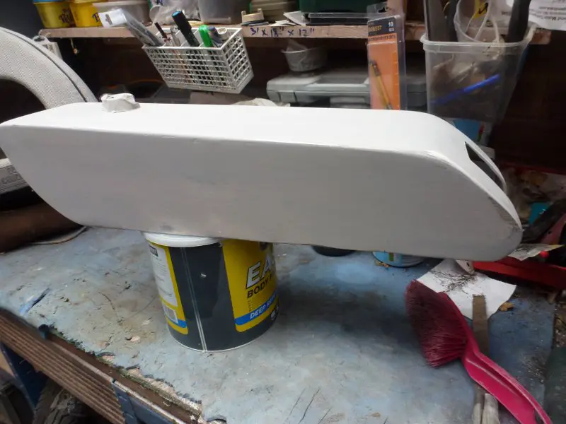

The "tank" is now finished ready for final primer and the Celeste Blue paint. The fuel cell is also in final primer now, but unsure whether to paint it Celeste or Light Ivory [ same as wheels / bars/ NOS bottle ].

Work in progress - the brass syringe is the crank breather collector and will be attached via some period rubber hose. Still not sure about the tank decals. The hand gearchange mechanism will go on the other side. I wanted to have it nickle plated ......... but for £50 !!!!! No thanks, it will be powder coated the same light ivory as the wheel rims and handlebars [ and Nitrous bottle tee, hee, hee. ]

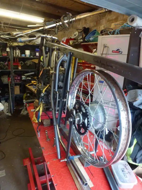

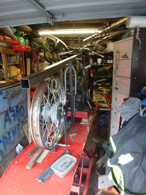

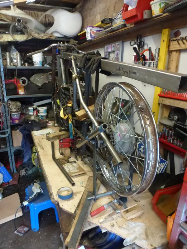

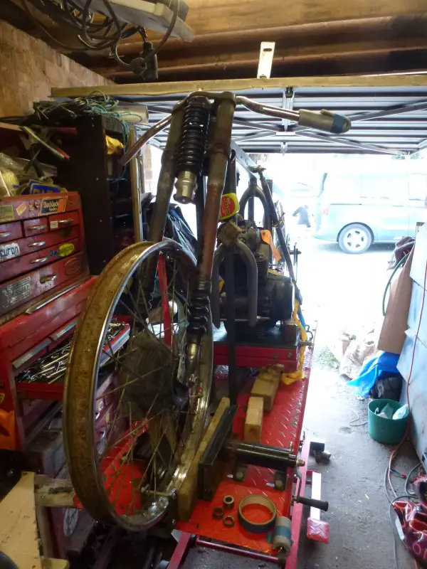

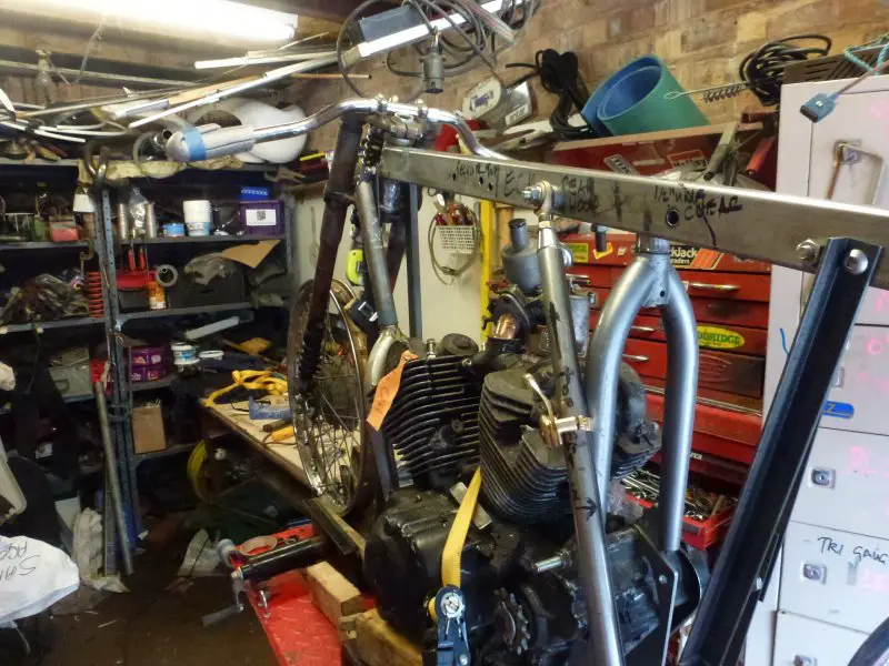

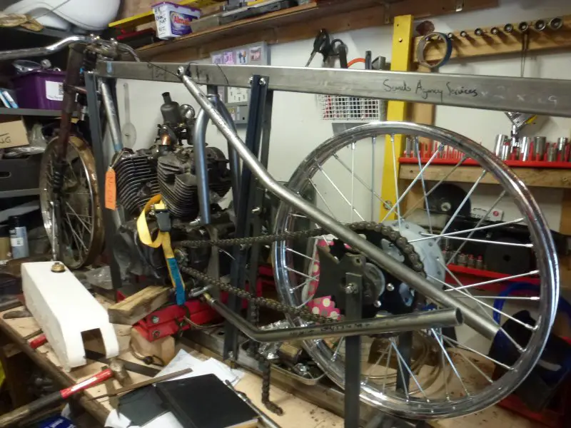

The welder is definitely coming at the end of the month so I decided to move the whole project onto my hydraulic ramp to make sure everything is properly aligned.
That meant the Glemseck bike had to come off first !
I got the ramp back to my garage this morning and moved the whole thing lock stock and barrel off the wooden bench and onto the ramp. Been at it all day - 6 hours - but well worth the effort as everything is now 100% aligned and bolted down solidly.
Had a few new ideas [ as you do ] and incorporated them into the reassembly.
I can now get round both sides of the project and it will make life simpler for my pal when he comes round to do the welding and easier for me !!

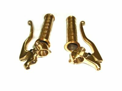

I was just about to bite the bullet on the £65 [ including carriage ] white Bianchi grips pictured above together with some decent heavy brass levers [ £58 ] when I spotted these from Enfield India.
£54 the set delivered !!!!
To Bianchi or not to Bianchi. Those brass grips and levers are indeed perfect for the price.

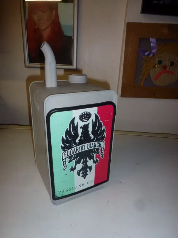

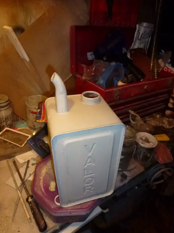

I'm now debating whether to leave off the two plaques I have for either side of the fuel cell / can. The can is marked "Valor", which was a paraffin company prevalent in the 50's / 60's. I doubt if many folks under the age of 65 will be aware of the origin.
Also still debating on Celeste Blue or Ivory for the can.

Myself, I'd leave them off and go with the can as it came. Name pressed in the can looks more authentic. I'm building my bikes for the people that know what they are looking at and those that don't will most likely judge them on the fact that they are just there and hopefully look nice.
Steve.
Steve.
Yes, that's pretty much the conclusion I reached .... nice to have some feedback on it though - thanx.

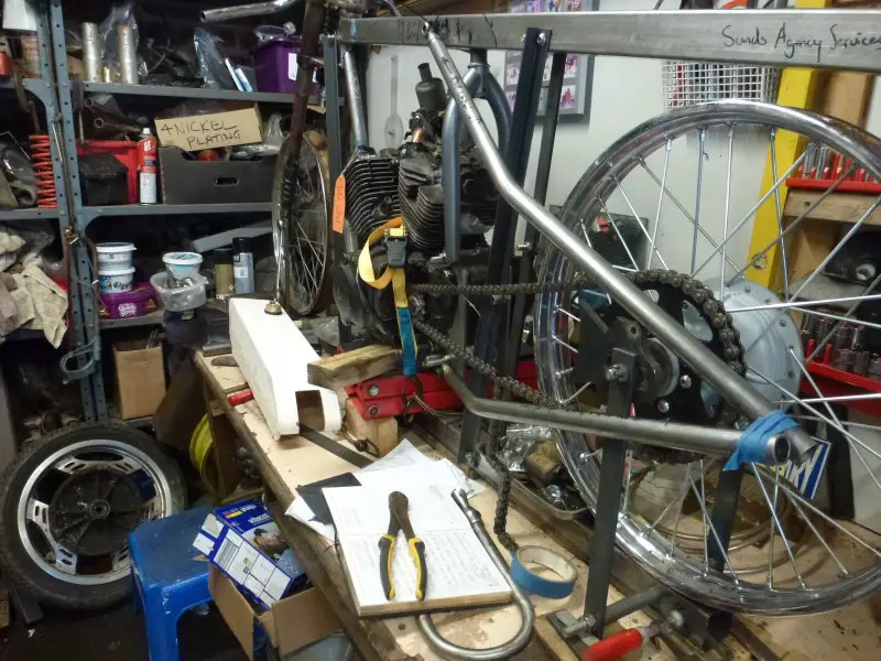

Weld day getting closer !!! Can't wait to fnally see the frame tacked up and supported by itself and I can take some of the jig fixings off.
Very heath Robinson - but effective, since I bolted the "jig" down to my bike ramp it's absolutely solid and I'm happy that everything is aligned [ laser checked ] and good to go.
There's not much I can work on until that's done, but I did work out a POC for the hand / foot gear change and I've sorted out all the various cranks and rods I need - all from my old stash of parts.

Undecided about the "tank" and Valor fuel cell - either Light Ivory - or Blue with Ivory panels.
