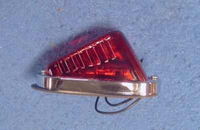

Tom has a source on some really neato looking tail light/turn sig lights...
Have you looked at the ones he used on his EZ rider stiletto?
rc

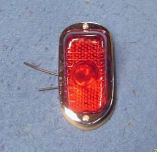

always a set of these
Vintage style rectangular tail light that would be great on a trike or a sidecar. Combination tail light and brake light comes with a 6V bulb that can be easily switched for a 12V bulb if needed. Lens is 1 1/2" X 3 1/2".
PM me if ya want more info
