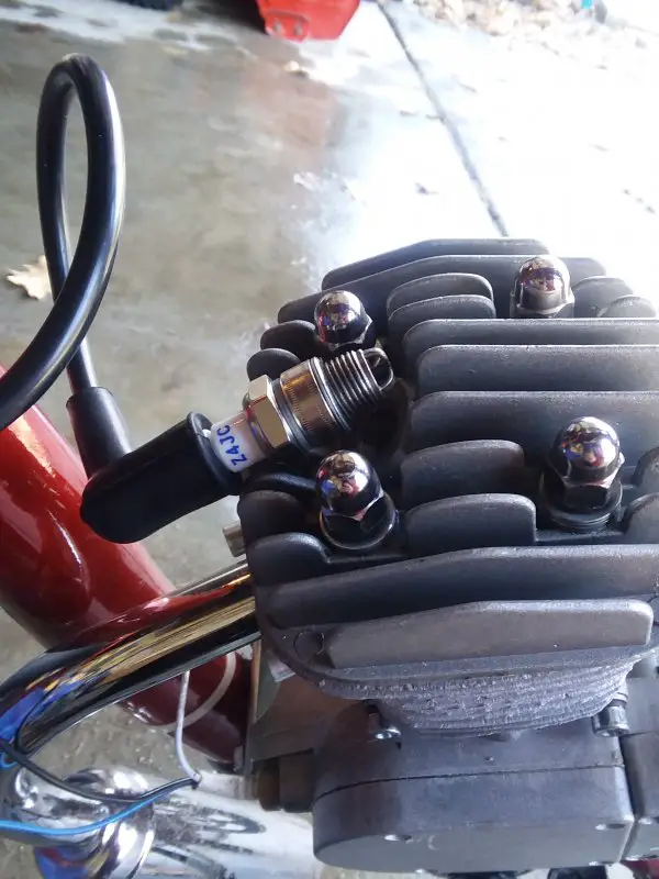

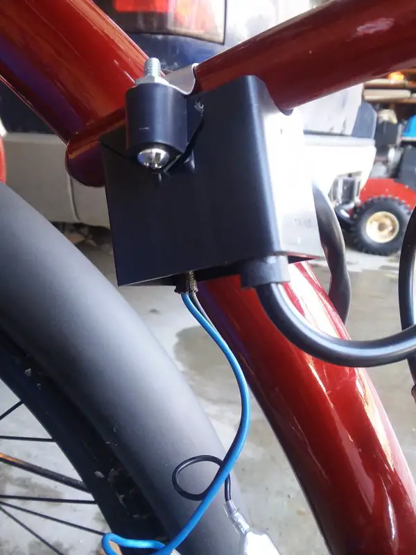

Hey I just noticed my CDI has a crack in it... could that be the reason ??
A crack in the housing doesn’t mean the cdi is bad, check to see if it still fires. Remove the spark plug, connect it to the cdi, lay the plug on the head and walk the bike with the clutch out. You should hear the engine turning over and see the spark.
So I laid the spark plug on the head unit still attached to the cdi and walked it around and I saw no sparks of any sort. I just don't get how things aren't working already after 1, 15 minute ride around. Errrgggg.

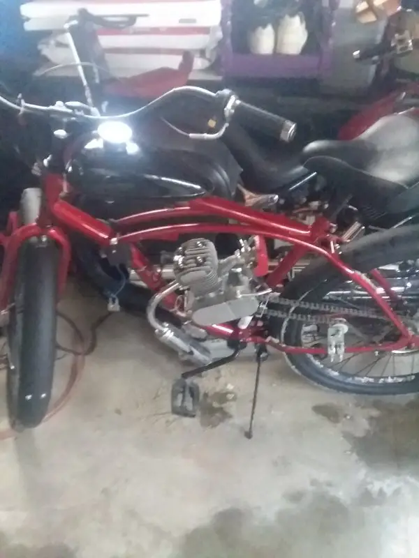

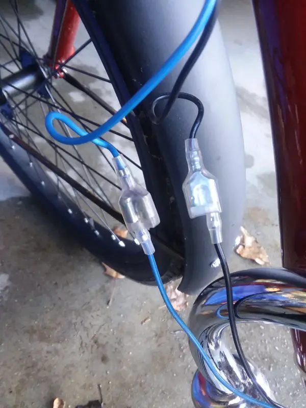

Here are some pictures . Have to resize my video I took of trying to start it.

Don’t give up yet, try a known good spark plug, any type will work to check for spark. Do you hear the piston cycling up and down when you are rolling the bike?
Yes ,I do hear the cylinder going up and down when I release the clutch to start it. Sounds like it's running, and then it shuts off real quick even if I try to give it throttle and mess with the clutch. That's basically what the video would show you.
Oh yeah sorry I misread what you said. I do hear the piston cycling when I'm pushing it around with the plug out. And I will get a new spark plug.
