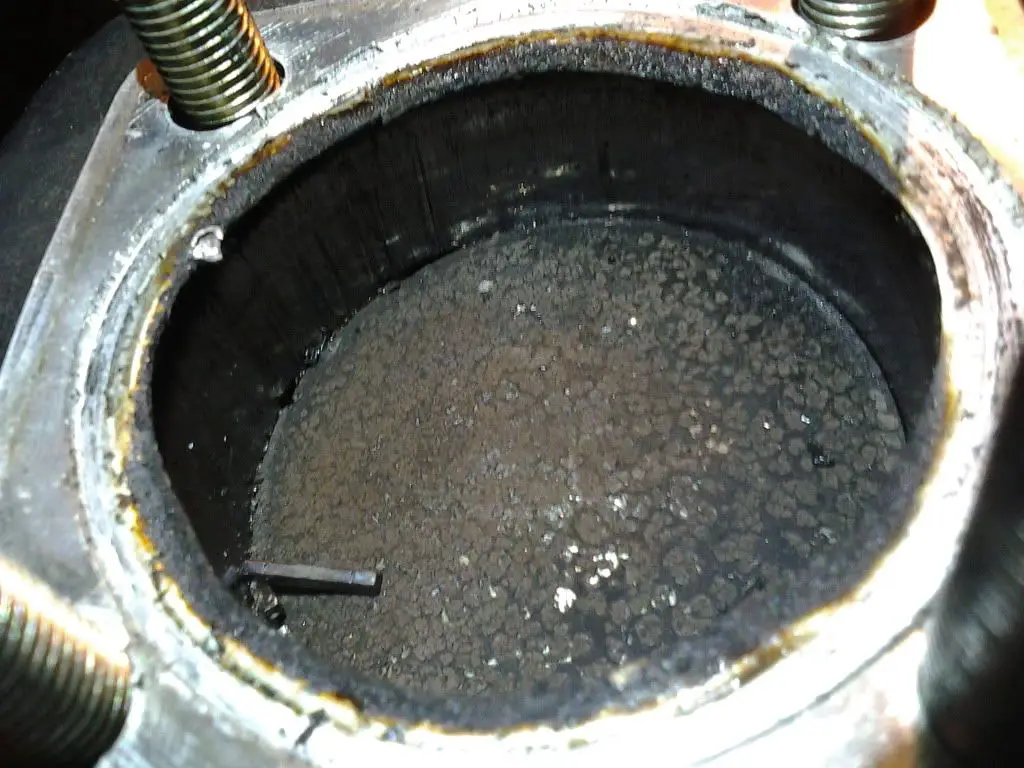

I think is was getting the same sound but wouldnt kno since we never got a vid or recording on it. I think the was from the pin that hold the piston rings cause my motor seized up a week later and here is wat it looks like when the head was pulled. notice the small hole punched thru the head gasket as well as wat i think is the pin that holds the rings. Going to take it apart to learn more. My sound was a very loud ping or tinging like sound coming from th top of the motor kand of sounded like a bell ringing. Didnt happen all the time but did make it a few seconds before it locked up. U can duplicate the sounds if u tap on the spark plug with a wrench. But notice that the spark plug was not hitting.

I wish more people could give definitive sound descriptions like what you gave - though I also wish your bike didn't seize!
So far we know you need a new top end, but I hope it's not much more serious.

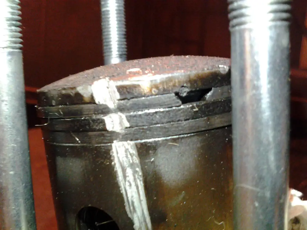

Thanks Gear but I didn't see anything but I finally got the jug off. I had to get a bigger hammer. But didnt find the piece that was jamming it up. I tried shaking the case nothing, but did notice that the cranck shaft moves side to side about 1/4". Will post pics shortly.

I had an engine do this very same thing, what caused mine was that one of the pin/needle bearing on the crankshaft broke and a piece of it made it up through the transfer port, it hung between the port and the piston as it was moving upwards in the cyclinder after it had been bouncing around on top of the piston for a short length of time, I knew this because it had put a bunch of dings in the top of the piston before it hung between the piston & port, it knocked a chunk out of the jug and tore down the side of my piston and looked just like yours looks, new piston, jug, rings, gaskets, different crankshaft, new upper wristpin bearing, I had it running again and it was my strongest engine until last week when the crankshaft shifted toward the clutch side of the engine and caused my mag rotor to eat into the block and crank seal and kill this engine once again..........420 miles later
My advise is go through that engine with a fine tooth comb so to speak and make sure that lowerend is perfect before you even consider a rebuild, if the crank and rod bearing has any play in it or looks suspect, I suggest making it a parts engines for the gears, block, clutch parts, head. and then just buy a new engine from BGF/Luckyearlybird for about $78 and be done with the cooked one, you cant rebuild that old engine for $78 when you figure the time and trouble involved.

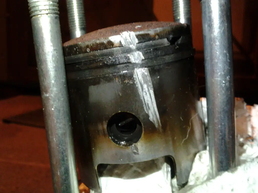

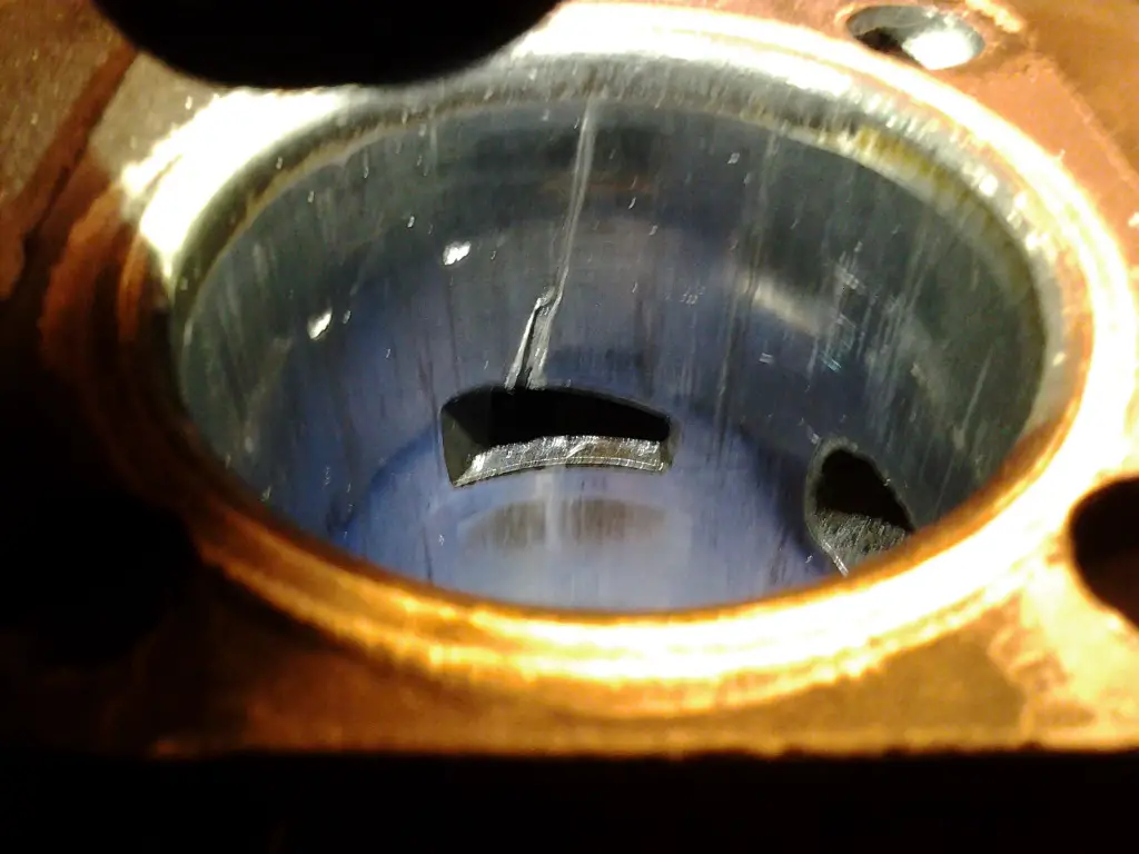

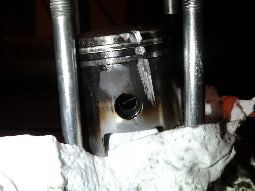

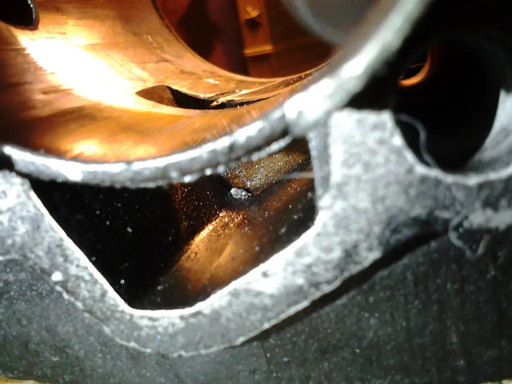

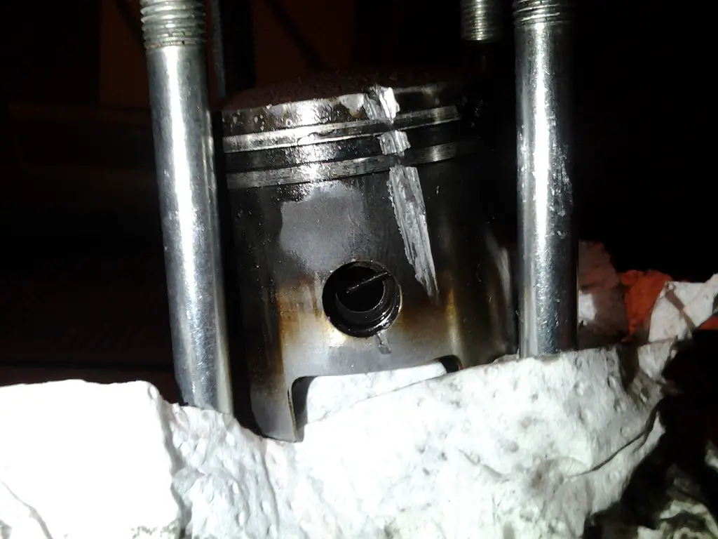

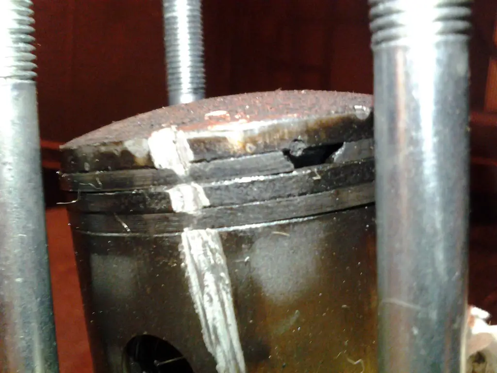

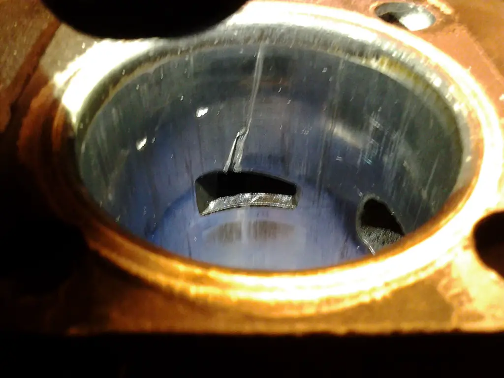

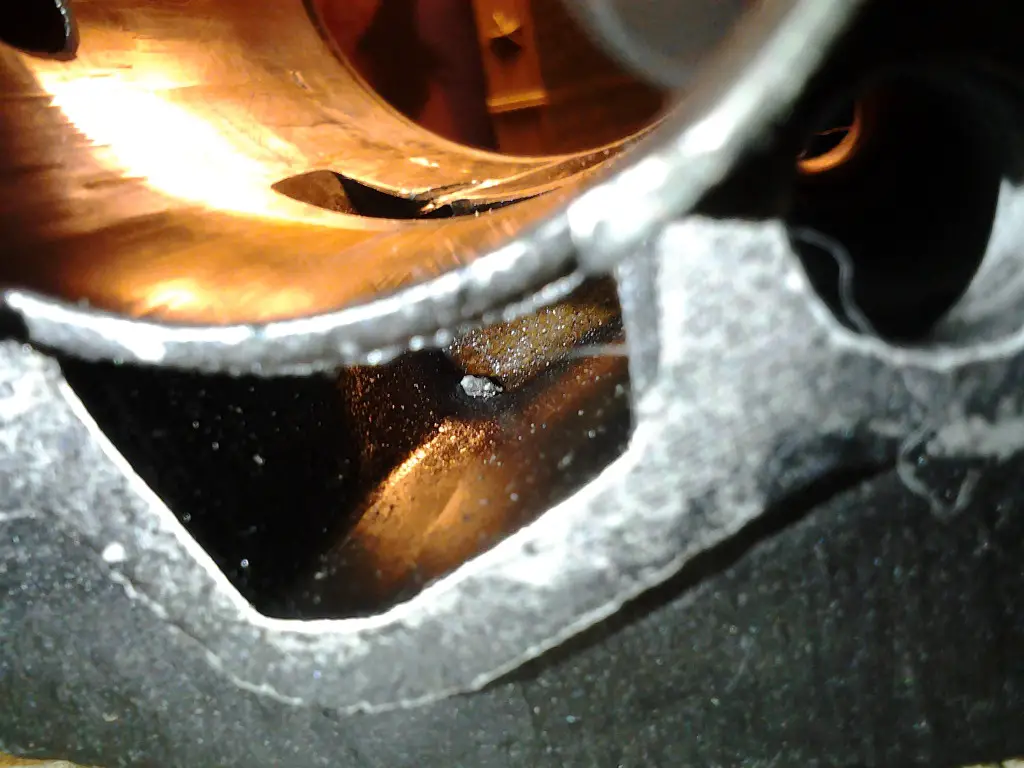

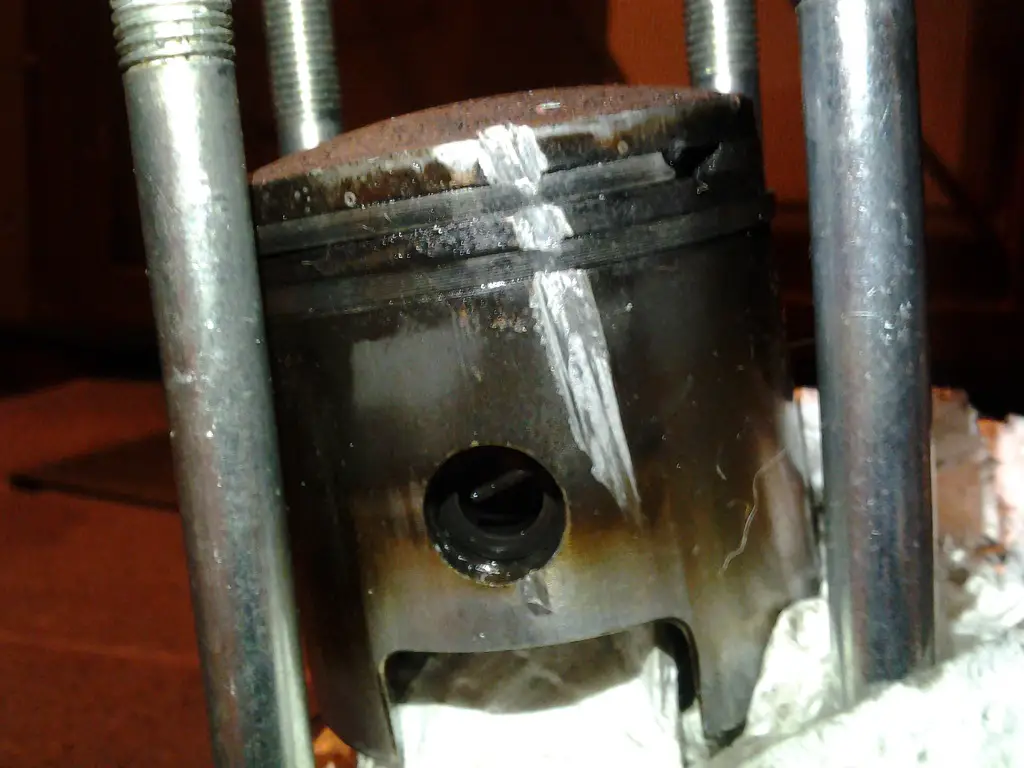

Heres the Pics not the best but I tried if you need more or diff angles let me know.
View attachment 36136 View attachment 36137 View attachment 36138 View attachment 36139 View attachment 36140

That pin on top the piston looks like a roller from the rod bearing. If your rod has that much sideplay, it's prolly from the lower rod bearing.
GearNut
Aug 19, 2009
5,102
11
38
San Diego, Kaliforgnia
I agree with the bearing failure assessment. Unfortunately the bearings used in these engines are not the best out there, and no matter what type of lubricant was used, certain types of failures are unavoidable. Gotta love the Chinese quality control! :rolleyes:

thank a lot guys the assesment of the rod bearing make sense since i was hearing a load pinging before it seized up. i will ue it as a parts motor now
