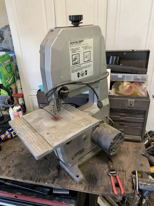

Got that little ryobi bandsaw. Will see how it cuts later. Got a wood blade that’s prob ok for aluminum too. Thinkin where to put it. I have 3-4 tools I would mount on a solid surface now, may be time for a new table/cart build.

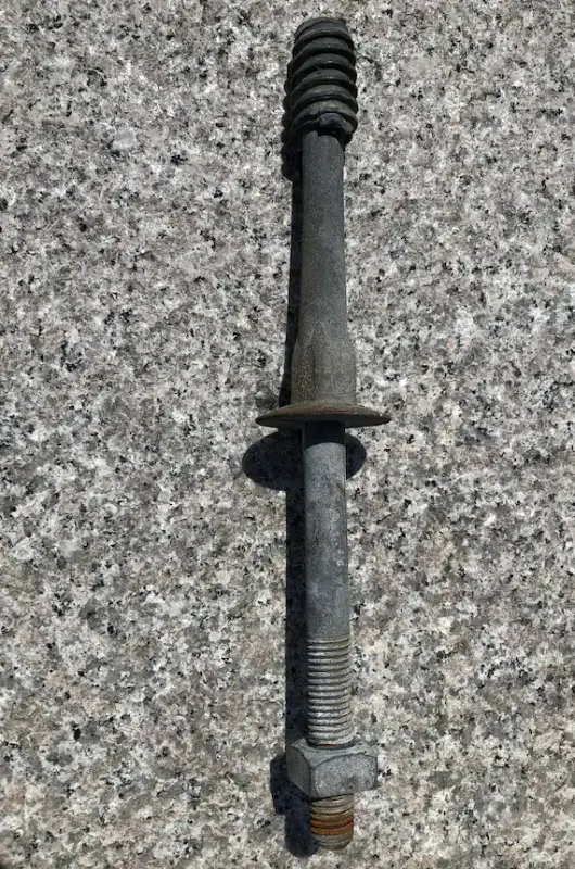

This project began last year, and seemed simple enough at the outset. Buddy has collected telegraph insulators for ever. Table mount display is the requirement. The insulators are a three piece affair, the glass insulator, wooden intermediate called a cob, and the steel mount to a cross bar.
The crossbar mounting (bolt) has what looks like a 5/8" wood screw to mate with the wooden cob and about a inch of unthreaded 1/2" terminating in a round head flange. Other side of the flange is the draw bolt fitted in a telegraph pole cross bar. The draw bolt bit is to be replaced with a short 1/2-13 stub.
I hit the wall so to speak being able to grip the round between the flange and cob mount threads of insulator post they call them.

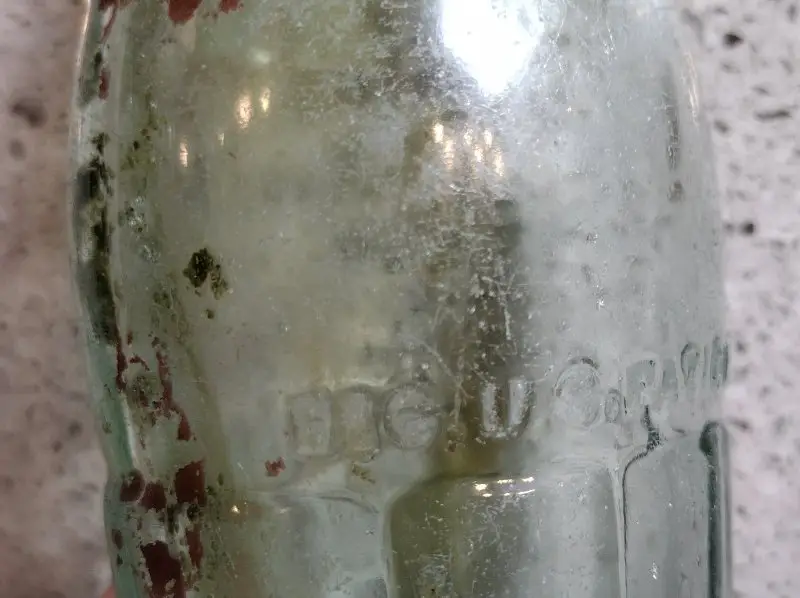

Below is an inquiry to what may be an old Coca-Cola bottle I found that was uncapped and under the river where I was scuba diving.
I found it on the river bed filled with silt and other growth of red and green stuff on inside and out of the glass.
"I found a Coca-Cola 12 oz bottle recently, that I wish to be able to figure the date of manufacture.
The bottom of the bottle has some numbers and letters in the glass molding.
Other than that the bottle does says REG US PAT OFF.
Though I do not see where a picture of the bottle and codes are, the bottle bottom code looks like:
8D O 60 with another 0 underneath that string of number/letters.
Thanks"
Coca-Cola's reply back unfortunately mention stuff about where on bottle or if can and carton, a best by use date for their product. They said if I wanted to contact them again I can.
I may do this, an also specify that I am curious not about best by use date, but the bottle maybe being a collector’s item that it is maybe over 50 years from manufacture date.
I attached pictures attached of the bottle after cleaning some for you to see. Their was no way initially to contact them and attach the pictures I took.
The webpage for Coca-Cola does have pictures of the patented shape of their bottles from 1899 to 1957 for 6 bottles shown.
Only there is nothing that mentions the codes on the bottom of the bottle that I would hope would determine the actual age of the bottle manufacture, or their abouts.
Any thoughts, besides just contacting Coca-Cola again?
I do understand that if Coca-Cola bottle is even from 1960's era, it is not worth very much, if I believe what Ebay sellers are asking for them. Something about late 1800's manufacture date would be more likely.
$600,000 is what one was sold at auction for some old bottle, but I can at-least identify the shape that was the last patent, just don't have more than that at this moment.
MT

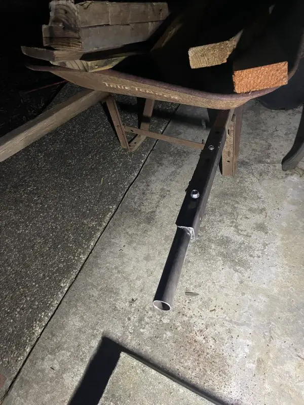

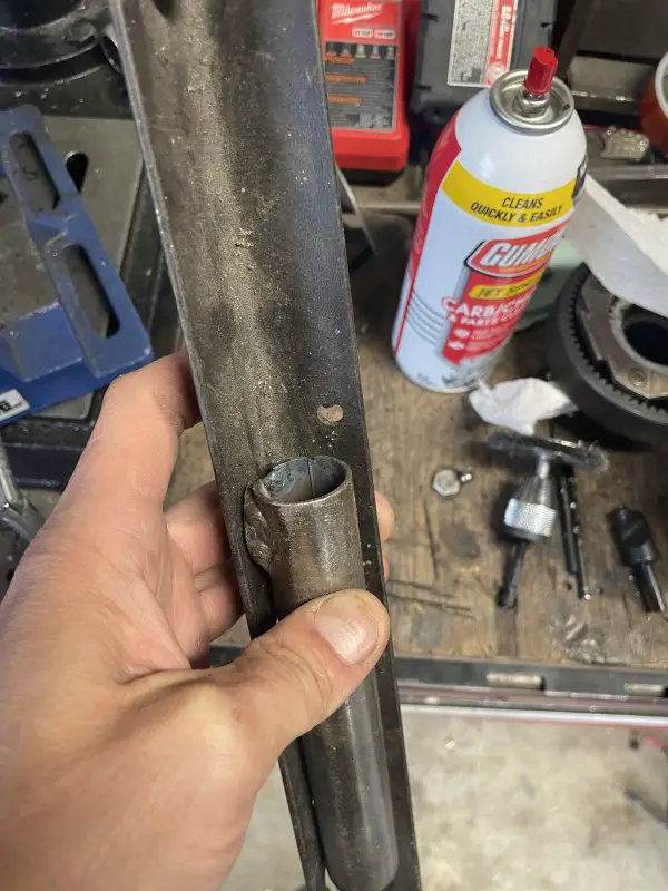

Not quite machine tools or a shop but saved myself $22. Broke the wheelbarrow handle with my car and bought a replacement. The new one is much larger and would have to have the strong side horizontal. Also I’d have to take apart the whole thing to fix.
The right way woulda been to buy two so it looked and felt right. But I didn’t wanna spend almost $50 on this POS.
Decided to fab up a bolt on handle.
Found the perfect piece of scrap with its previous mistakes. And a scrap chinesium angle from some old bed frame.
Cut the angle, heated with map gas to loosen the paint on it, wire brushed until metal was clean, welded it up and bolted it in.
Way easier and faster I think than taking all the crap out the wheelbarrow, taking it apart, blah blah. Now to go and get my $22 back.
That’s two projects for the day off so far, got more but I’m running out of “spoons” fast.
