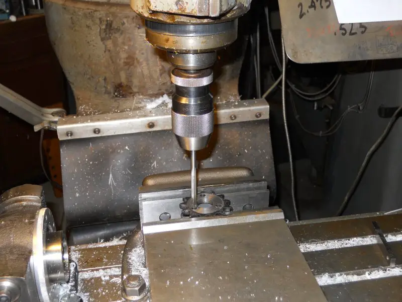

Latest progress in upgrading my Sportsman Flyer Reduction Drive and Pat please indulge an Old Fart.
Something to take note of.
Quality steel chain sprockets made by Martin and marketed by Motion Industries are very high quality.
And Motion, is now my go to source these days
My mistake and this is worth noting. I ordered a
13B40 and it was hub'd which I turned off in my Logan.
I then ordered a 35B42 input sprocket and it had a 1/2" wide hub too and welded on.
I am loath to turn that hub off and find the sprocket had potato chipped from released stress.
With a little effort cause I ain't never been here before.
Hubless sprockets are "A"s So an 35A42 is on order.
The photo is the 13B40 drilled and reamed to the hole pattern of the Reduction Drive.
Photo.
13B41 and it was hub'd which I turned off in my Logan.
With a little effort cause I ain't never been here before. Hubless sprockets are "A"s So an 35A42 is on order.
The photo is the 13B41 drilled and reamed to the hole pattern of the Reduction Drive.

Next comes countersinking for 1/4-28 flathead Torx drive screws. Pat uses 1 /4-28 Low heads which have pretty good grip, but if I recall only have 1/8 Allen Hex drive. The flat heads as we all know hold more firmly the object it is captivating.. Flat heads also because of the greater head contact resist release. I am living empirical evidence of the pain of getting flat heads to release. Today several elements of the weld fixture I have been building (not my design), assembled with 5/16-18 flat heads needs to come apart for modification. Normally it takes a specialty punch to break the friction of a flat head. But all new tooling I didn't want to bugger the screw heads. I didn't Candy Cane the Allen Wrench but that may be because their physical strength is better than twenty years or more ago.
Sorry for the song and dance.
But flat head with torx drive is where I am going.
Hope the full image works for you Steve. No great revelations, but Y'all like pictures as well as I.
