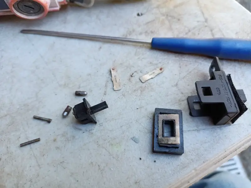

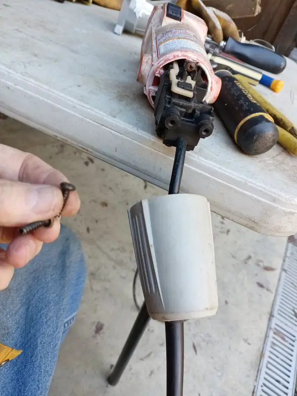

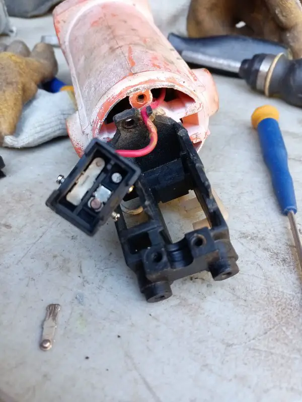

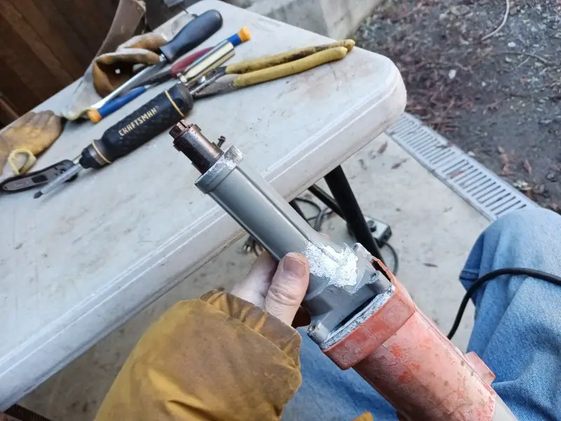

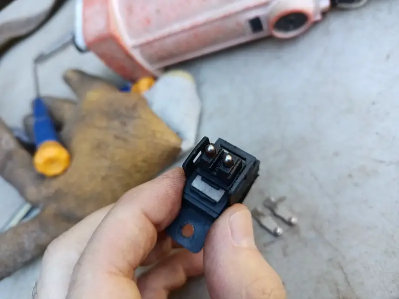

My HF Die Grinder I wanted to use to get a bracket made for my motorbike. The bin it was in had quite a bit of moisture in it, just not drenched completely. So, a lot of other electrical tools in the same bin are possibly going to need some attention or replacement. Being head strong I took the grinder apart. The contact points on the switch had some burn spots which I scraped clean and put all back together. The design of the switch is crappy. Right from new purchase it was not long before I could tell what you need to do to turn on the tool, is to push slide switch to on fully and then back off slightly.
There are these very small long coil springs that push on metal cylinder pointed tips, they are for the teeter totter contact strips for hot and neutral contacts.
It is just that the slide which get the detent by moving the pressure exerted when just past the fulcrum become less pressure as it moves away from the fulcrum. So, backing off from fully switched to on, is what really turns the motor on.
It is the same still the same funky switch, so I got it back to square. Easy to not find the tiny springs that may fall off the table.
I now have my bike back running great. Just checking out the weather to see if camping trail riding can be done soon.
