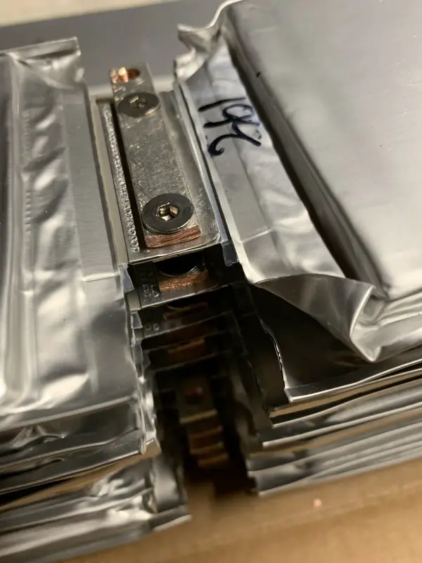

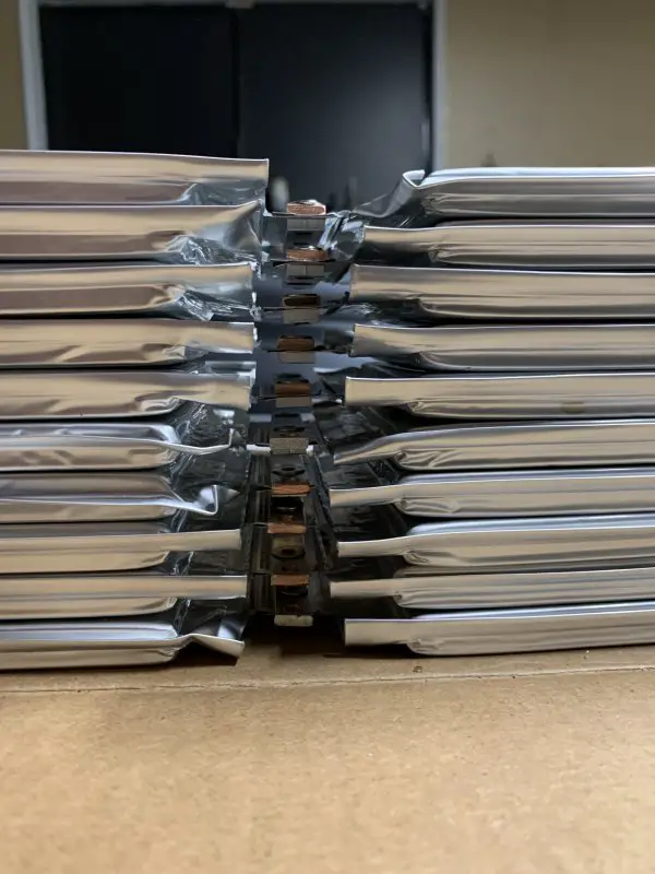

Home “shop” isn’t much of a shop but my drill press got a big upgrade. I was building this battery that had to be super slim and needed bus bars with threads in them to thread in the bolts and keep everything well under the cell thickness of .460”, keeping enough space for insulation. So I had to drill and tap 40 holes. I was like no way I’m doing this by hand...

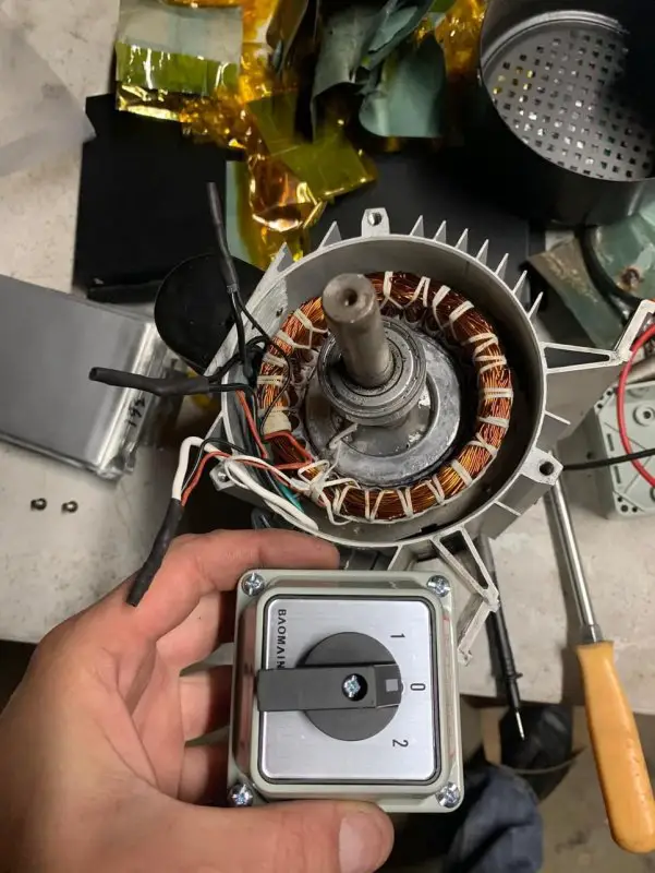

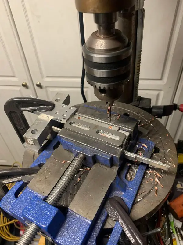

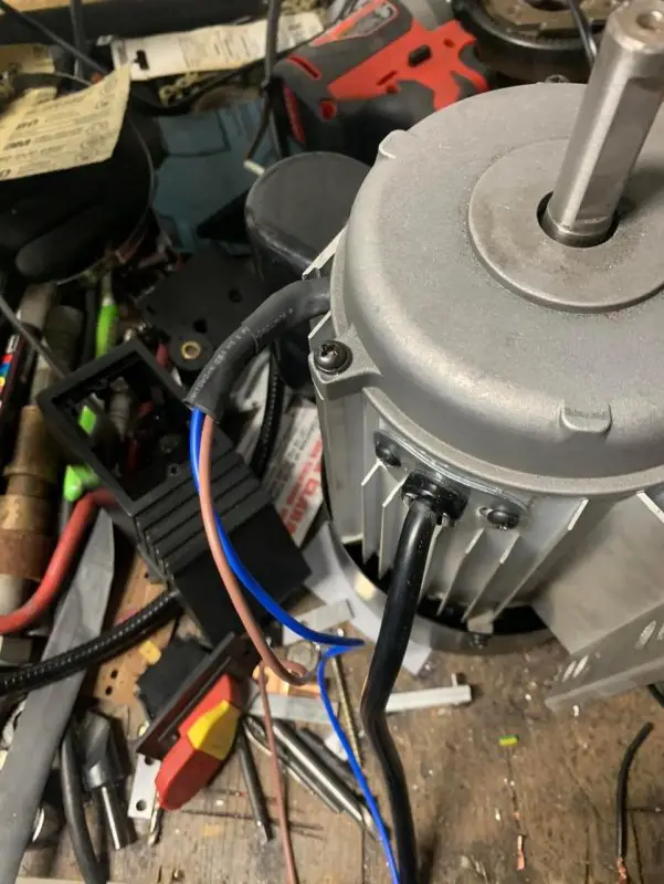

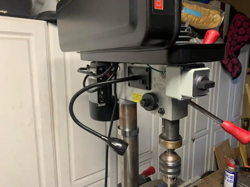

So I wired in a reverse on my drill press. I shoulda put it on a foot switch instead but made it like a mill for now. It was pretty easy. The motor has two phases 90* out with one offset electrically by a capacitor. Switching direction is simply changing which phase gets the capacitor. I got this switch off Amazon for $15 and had to cut a hole in the side of the motor case for the two sets of input and output wires. It worked out! Now I can power tap at 3000 rpm although controlling it is difficult above around 1500rpm. I did all the holes with a stubby and form tap to avoid the spot step. The drill press isn’t that great, the table deflects a bit but I just put a reversed clamp under. A typical “setup” is shown.
Having the reverse is an absolute game changer. Woulda had to do it with a hand drill or not at all. The extra hole on those bars is for the balance wire with the .100” tall button head. I wonder what the biggest tap I can run. Except for the individual tools I bought I only have some crappy China tap sets which are supposed to be cut taps but they do about 50/50 of forming and cutting as they’re not very sharp and don’t have much relief for chips. Probably gonna buy up to 1/4 in form taps and go cut for anything bigger. This thing really isn’t that strong.

Hi Tony good to see a post from you. That press is greatly improved for your needs building batteries but would be an advantage in a lot of special setups in a drill press.
I need a new table top press and a quick reverse feature would be nice, as would varible speed, but with no gear or belt changes necessary. Also an adjustable quill stop to prevent full rebound (not for depth limits).

Wowww blast from the past. Yea I did thousands with one at my first shop job. However the switch worked out for $15 and a few hours of my time. On some motors the secondary coil tap is buried in the windings. I dunno what I would have done in that case.

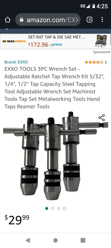

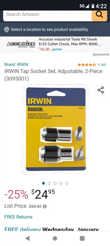

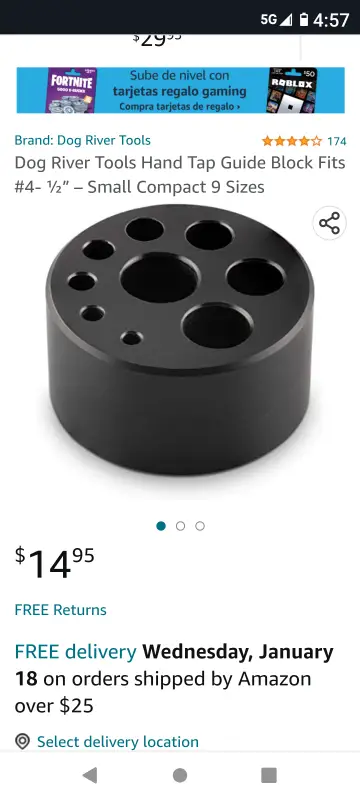

This is the package I'm putting together .. might like the Irwin adapter with a cordless drill
