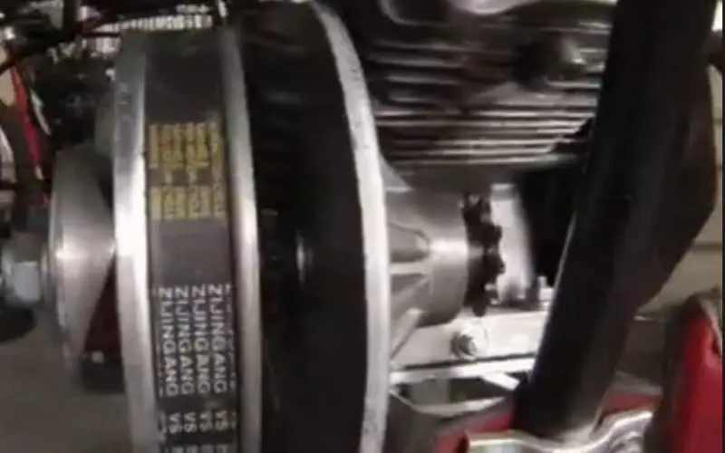

I just thought of something concerning the Comet CVT which can be bought off of Ebay and other distributors. The Comet and
most of the CVTs I have looked at are ok BUT, the 5/8" shaft is too short and they are mostly made for gokarts and minibikes
since the sprocket on them is mounted next to the driven pulley. I have a picture I took to send to a fella at PowerSports since
he was interested in what I was trying to tell him on the phone about chain/sprocket placement was different on the motorized
bicycle CVT.
Dennis

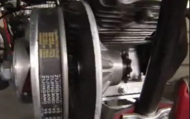

bicycle CVT.
Dennis
It amazes me they haven’t come up with a smaller CVT for 5/8" shaft, with all the motor bike and mini bike out there now. Chine made one for pocket bike are junk, but are small, ( have 2 setting on the shelf ). Took one apart and is so corked were the drum mounts to the shaft, and its still setting that way, never tried mounting it. Its like the shaft threads are wrong and the drum warbles, did buy a new drum thinking it was bad, it to wobbled.
So what you are saying the sprocket is to close to the seat tube? .......Curt
