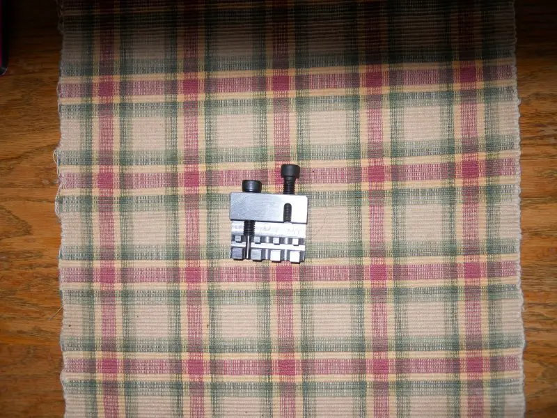

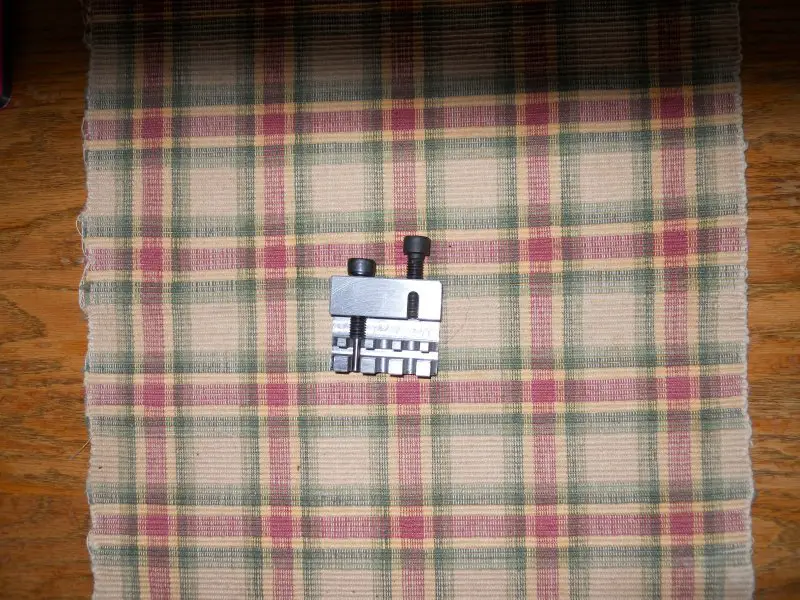

Dennis, I hear ya on the 415 chain. I never knew chain to stretch like that, hard to believe the pins don't fall out.
So when I put the Diamond chain on my Flyer the made in China #41 will go on my Huffy.
It will be a few days before I test this breaker / maker out.
But if it doesn't pass muster, I have plenty of 4140 prehard and a $24 pattern to reverse engineer.
But in the mean time, today after work I preset the height on two miniature Tool Makers jacks that fit in the countersink pockets and set up, touched off a .064" arbor slitting saw, and calculated exact centerline to split the fork clamps that will support the front fender struts.

That breaker looks excellent! I use a master-link so no need have the tool press connection. The 25 dollar one that has extra tip included looks like a fly wheel puller with two jaws and the twist handle. Pumpkin and hops to harvest. Some smart deer opened a gate to the deer fenced garden. There was no regular latch, just some hooks. I tide a rope and should be OK now. Their mouths just could only gnaw just a slight tangent off the pumpkin as it is too big for them, so no biggie. Orange tree behind more of the all containers in a half wine barrel the deer did not get to. The sharp thorns they can probably not even notice as I see then in the wild blackberries that have thorns. Time to bring Orange tree inside or move to warmer temperate local. Welded pin hole in muffler on pickup, looks awful I know. The material must be quite thick and the Hobart 130 may have done better if I removed the muffler. Then I would have had a better angle. Eliminating an extension cord as a short distance to the overhead power coming to the circuit breaker box and right to a wall outlet would have been best. It has no load bearing just keep gases going to the tail pipe so it is done.

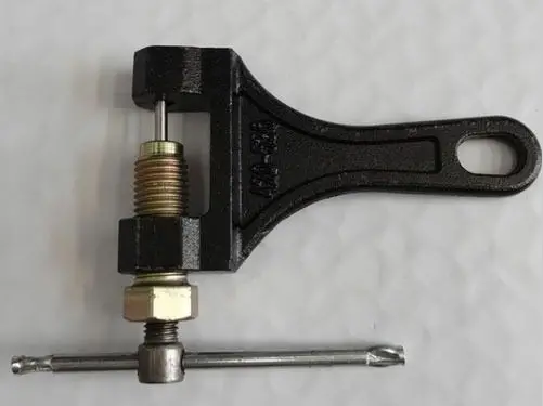

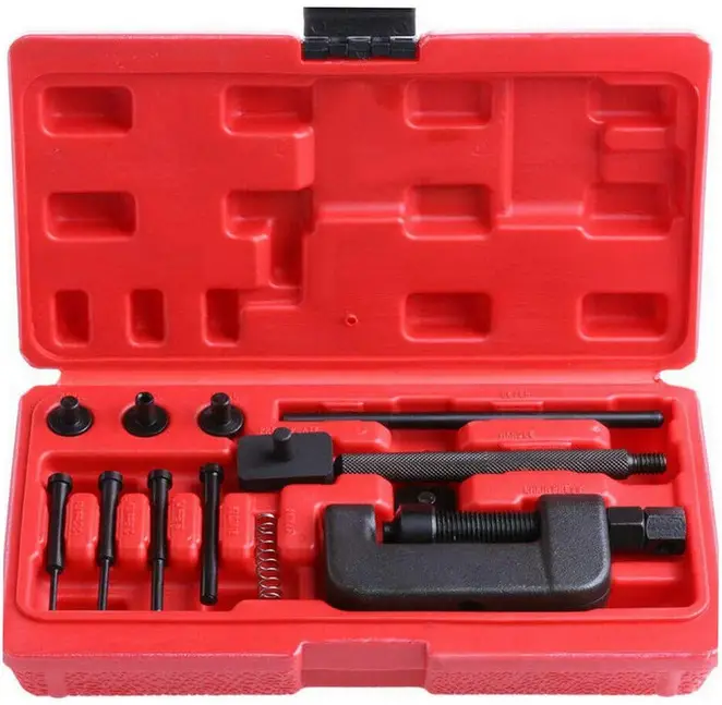

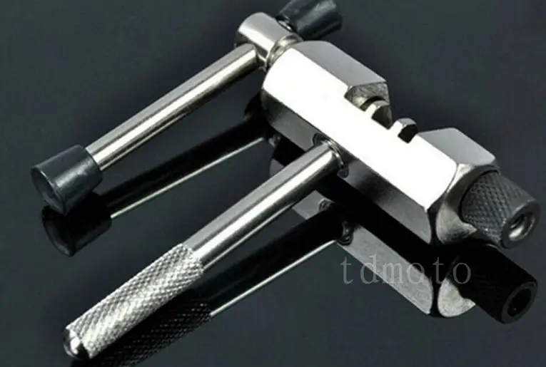

I bought 2 different chain breakers and they will work on the 415 chains. I have pictures of what
I have used and the two I have will not press out the pins on a 41 chain. The 41 chain is industrial
pre-stretched chain which is hardened steal chain. Using the first chain breaker I bent the pin
slightly on the breaker and was able to straighten it, when I tried using it on a 415 chain. I used
a grinder to grind down the pins on that chain and the cheap breaker worked ok. I bought the last
breaker kit and it worked on on 415 chain without grinding down the pins on the chain. When I
tried using it on the 41 chain I could see it would never press a pin out of a link of that chain
without bending the press pin. The last chain breaker kit I bought from GasBike and it was fairly
expensive and came with two rolls of 415 chain. I have never tried the (2nd picture) chain
breaker but I doubt that it would press out a pin on a 41 chain but would be ok as long as the
pins were ground down before using it. The cheap chain breaker in the first picture works ok
on a 41 chain as long as you grind the pins off before using it.
I've got several lengths of 415 chain and I will not use that chain on a motorized bike since it
is made of soft metal and will break and stretch. The last time I used 415 chain on a 212cc
engine it broke a link on the chain. The chain is ok on the little 49cc 4-stroke engines and
the 2-stroke engines. You will be constantly tightening the chain since it is always stretching.
A spring loader idler will help keep the slack out of the 415 chain but eventually the chain
will break or have to be replaced. You want a chain that will last and not stretch buy the
industrial 41 chain.

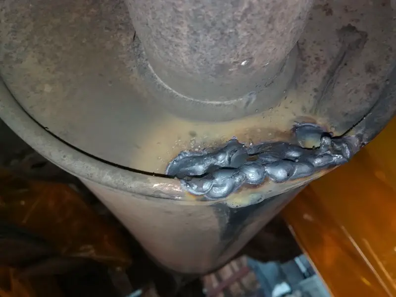

Welding on the muffler wasn't bad and I've done that several times. The rust usually starts
where exhaust condensation sits from starting and shutting down a engine. The mufflers
are usually galvanized plated and many have a small drain hole for the condensation to
escape. Welding on them burns away the galvanized coating on the inside and outside of
the muffler causing it to rust later on. That is why the shells are crimped together and it's
a never ending job keeping them working.

With engine running on pickup truck that weep-hole as I now know was there for a reason, had some gases come out. I guess there is no distinction between water exit and gasses exiting. So maybe it widened from rust? Anyhow another time I will get an 1/8 inch drill and put one back there again.
MT, I seen you welded the weep hole shut.:)
Me;
Dennis this new chain breaker looks like nothing would stop it but my new $68 10ft Diamond chain package has instructions recommend grinding off one pin end. To reassemble a chain without a Master link for safety sake would require restaking the inserted pin. I played around with that trick. It would require a made for the job punch and anvil staking tooling. When my Diamond chain arrived it had a Master link I'm using it.
