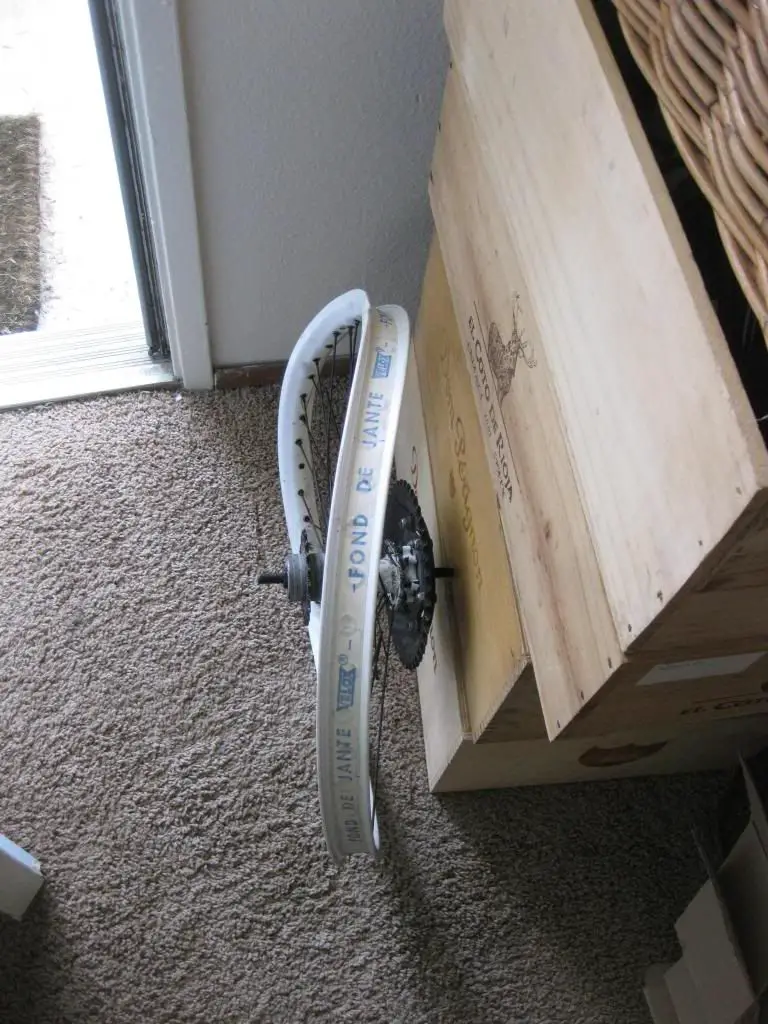

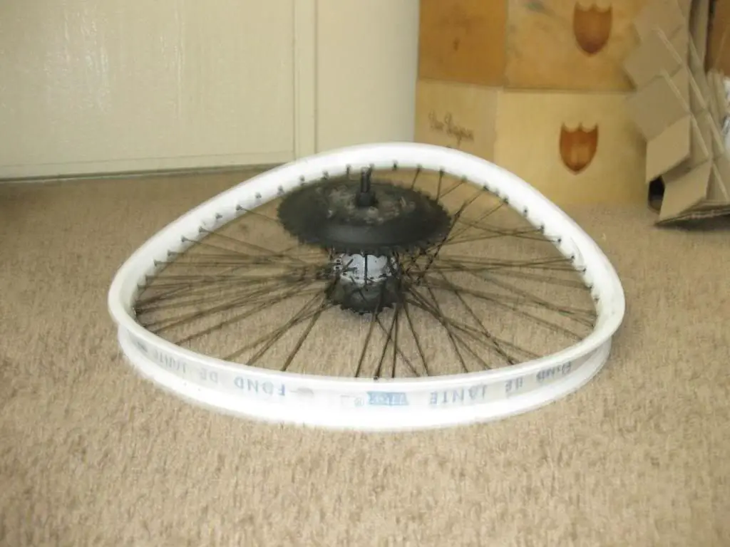

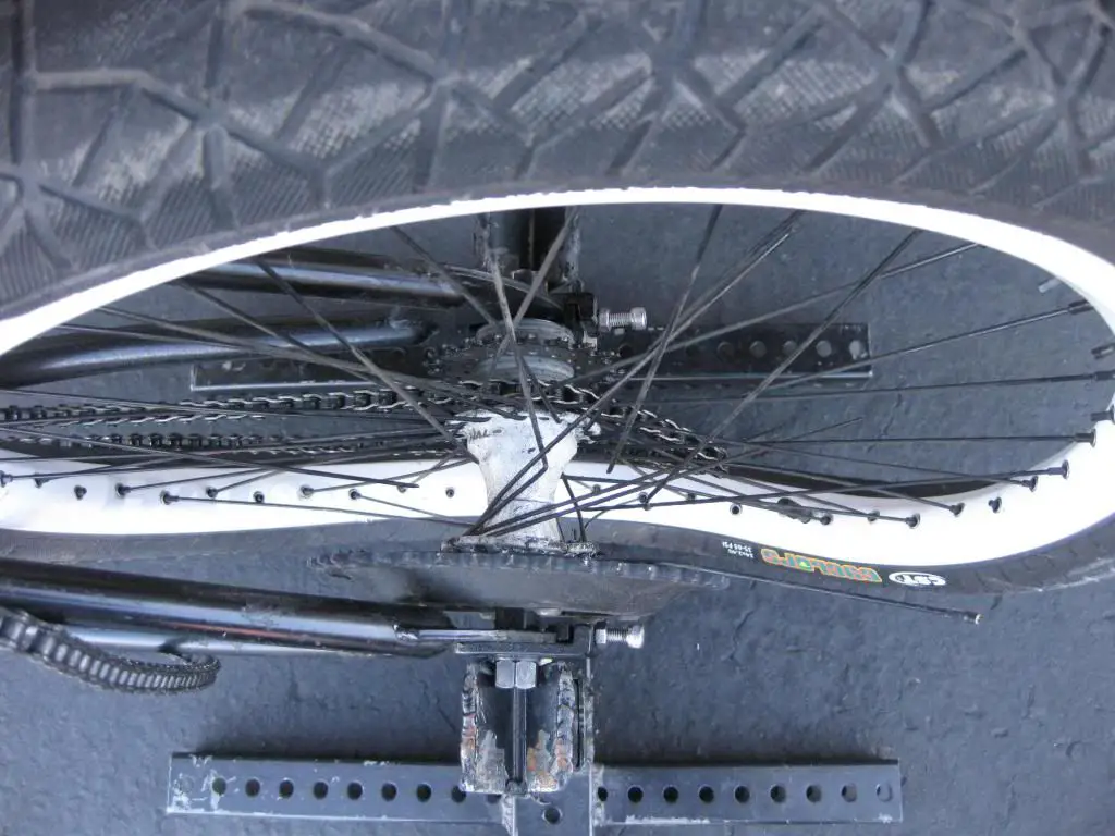

    My back wheel went a little out of true and I was told it was "bomb proof". Does that tell you what kinda horsepower my bike puts out?

    Dang dude! I heard you wrecked but I didn't know it was that bad, I could only imagine the damage to your frame.
    Looks like you a nuke go off next to you.

    Just soak it some hot water and lay a sheet of plywood on top of it with some weight. When it's dry it'll be good as new. :)

    I was thinkin' more on the lines of a steam roller.........that thing is toast laff

    The "bomb proof" hub ripped in half.......that's not enough? rotfl

    There was one time I heard of a rim bending like that pretzel shape, and the person was probably around 200 pounds. It was a non-motorized bike. I don't think anyone here had the same situation. Note that the wheel was assembled by the guy himself. The spokes were not tightened down very good. The wheel was really a not perfect in any way of true, but the brakes did not rub so bad that he could not ride it. It was said all of a sudden it just went, nothing other than normal riding. I saw the result and it looked like what the picture shows posted.

    That rim had more than engine problems...looks like it was "trued" wrong. I saw a wheel do this once just from airing it up to 60psi. It simply exploded into a taco chip shape breaking a bunch of spokes as it bent once it got to 60 or so psi.

    If you're referring to scotto's rim, his bike took off without him and ran into a wall. The bike in question has a 212cc engine with I believe 7 ft lbs of torque. That's about 3 to 4 times as much as an ht engine. I seriously doubt scotto, a man who's been racing and riding all his life, would put an improperly trued wheel on a bike with that kind of engine power. Anyone who would do something like that has bigger issues.
