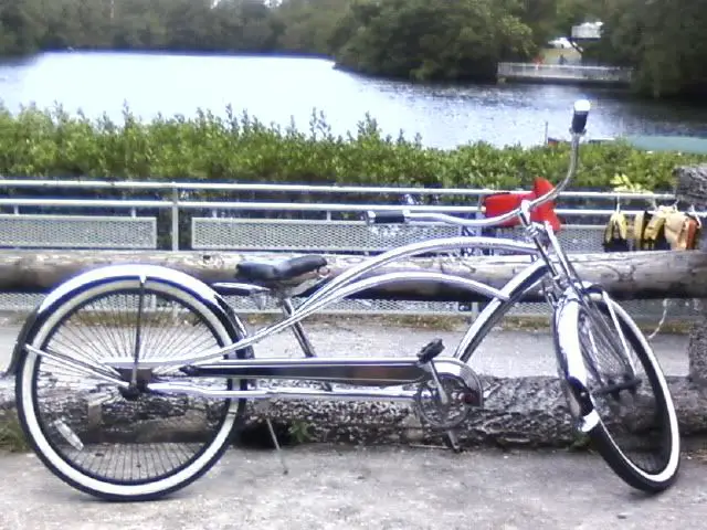

hey there bill i really love your project man!!!... is pretty neat and seems to be simple... i was just wondering if you were willing to help a fellow rider to build his own??... id just need to know whats the approx budget and the pieces that u bought... here is a pic of my mustang (its all stock)... thanks 8)
