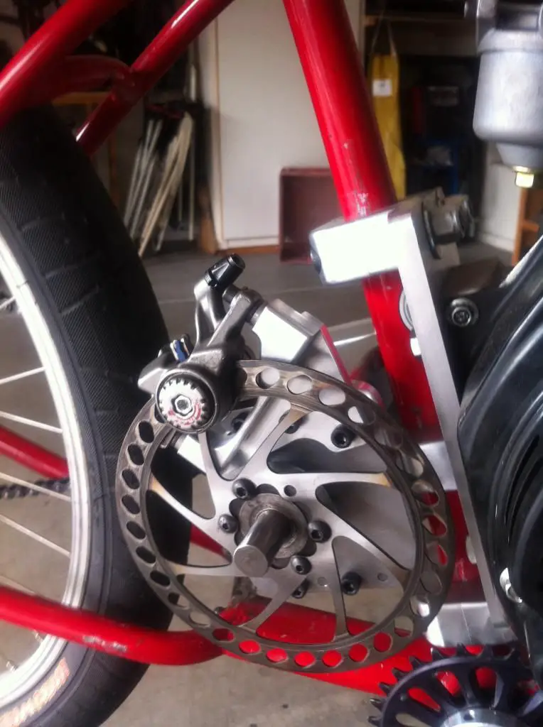

I have a lingering question with these vertical HF engines- why does almost everyone create the intake manifold so that the carb is behind the engine? Seems like there is alot of empty space in front?
Also, I'm glad I looked at this pic before I made my intake because I now realize I have to clear the shroud (I don't currently have mine on the engine but will probably use it in the final build).
My air cleaner would hit the front down tube unless I had it at an angle,
and I like the look of the carb behind the motor.

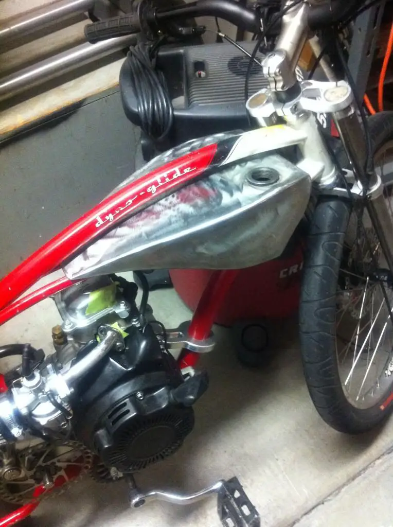

That tank looks great! how does it mount?
I have bungs that are about 3" long 1" wide welded inside the tank that
bolt to the cross bars under the tank.
Here is a picture of the inside of an old tank I made.

Thanks Bill
