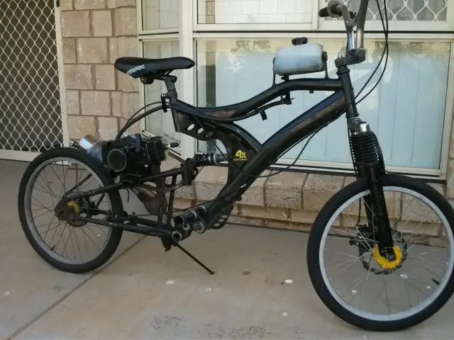

Yes I have used the standard 49cc pocket bike engine.. have mounted it on a modified dual suspension mountain bike/bmx. as ur post mentions it has 6 teeth at the front and a 72 tooth sprocket on the the rear wheel which i have attached to a BMX twenty inch hub (diamond back aluminimum) i actually removed three spokes from the hub to attach the sprocket. made mywn exhaust pipe using pit bike components ( has increased the compression)- it works great! i also added a
high performance head and cyclinder kit.. it has a top spead of around 55kmph at the moment, i am using the generic carborator that was supplied currently the motor will rev out quite imprressively ( but does sound like its starving and wants more). am looking for a buzz so am thinking add a beter/sligtly large carb.
also i have an aluminmum whipped cream cannister ( 1 lt) that takes nitrious Oxide was thinking of adding this as well!! DSCF0023.JPG any way i think they are great motors the last a while as long as you dont burn out the bearing seals from to high a compression or using fuel with know oil
any way if the photo doesnt turn out let me know

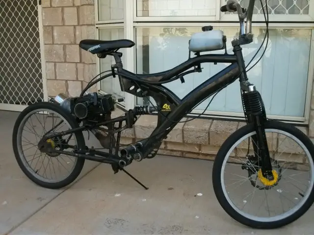

also i have an aluminmum whipped cream cannister ( 1 lt) that takes nitrious Oxide was thinking of adding this as well!!View attachment 34229 any way i think they are great motors the last a while as long as you dont burn out the bearing seals from to high a compression or using fuel with know oil
What size chain are you using? 8mm?
Your bike will perform better with more gearing. With 6t/72t sprockets, you have 12:1 gears. If you add a 5:1 transmission and change sprockets to 10t/36t, you'll end up with 18:1 gearing and better take off and acceleration...without nitrous.
Just something to think about.xct2
