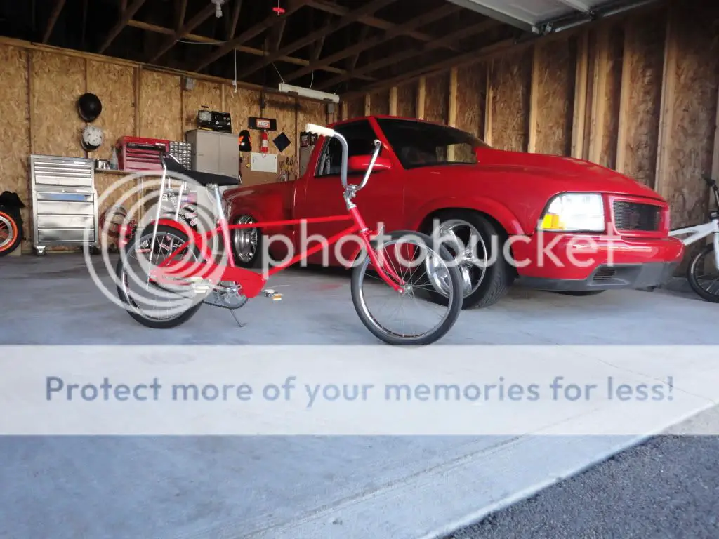

Hey guys, names Jesse from Beloit Wisconsin. Been into bicycles all my life, and after seeing a guy cruising down the street on a motorized bicycle I wanted one haha. Tis is the bike I'll be using
And here's the kit I bought which will be here tomorow, also bought a booster bottle which comes Monday.

Thanks 2 door. I hope motor will fit even though it's a twenty inch. If not I'll modify the bike more. Also looking to mod this motor. Any suggestions? My goal is to hit 50mph

hi jesse and welcome to our world of motorized bicycles. I will first say I love the truck in the picture and number 2 bicycles are not meant to do 50mph. things start failing fast. great to have you with us

Lol trucks long gone.. Bmxing used to be my old love, but after getting hurt I had to quit which then I got involved with trucks. Not sure if your familer with them but now I own a pretty built gmc typhoon.

Your truck reminds me of the Pro Stock Truck class that the NHRA
used to sanction. I miss seeing those trucks race.
