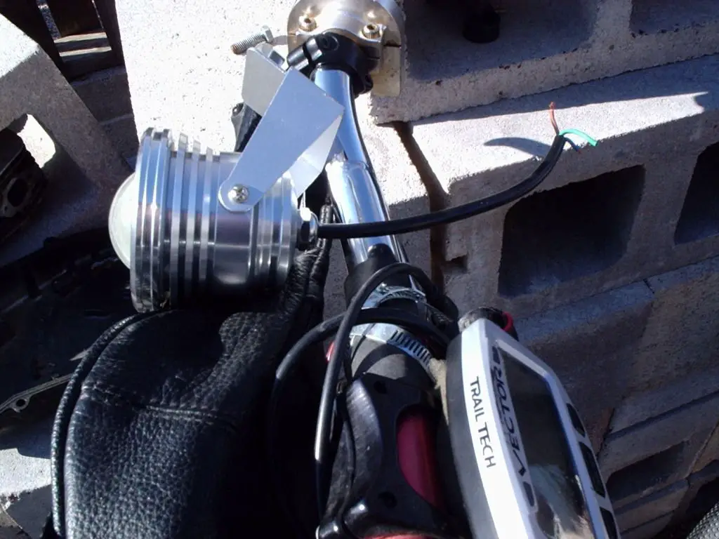

I got a similar one from DealExteme.com. The link is 10W 800-Lumen 6500-7000K White LED Light Bulbs (DC 9~26V) - Free Shipping - DealExtreme
Here's how I mounted it on the bike.
The mounting yoke that comes with it is very weak. I don't trust it. I made my own out of 1/8" x 1" aluminum bar and mounted it using 1/4" stainless bolts and nuts with o-rings. Here are pictures with the new yokes.
