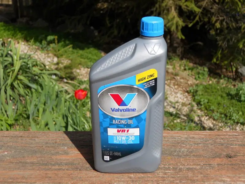

On Tony's advise I stopped a NAPA to get a quart of High Zinc oil. Back label reads like it could/should be the only lubricant one would ever want to use. My only thought is Synthetic is lower ash. Oil prices being about the same.
