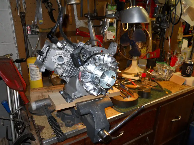

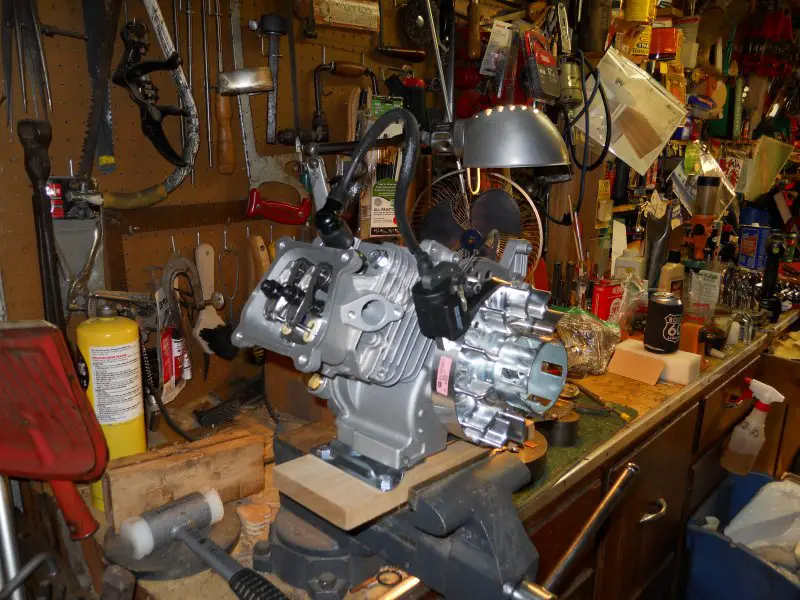

I should have finished fastening the stock Predator engine mount to the engine block and bolting the engine mount to a poplar board. That board I will / did clamp in a bench vise. This is all just to create a secure system for the rest of the engine fastener torqueing. I just didn't like the AGK way of holding an engine being torqued.

In the mean time, valve lash is set cold as per AGK .004" and in my case 60F. A 79cc head is so confined I had to bend the tips of the .006 and .004 feeler guage tips to be able to attain a sensitive feel. Rocker cover is on.
Next trick is fitting the blower housing and see if the recoil start works correctly.

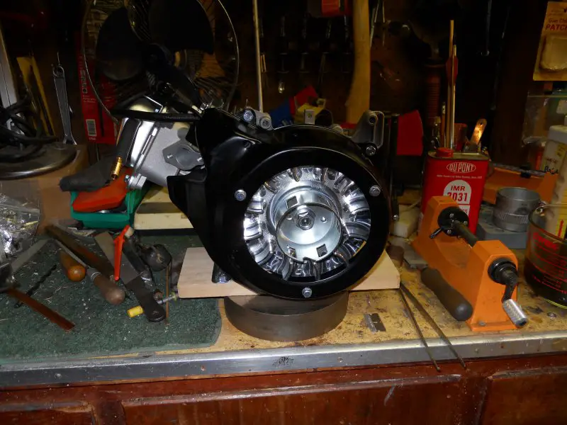

It could be so simple as pulling the flywheel and lapping it (key note word) "into" the crankshaft taper. The magneto pick up is not centered on the magnet field. Any thoughts?
Blower housing is now on and some of the tin bits. Started with the recoil pull start attached. A few pulls of the starter rope were less than ideal. So off it came, and so exposed the rope start hub, just barely. But enough to wind a full pull start rope.
Time to swap engines with the one currently powering the Sportsman Flyer.
Photo of the ready to load 79cc hot rodded engine.
