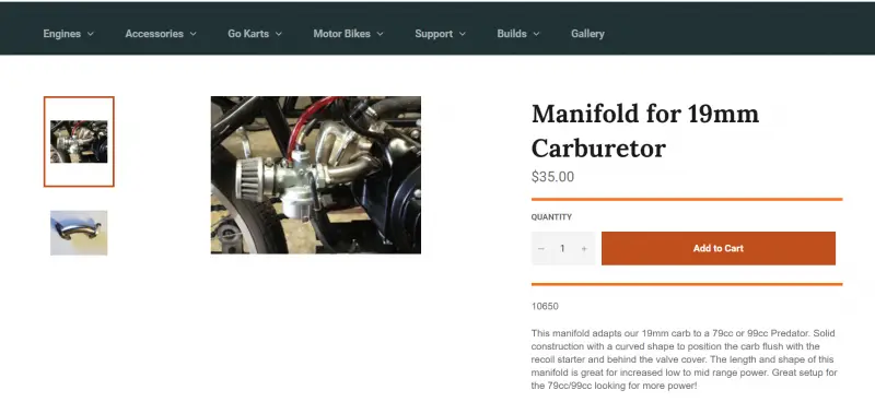

I just have a few questions about this reworked carburetor (in case I decide to go for it). Would I need to buy an intake manifold for it? If so, what is the purpose of it? I have attached a picture of what I am talking about below.

Don't waste time and money on a reworked carb.
Just get a 19mm Mikuni clone on Amazon mostly $20. Needle set middle notch AGK sells them too for much $.
