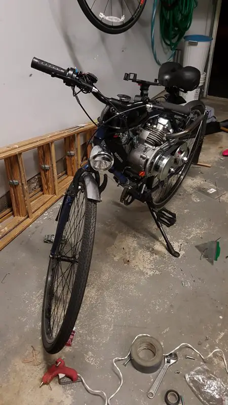

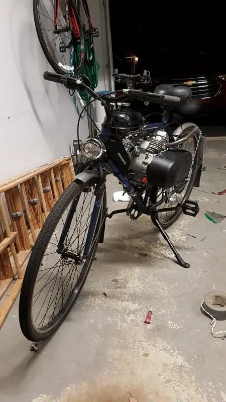

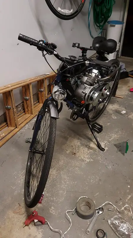

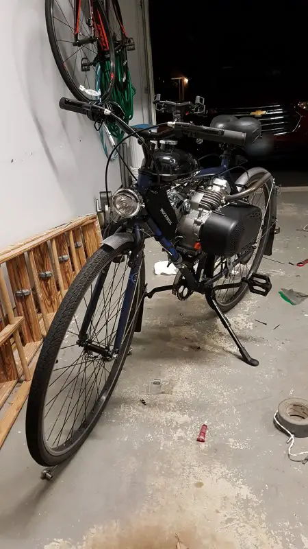

It has been done. This offers a crap ton of torque, however the top speed is lacking. I am going to change from a 44t rear sprocket to a 40t. It is much smoother than the centrifugal clutch, as there is virtually no shaking. I recommend the switch if you can do it, but be warned, it is not easy.

It has been done. This offers a crap ton of torque, however the top speed is lacking. I am going to change from a 44t rear sprocket to a 40t. It is much smoother than the centrifugal clutch, as there is virtually no shaking. I recommend the switch if you can do it, but be warned, it is not easy. View attachment 106640 View attachment 106641
Woo Hoo! Looks great!
I had to run my setup as, TAV2 10T-60T on the rear, giving a ratio of 16.8>1 on the starting end, to 6>1 on the high end, (which the little Lifan can't manage with my lard butt on it) It advances the belt to about a 1/3" from the top of the driver when maxed out.
Are you running it directly from the TAV2 to the wheel without a jackshaft? If so, I'd recommend a larger rear sprocket, so that you can use more of the TAV2's range, plus you'll pull even LARGER stumps!
I think the lack of top speed is just a function of our limited HP on tap. Mine is struggling to hit 30mph, but I've got some issues to sort on the motor before I call it done.
Keep us posted! Fascinating stuff!

The thing is, I need to hit at least 35 (or at least close to it) since I ride this thing on the road, so I was going to switch from a 44t rear sprocket to a 40t rear sprocket. I run the rear sprocket of the tav 2 directly to the rear wheel. Is this a switch you recommend (going to a smaller gear size)? I realize that I am not going to have the same amount of torque, but I'm trying to really squeeze a bit of speed out.
