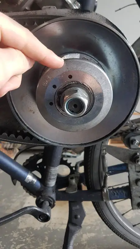

Does anyone know how changing the position of the spring affects the tav 2 torque converter? Like does it make it harder for it to change to a higher gear ratio?
Doesn’t matter what you do it won’t top out more than 30mph.
You can put a stronger spring in a clutch to get better acceleration. Green or black spring.
The q-matic with its clutch on jackshaft and belt drive primary is the best design transmission out there for many reasons.
