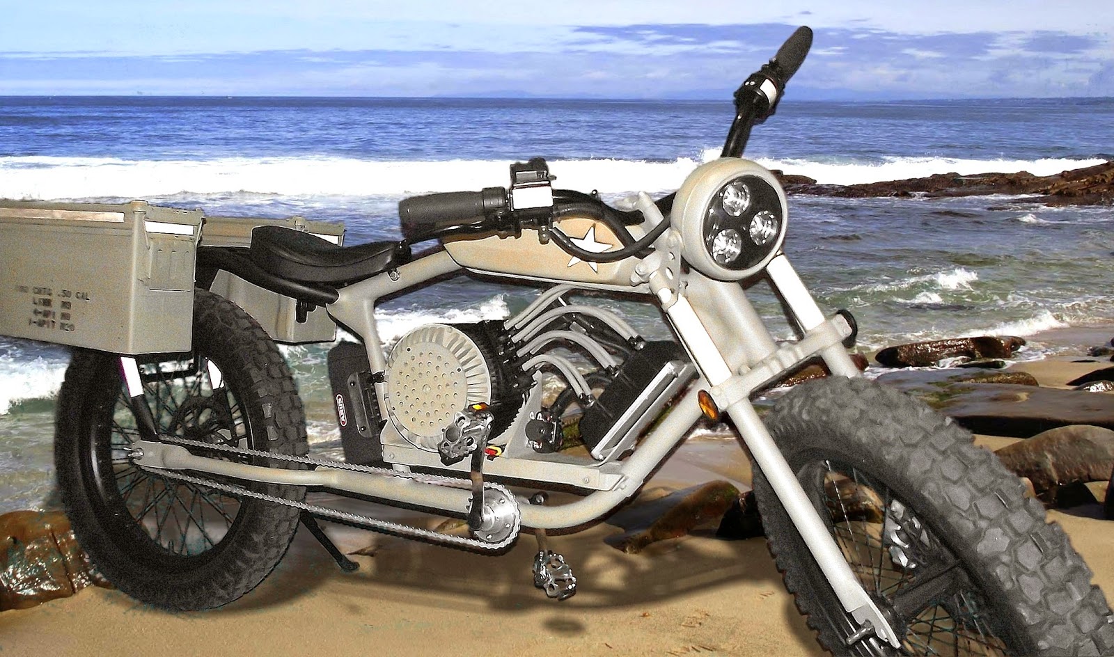

I have a full sus jewel of a bike at the ready when I get some of this stuff sorted. Money always the major factor. I wanna build a 50 plus mph model. Not far off from Bikenuts.. With many of your folks improvements. Stability mad power and distance. Picky I know lol. Basically a sweet smooth hotrod.
You folks know the stuff..:)
Bikenut you about ruined me with that Russian's hopped up bike. That'un is perfect I will take that one! Jee Whiz now I gotta stop thinking about it.laff
