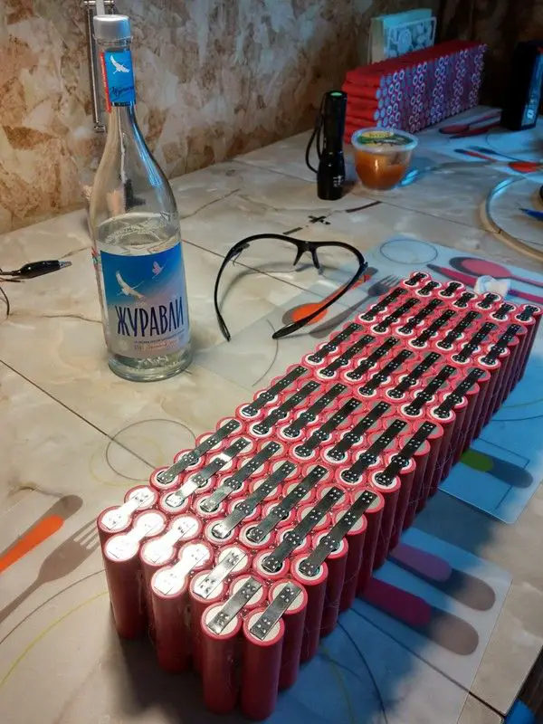

I've been talking to a guy on es that's running this is pack in his Bomber. His Bike is jacked up to 10 kw. He's running 20s 14p 84v 35 ah. I want this.
This is half the pack. It's made of LG 18650 2500 mah
That looks great Biknut and I'll use anything that has a high discharge rate but look at the "Maximum Constant Discharge Rating" of that LG battery at the link below. Ask him what his "Maximum Constant Discharge Rating" is for his entire battery pack......because nothing else really matters.
http://www.vividsmoke.com/lg-18650-he2-35a-2500mah-battery.html
No need to ask, it's 280A continuous rated multiplied by 74v nominal to make 20.7 kW discharge capable. HOWEVER, I would be hesitant to do that with the cells packed so tightly together with no method of heat removal.
