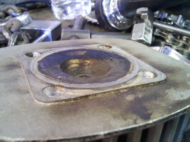

i have not seen a squish band on any head yet, but i have not seen a slant chamber either. im not so concerned with the chamber as i am with the cooling capacity, because i can build up and machine the chamber however i want. anyways, this is a pic of the head from the first few posts, the cheese head has the same size/shape chamber, but is still on the bike. i told the ol lady i was gonna be defying death at the death race. yaaaayyyyyyy!

Ah! See heres the chamber you welded at another angle. You did indeed not deck it perfectly flat, there is a squish. Thats what I originally was discussing.
As for the chamber and cooling capacity, those are almost directly related. The smoother the chamber is the less heat soak it is subjected to, so the less heat it absorbs. (and there is no offense inteded by this...) And really your chamber is far from smooth. Really you should get in there with a fine grit ball stone or perhaps even a sanding barrel. Also make a decent chamfer radius on the transfer from the chamber to the squish. Doing both these will make your engine more efficient by turning more energy into kinetic energy as opposed to heat energy.

All of the threads that are beyond the sparkplug need to be removed and the area polished smooth.
