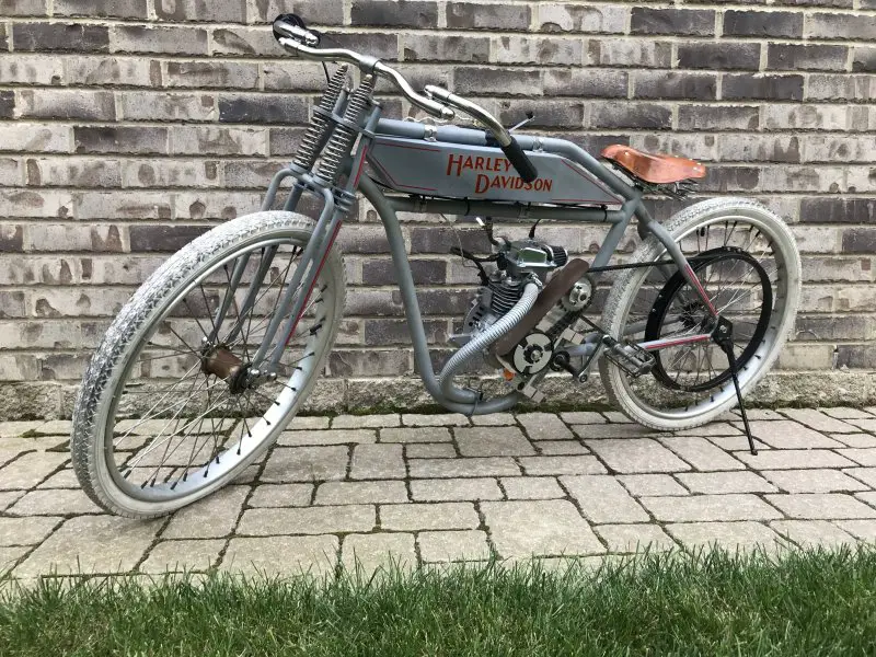

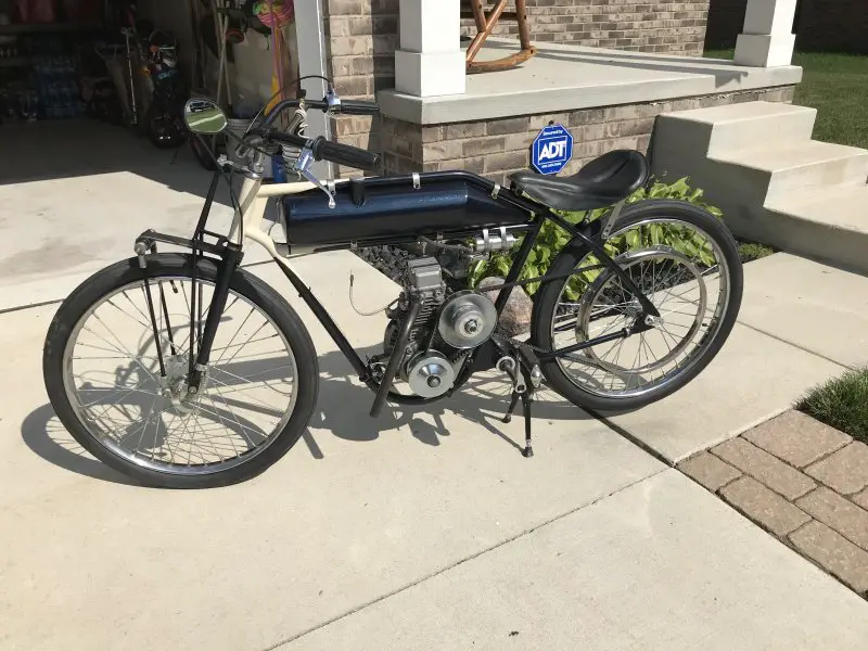

Yep very wide and the clutch set up needs some messing with.Here are 2 other options 79cc and a 212 . You can also do the 79cc set up in a 212.

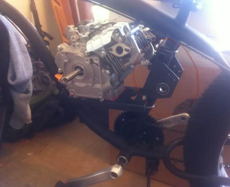

So, considering the weight of the new sprocket, and the wrong size at that, I'm going to be going through sick bike parts for the chainring adapter, and attaching a 30t chainring. I will be drilling out the holes for larger bolts from Home Depot to handle the engine power. I will also meticulously align those sprockets for the straightest possible line. However, since I have already purchased a new chain to fit the sprocket, I will be using that until I can afford the chainring and adapter.
I am also concerned about things breaking under this kind of engine power. I am looking for a way to reinforce the gear on the seat post. I may use horizontal dropout frame to prevent the rear axle from coming out under load.
I'm running with a qr skewer with vertical dropouts, and I haven't had an issue with the axle moving under load. Of course, that doesnt mean it can't happen, I'm just sayin it's unlikely, especially once you apply enough torque to the nuts/skewer.
Gear on the seatpost? I'm gonna need a picture for that one. If youre talkin about reinforcing the seat tube though, just drop another seatpost down in there.
I think the part I have circled could twist under the kind op power we will be putting out.
