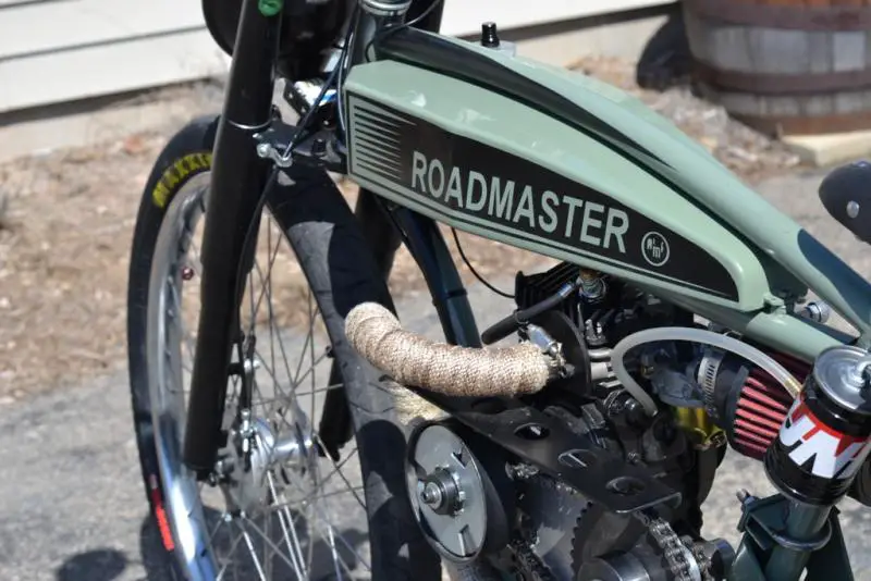

Love 'em, built a handful, this one just left the shop this morning.
Big Red II.
Macargi Pantera 7S with aftermarket front shock fork and 3-speed internal rear hub gearing.
$350 gasbike 49cc HS 152F 4-stroke and 4G transfer case.
$200 SickBikeParts 4-stroke shift kit.
I did the gasbike engine kit opposed to just an engine, tranny and basic parts like gas tank and throttle because I can use all the let over parts that the SBP 4-stroke shift kit replaces later so price them separate from the JS kit for just what you need if you don't want extra parts, the thing is when I shopped I only saved like $25 from just getting a whole direct drive 4-stroke kit and I got alot of left over parts for dirt cheap opposed to piece-mealing the part buys.
Many build options but a nice system indeed.

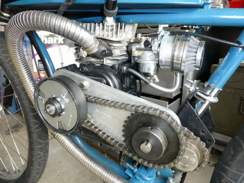

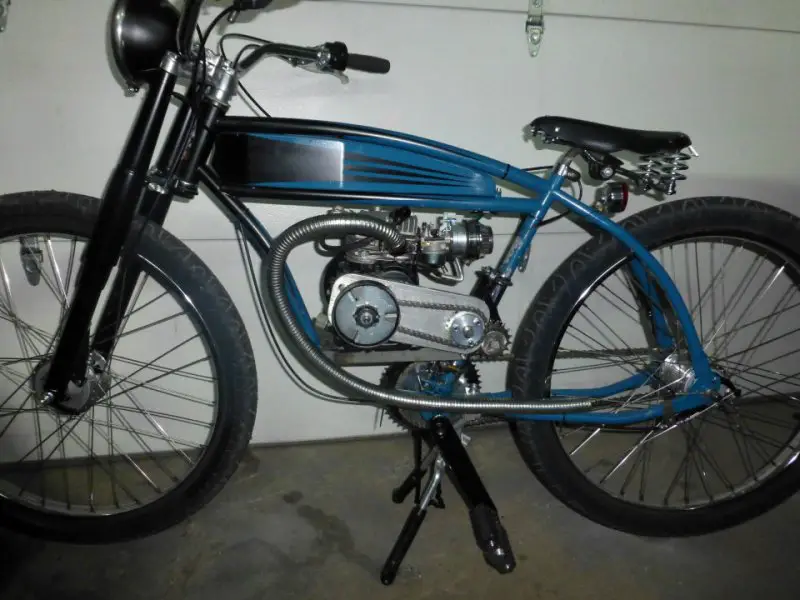

Mags that's still a great build, doing it right stays cool!
Rick C.
Yep those were oldies but goodies. I like the shifter bikes ...they are fun... but can be a little more work setting up. Also adjusting chains till they are done stretching is not that big of a deal,as long as leave room for adjustments.
