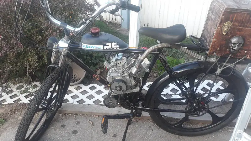

This is my R&D build, and my first four stroke. Don't do mag wheels, they're too heavy. Go 8 speed for the gear range, and do the x.8 (sorry, it's the X.4) system from SRAM with a 40t-11t range cassette. You'll get crazy acceleration off the line. I also had to swap my mechanical AVID BB7s with mechanical hydro BB7s to compensate for the heavier wheels.
Be aware that your drive side chains may bind once you start shifting up. Take actions to ensure this does not happen, such as increasing the gap between sprockets or adding in a slip disc (a metal disc made to prevent chain binding)
These only come 3/4" so if you have 5/8" shaft you need a bushing, you can get them with key-way cut in them, and a 3/16" x 1/4" key......Curt
Yes, I am using both chainrings provided in the SBP shift kit bolted onto the freewheel they also provide. I recommend swapping out the bolts they provide for some better grade 8 bolts from home depot.I am not sure how your gearing works. Do you have more than one front chain ring? I am keeping the mags because they seem to be more stable going down very steep hills 40 to 45mph.
Just a theory: I think the weight of heaver bikes dampens most types of vibration including high speed and engine vibration. I could be wrong just my observation
