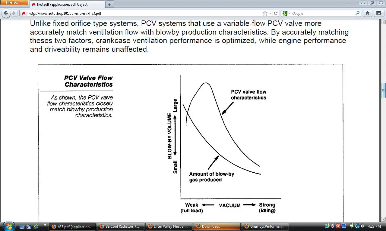

The vent hole lets hot gasses escape, oil residue comes with it.
Never plug this, the crankcase needs to vent.
Cars do this with a PCV valve.
Yes you can just dump it into a 'catch can', It's not as 'green' that way.
But does it help performance?
Yes it should, if you do it right.
I have no example, I try to stay as green as I can.
http://motorbicycling.com//www.pinterest.com/pin/create/extension/
PCV stands for Positive Crankcase Ventilation and it is a way to make power.
Blowby and the piston's downward movement build pressure in the crankcase, impeding the piston's downward movement.
By putting vacuum on the bottom of the piston you increase the effective force on the crank.
The basic theoretical horsepower formula is PLAN/33000 ignoring friction losses.
