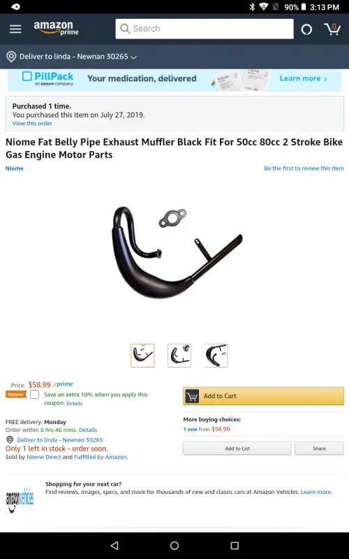

I found a pipe on sale on Amazon, $53 shipped. With prime it will be here Monday.

i've only used my own creations or stock/modified stock mufflers. i made this modified poopoo motcross pipe, worked really well on a 49cc, but only like 1500 to 2000 rpm band on a 66cc, an only higher up the rpm's( hit's like 4500 and runs to 5500-6000) are you really on the pipe. on the 66cc, when it hit's, it hits. take ya up a hill 28 mph, for blocks on end. top speed of the bike is 32mph. the bike runs best when loaded, like into the wind, and holds it's 32mph if ya let it. i got some steep hills around here. it was an almost 40mph bike till i wanted more torque for the hills.
I was going to test the new chamber on this bike but it hits the fuel petcock, so I tried 4 different pipes on my black bike. The expansion chamber is the best performing but will wake the dead, I'll have to add a silencer. My modified stock pipe that came in a grubee 2010 kit was 2nd, a stock pipe I ordered off eBay that has a longer head pipe and a short fat body was 3rd and the stock 2014 no name kit pipe for a 66cc was slowest.
I also had to put a can on the "Miami" long ...style expansion chambers I run on two of my bikes...I'm too old to enjoy the noise or making enemies of my neighbors and cops, but there was a day...
Putting the same muffler on both bikes made each run differently which is 'kinda strange because both are identically modified reed motors but noticeably hit these pipes at different points in the power band, with or without the mufflers. Getting the right ex-chamber for any 2 cycle engine is the key to big performance and really make the rest of your power mods come to life, but it's science mixed with voodoo to get one that really performs; in my case I just experiment & call it luck when one really works!
