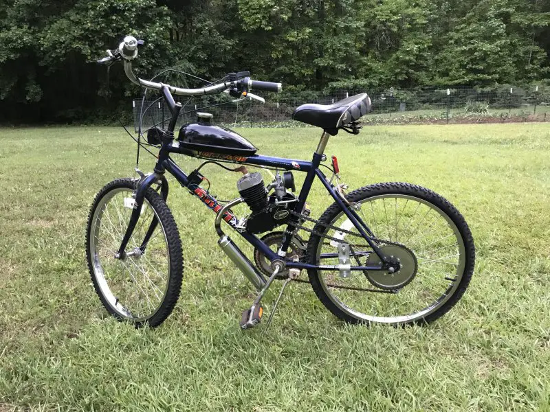

This bike was something to try a few things on, I’ve found out a couple of useful things already. I have several different style heads and found a straight plug head with a hand ground squish band to be the best running overall, I’ve got another head on the way and will try it next. I cut up a stock muffler to start a exhaust with custom look to it.
Here’s a picture of the bike as it is now, I still have to add the muffler hanger and wire loom the wiring along with a mirror. Got a little more cleaning to do, the rims were covered in grime, it was so thick it looked like rust. A little elbow work with some 0000 steel wool and they cleaned up well.
View attachment 101011 Here’s a picture of the bike as it is now, I still have to add the muffler hanger and wire loom the wiring along with a mirror. Got a little more cleaning to do, the rims were covered in grime, it was so thick it looked like rust. A little elbow work with some 0000 steel wool and they cleaned up well.
Nice, Neat, Clean and simple build Greg. Looks Great!

This bike is fun to ride, it still needs a little smaller jet, I have to get it hot before it runs right. The plug is a little dark, I'll solder up the jet and drill it. I got a mirror on it so I feel better about riding in traffic. I'm going to enjoy my test bike.

if it's under 300 miles, i'd just leave it rich. lets oil build up in the crankcase. also helps retard the heat created from all the friction of the rings seating. i always went by ( i'm no 2 stroke expert, actually the first time trying to soup them up for real was with these engines, dirt bike parts cost to much) if it had a few tablespoons or so of oil in the case and the parts are coated in a film, it's perfect amount of oil. rpm and load dictate oil needs. i'm not you and won't tell you how much oil for you ride, pretty sure you got this. lol. just remember tht extra gas carries heat away from a fresh cylinder/rebuild.
This engine I rebuilt in 2014, I don't recall how many miles I've put on since. The carb is jetted for a 66cc, I ran it on one of my other bikes. This engine has a ramped piston with the skirt notched also with extensive porting, I was hoping the little 48cc could handle the fuel but I need to reduce the jet a little.
I kept a rebuilt 66 as a spare for my bike. Havn't needed it. But, before putting it on the shelf in 2016 I too did the ramp and skirt. Also lapped the head a bit to increase comp. Because of your latest adventure (inspiration) with the 24, I decided to use this engine along with other components I've collected over the years to once again assemble another 26.
Curious what size jet in there now and what size you are going to.

Allen memory fails me sometimes but I think it’s a number #70 drill. I had it tuned to the 66cc with the pipe I built. I don’t remember why I changed it out, I might have jetted the new carb and just swapped them out.
From what I understand, NT stock are #70 5mm Delorto style.
My 29 is running super rich with 70. Spotting all over the place and black plug. Lotsa smoke. I will be starting with 65, will get a 63 and 62. I'm running B.B.R. Thrush pipe. Love it. it turns on early and hangs in all the way to the top.
Way too much jet though.
