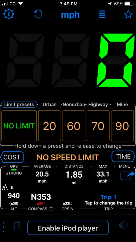

This little 24” bike will hold it own with my bike I ride most, I got 33.1 on my phone app, it has been accurate when checking it against the car.
