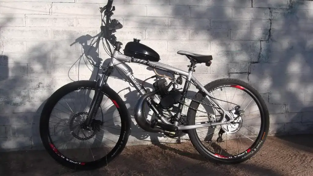

2010 Specialized HardRock

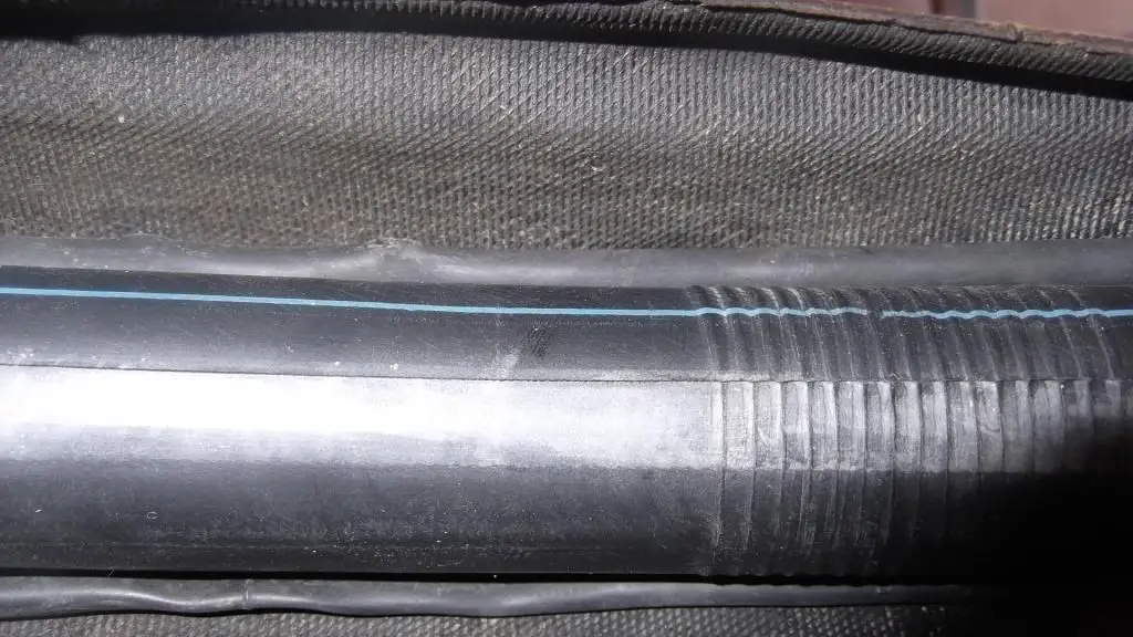

This is how I use old inner tubes for liners. I just cut off the valve steam and install them inside the tire, then the tube.
After the liner and tube are inside the tire I make sure to go all the way around making sure nothing is pinched and the liner and tube are centered.
Once that is all good, I then install the tire on the wheel normally. Next thing I do is air up the tire, then deflate it. I will inflate and deflate several times, if their is a pinch sometimes this helps get rid of it.
This is how for many years I run my tires. A few flats but those were nails that really nothing would have stopped.
Until my last ride, this has never failed me and the only thing I did different was when I installed the town and country tires I went ahead and used slim tubes. I have gone back to regular tubes.

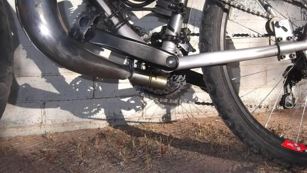

And I added a silencer to my little pipe to take the bite out of it a little.
Went for a quick little ride to test out the new exhaust addition. Lost a little on the low and quite a bit on the top.

Time to replace the exhaust gasket with a new one on the H Rock.
I whacked the exhaust pipe on a big boulder and I noticed it started leaking a bit after that.

Just picked up a 2005 Hard rock in a cluster of bikes I bought at a sale.
I wasn't planning to motorize this bike.
Then i saw this thread.
You guys get me in more trouble.
Nice bike man.
Mine is pretty much the same as your's minus the disks.
I will be adding them .
Thanks Box,I really do enjoy my HardRock. Four years and thousands of miles its still going.
When I first assembled my hardrock I only ran caliper brakes in the rear and disc in the front. When I finally added the rear disc what a difference in stopping power.
My rear caliper brakes worked fine so I thought the disc would not add much braking power. Boy was I wrong.
Hope to see yours together and running soon.
