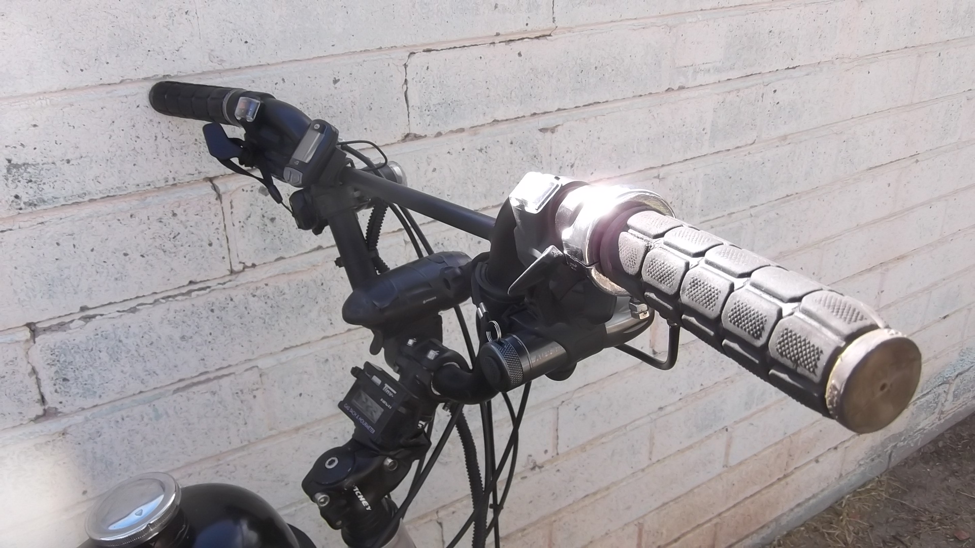

And I swapped over my bars to some BMX bars. I hope it makes long rides more comfortable.
Someone asked me about mounting my BMX bars, sorry i forgot who you were.
The bars are off a kids 16" dumpster bmx bike that i found. I even cut them to make them narrower. They just felt too wide and were wider then the stock straight bar so i cut them to the same size as the original.
Yes, this bike has 1" (22.4mm) bars and the bmx bars are 7/8. In order to mount them I had to make some shims.
You can buy handle bar shims for about $10, but i just make my own using a old aluminium set of bars.
For the shims I just cut the bars the correct width then cut them in half. This allows you to use one on each side.
http://motorbicycling.com/attachment.php?attachmentid=59332&d=1368105151on this photo you can see the shims I used to mount the bars.
And no, I've never had any bars come loose on me yet.

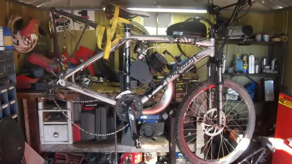

June was the last time I even touched the HardRock since my last ride http://motorbicycling.com/showthread.php?t=49323
Its been collecting dust with two flats and the rear wheel removed just the way I left it when I had to hide it along side of the road and hike back to my truck.
Today I put it up on the stand. I have no desire to ride it, but might as well get some tubes in it and ready just in case I do.

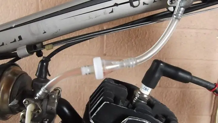

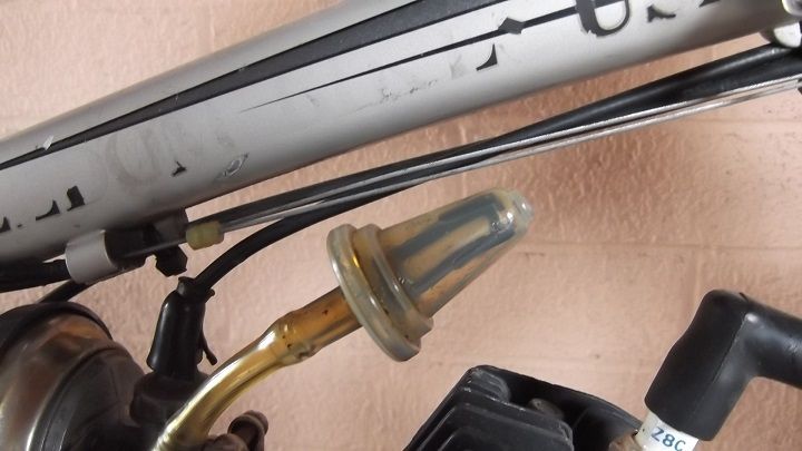

I think something is wearing down in my carb, the float keeps getting stuck now. It gets cocked in their and i have to whack my carb bowl to loosen it up.
Don't know how many more taps my fuel bowl will take before it breaks.
After replacing the float and tab, thanks to 2doors suggestion I next changed the float tube and that solved my problem.
