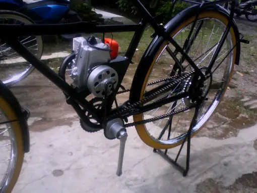

i use brush cutter engine on my bike, 2stroke 32cc, about 1,6 hp
