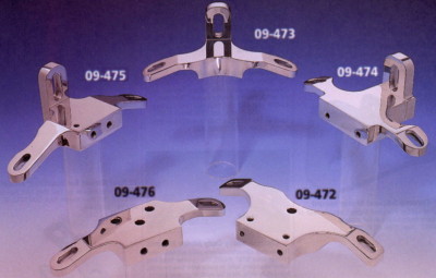

Harley motor mounts (granted they're billet, but the point's the same);
HT motor mount;
A slightly different story methinks ;)
