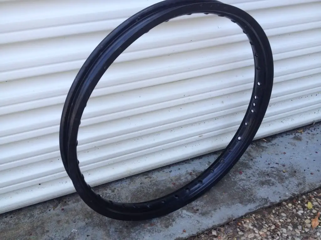

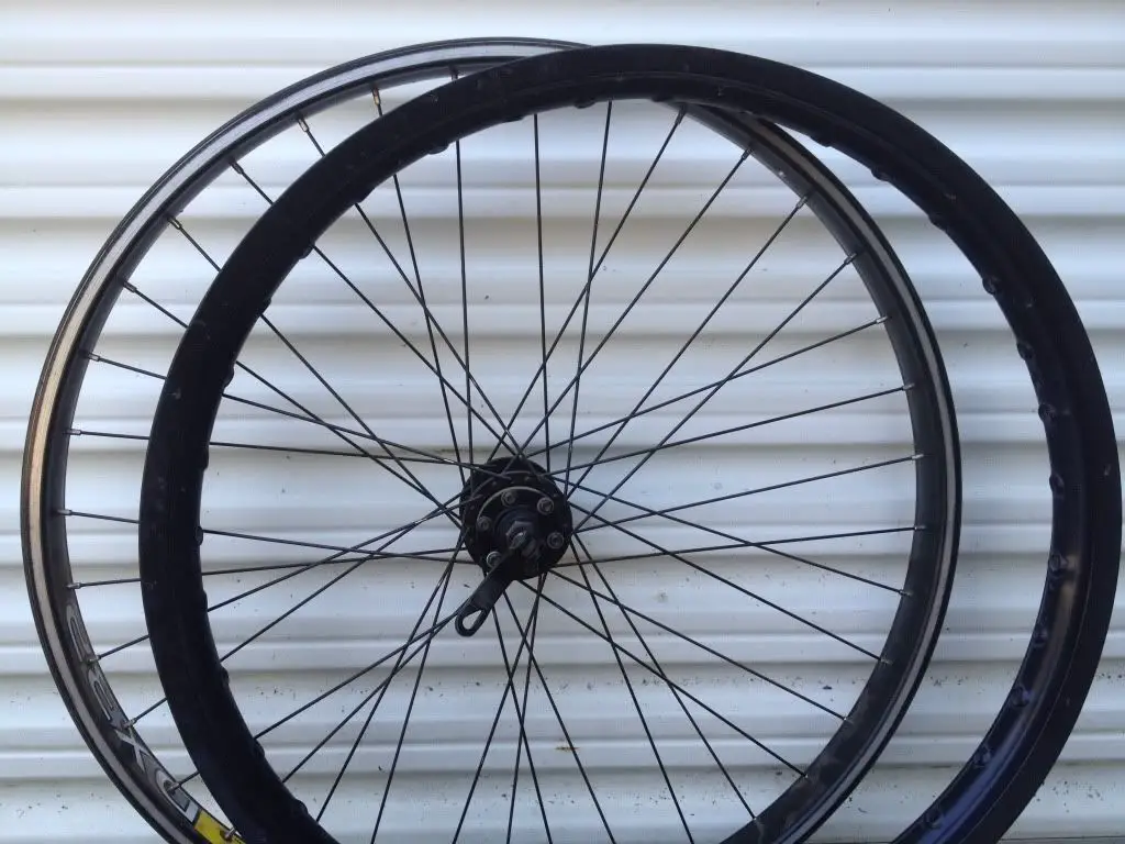

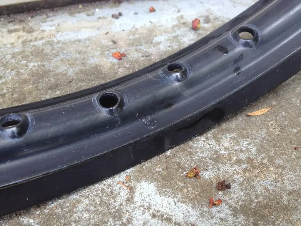

I dug out the 21" motocross rim i had in the shed, its brand new. Just with a crappy anodising job, but since i had it sitting around i may as well use it. I sat it next to a 26" bicycle rim i have and there isnt a lot of difference. Avon sell a really nice 21 x 3 if i remember correctly so ill get them, i just need to find another 21" motorcycle rim and hubs to lace them to. Ill run drum front and rear.

I'm liking where this is headed Harry. I had no idea a 21" rim was similar in size. I will keep this in mind if I ever do another build.
To be honest i didnt realise that either, i must thank Mr. B for pointing that out to me, and seeing as a worksman rim would be so dear over here in OZ its saved me a lot of money and will be peace of mind...... I wish someone had pointed this out to you because your bike probably would have benefitted from motorcycle rims perhaps?

Modern 21” motorcycle tires =
(including vintage motorcross)
21” inside tire diameter.
22” outside diameter of rim.
Appox 27” outside of tire diameter depending on the tire.
26 x2.125 Bicycle wheels =
21.75 inside tire diameter depending on the tire.
22.5” outside diameter of rim.
Appox 26” outside tire diameter depending on the tire.
28 x 2.5 Antique motorcycle wheels (aka: tall wheels or skinny wheels)=
24.75” inside tire diameter depending on the tire.
25.1” appox outside diameter of rim.
Appox 28” outside tire diameter depending on the tire.
Keep in mind most vintage fat tire & modern bicycle frames are about 10% smaller than the actual early motorcycles were.
Not having the properly proportioned wheels is pretty noticeable in my opinion.

Thanks so much Mr B, invaluable info you have supplied me there. I don't feel like paying a fortune on tyres so I may just go with my 21" motorcycle rims...... But I may do a little more digging into the 23"XL rims but I think they would be a hard find. Thanks again
I'd love to get the proportions exactly right (and from having interests in cars I realize how much 1" in a wheelsize can make a massive visual difference, but budget will probably make my decision for me. I've seen the 21" motorcycle rims used on a boardtracker and although not perfect still looked good enough
