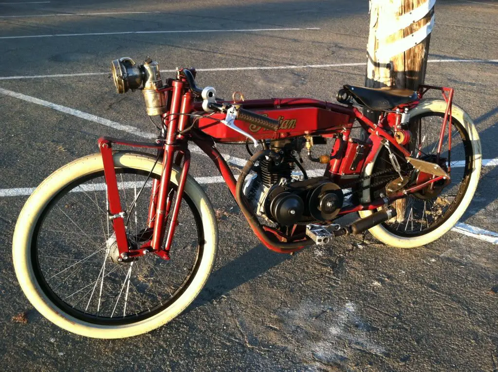

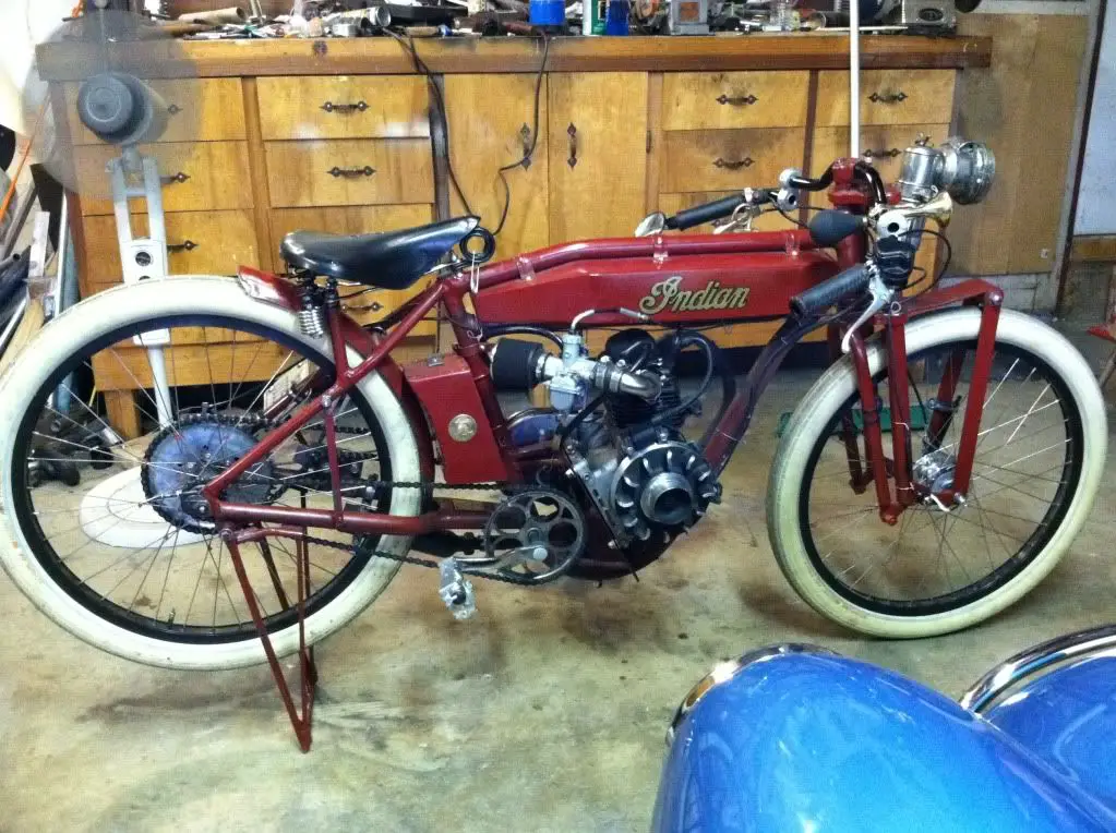

Thanks man! I get an incredible high everytime I ride her. And it keeps getting better! The fan blades still cool the case even though the shroud is off. It sucks the air at the center of the fans vortex and it carries the air around the opposit side of the engine. Aluminum engine case absorbs the engine heat that is absorbed by the splashing oil and the circulating air carries it away. I was in a parade for 30 minutes traveling at 2 mph in 100 degree heat and it didn't even get close to overheating. The fan also blows on the intake and carb for a cold air intake effect. My carb is always 20 degrees cooler than ambient. I always ride with my right leg in the rear most position and have not had any blade chop problems. Just in case though I rounded and polished all the blade fins so there are no sharp edges. The comet tranny is the bomb. You will love it! I'll post some shots of the lamp mounting later today.

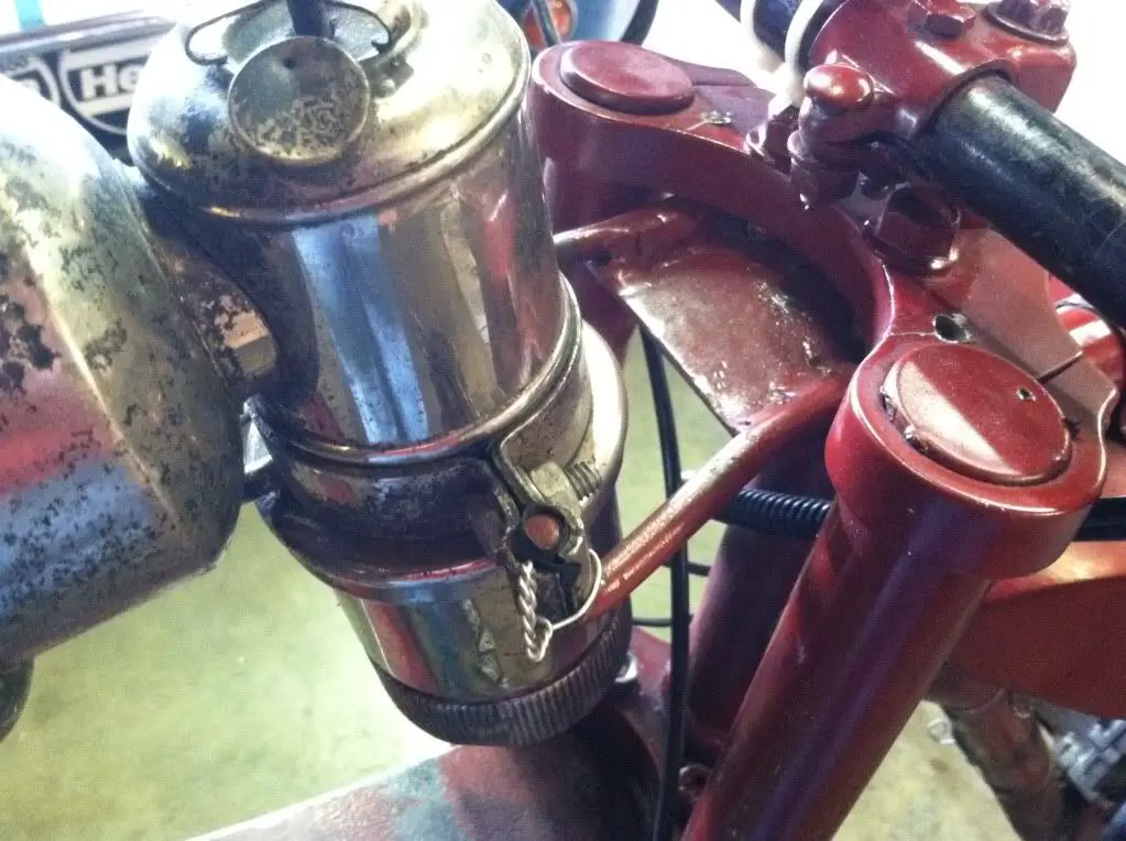

:eek: Saftey wire? Heh! Coolness. Do you actually run carbide in it?
No, it just a shell. I got a good deal on it because it was non repairable. It has state of the art high end German LED bike light technology running from a dynamo/brake hub. The safety wire keeps it from slipping off and discourages casual theft of the light.

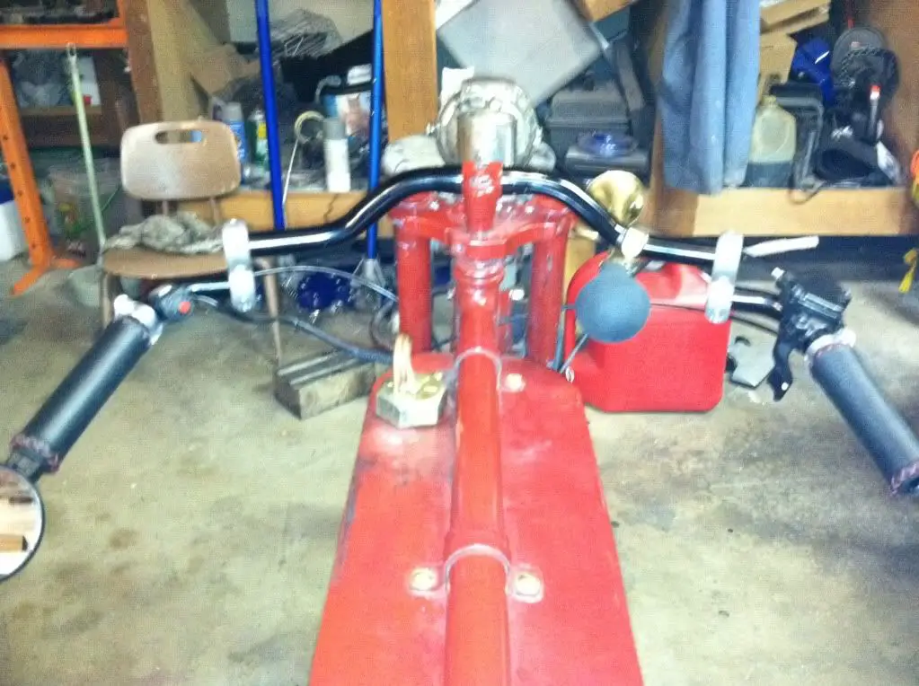

Got the new bar today! :) It came from CA so it shipped quicker than I expected. Looks sweet. Now the bike looks like a former board track racer that someone retired to street use with lights, plate, horn, and mirror. It feels great. I recommend this bar for board track builds. Sportsman Flyer bars are really high quality. The bars are aluminum and they have individual allen head bolt fasteners and a locking screw. Infinite adjustable.

Actually, yes Harry. The center of gravity is lower still with the new riding stance of the lower bars and it handles as well as it ever did. This leads me to believe that the ultra low racing stances of the old board track racers wasn't just about wind resistance, it was about stability too. It works.

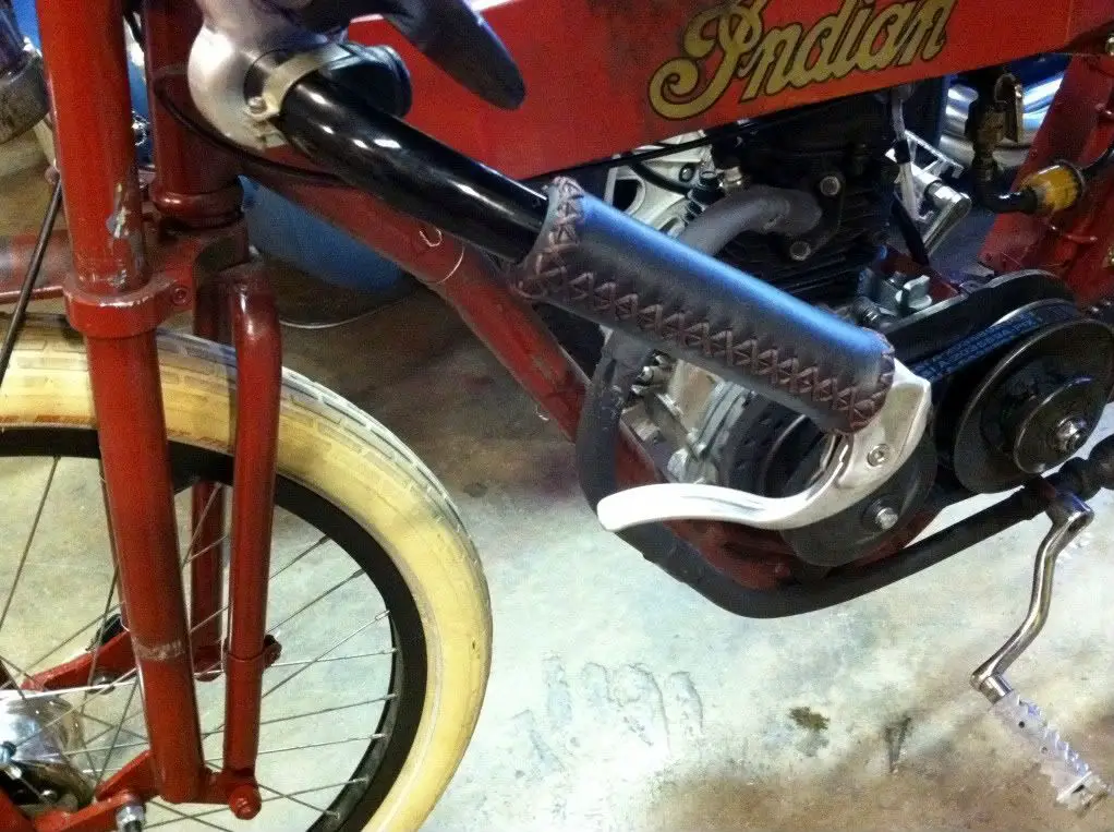

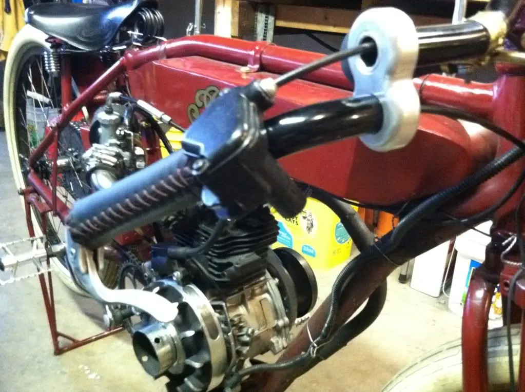

I took care of something that I have wanted to do for a long time. I found a pair of reverse brake levers with internal cable routing in silver (not the easiest things to find) so I could add a little bit of retro to the bike. When I got them I was disappointed that they were not designed to stick into the ends of regular 7/8 handlebars but extension bars for race bikes. So I had to "make them work". I had to alter them like crazy. Removing metal, removing parts, adding parts. But it is together, solid, and works great. The nice things about internal cable routing is I can run the cable through the split level board track bars much like the old bikes had their control lever rods running through their bars. The fit and function is really clean in appearance. I even put the throttle cable through the upper bar with a small hole for the cable to exit near the center of the bar.
