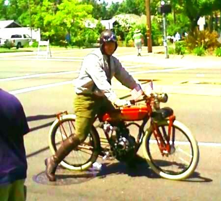

The 4th of July Parade was awesome!
Lots of room to maneuver. I ran into the President of the local Ford Model A club last week and he said I should ride the parade with them. So I followed last in a group of about 15 or so Model A Fords. I was able to circle, do figure 8's, and come along the far left and right along the edges of each side of the street. I stopped for photos often for people and answered lots of questions. I did lots of waiving to the kids and horn honking. It was a hit. Lots of applause. I recommend doing a parade for a vintage bike build in full vintage garb. Nothing like it. I'm looking forward to next year.
Very neat and a fitting tribute for a project well done. Maybe the kids will have something to think about, and next year maybe several vintage replicas in the parade.
