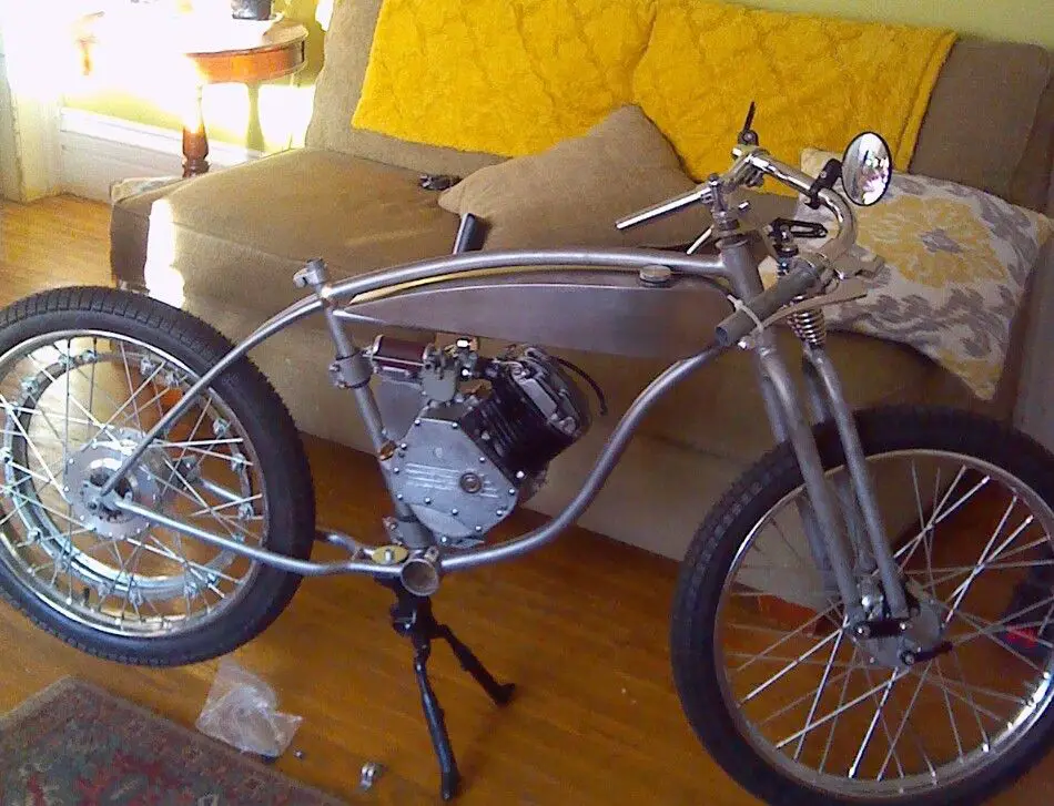

Since selling my Whizzer a couple years ago, pic. below... I have really missed it and decided to build another like it
I have a bunch of parts from a Briggs project that ended with an internally rusted out frame. I picked up a 1947H last June and sent it to Quenton for a rebuild ( details later) I just received a new solid frame and Sportsman tank from Norm at VMB and took use of free time at work.

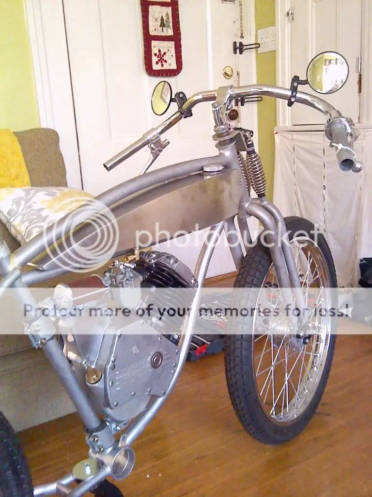

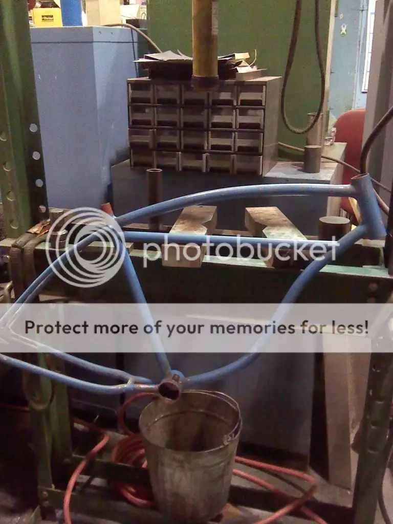

Frame before

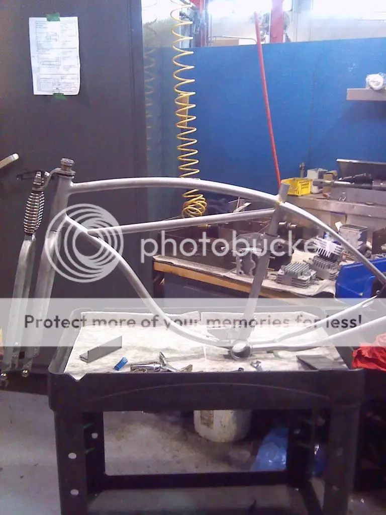

After.. the frame and Felt forks sandblasted

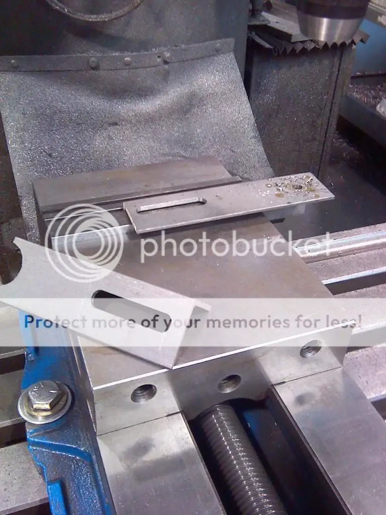

Dale (msrfan ) posted a thread where he used welded in mounts and after he answered a couple p.m. questions I decided to go that route.
I'm waiting to weld in the mounts as there are a couple more parts (brake tab, seat, tool box, and kick stand mount) that need to be either made or I haven't decided on.
