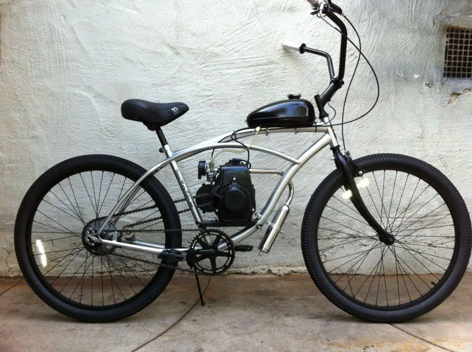

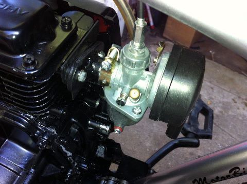

I've had trouble with a few 49cc 4-stroke carbs, & for the life of me, all the cleaning & re-adjusting in the world just wouldn't fix them; so I found a solution... I made a steel manifold that bolts a 2-stroke 'HT' carb onto the engine!!
I had to jet the carb two sizes bigger to get it to work right, but the engine seems to like it! (^) (I still want to play around with other jet sizes & needle settings).
Here's some pix...

Good idea, in the second picture it looks like it belongs on it. Sometimes when someone adapts parts it looks cluttered.
