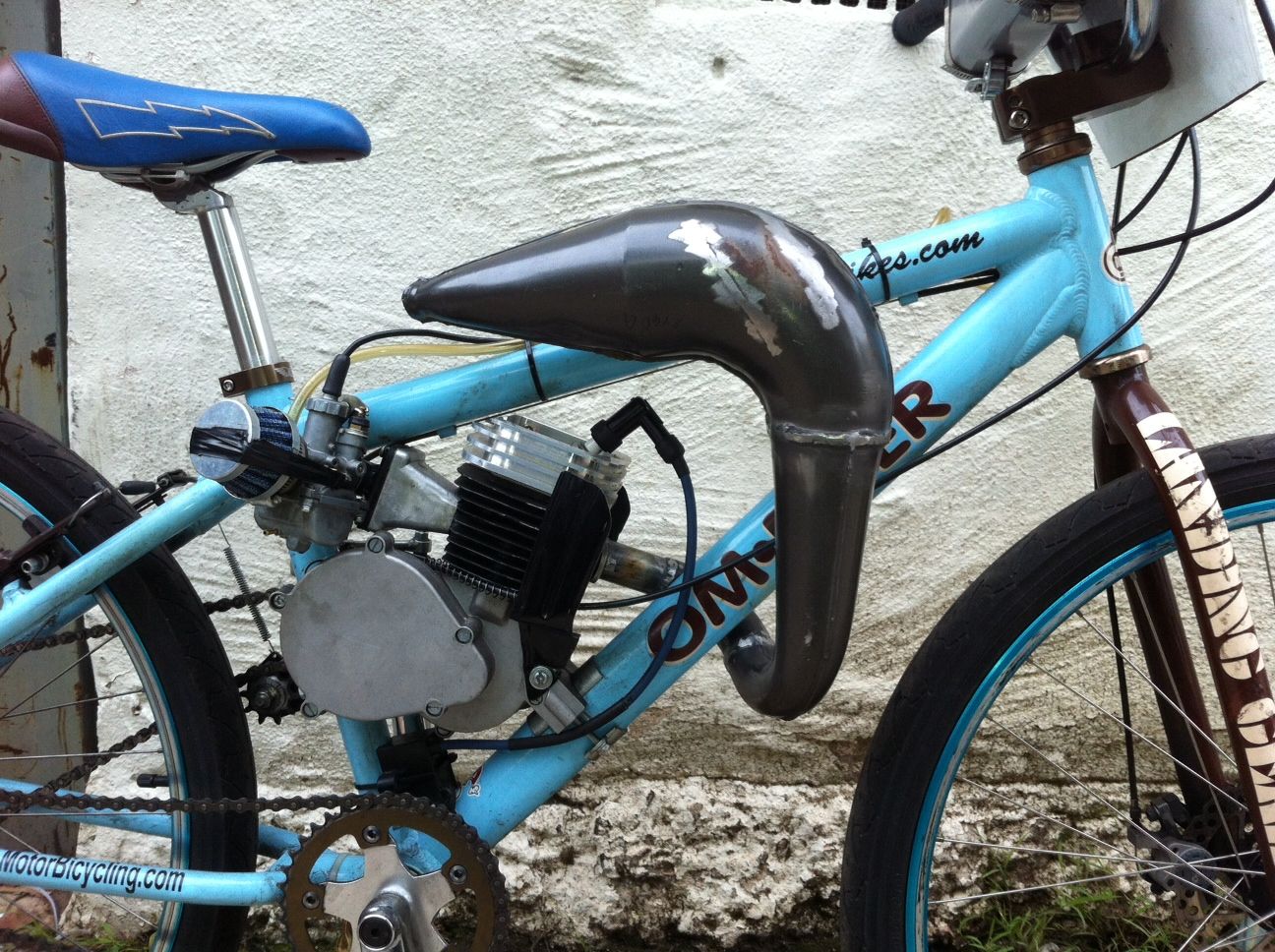

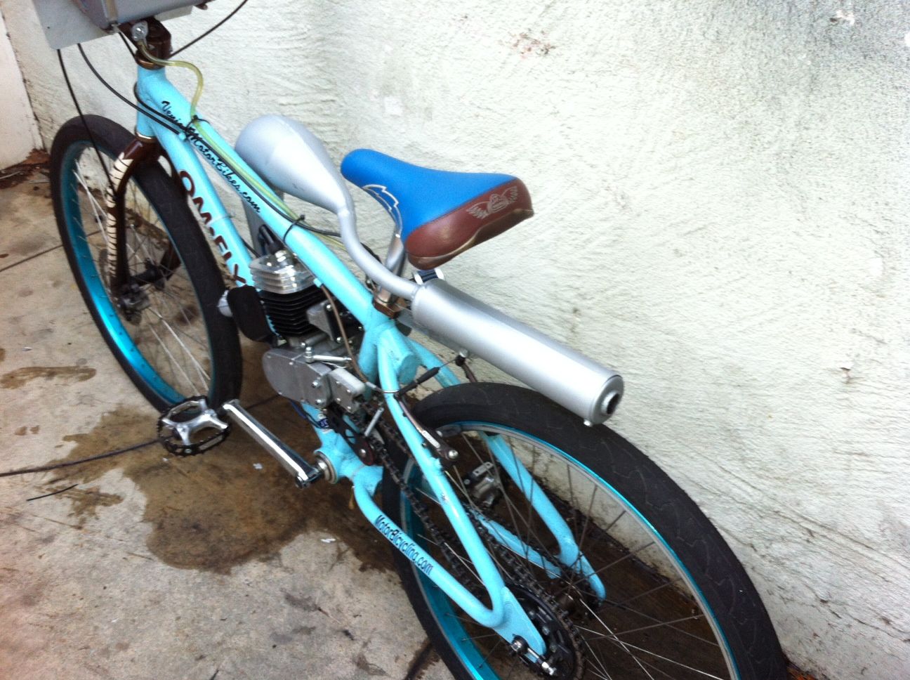

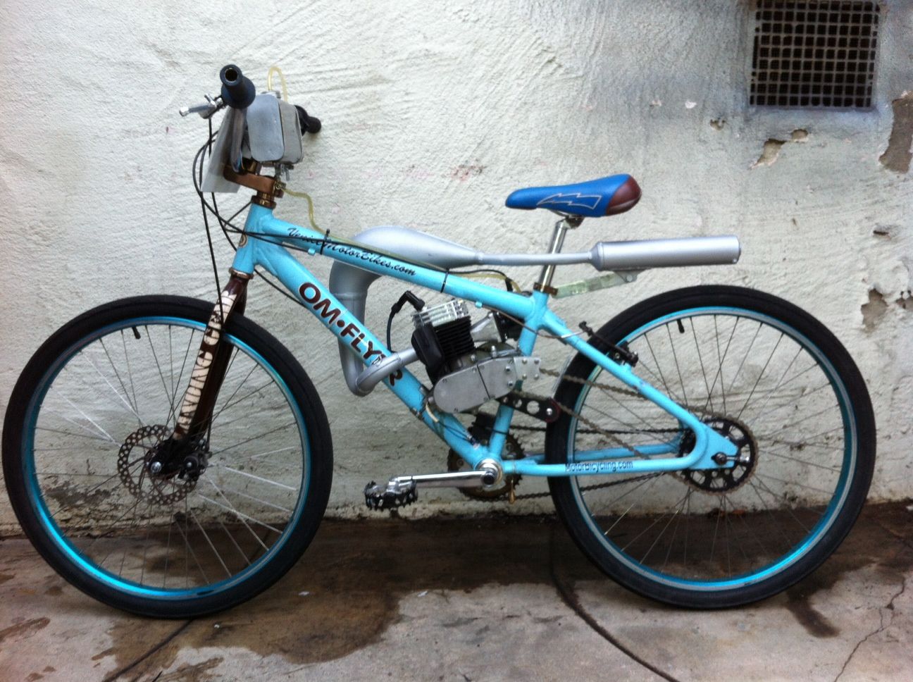

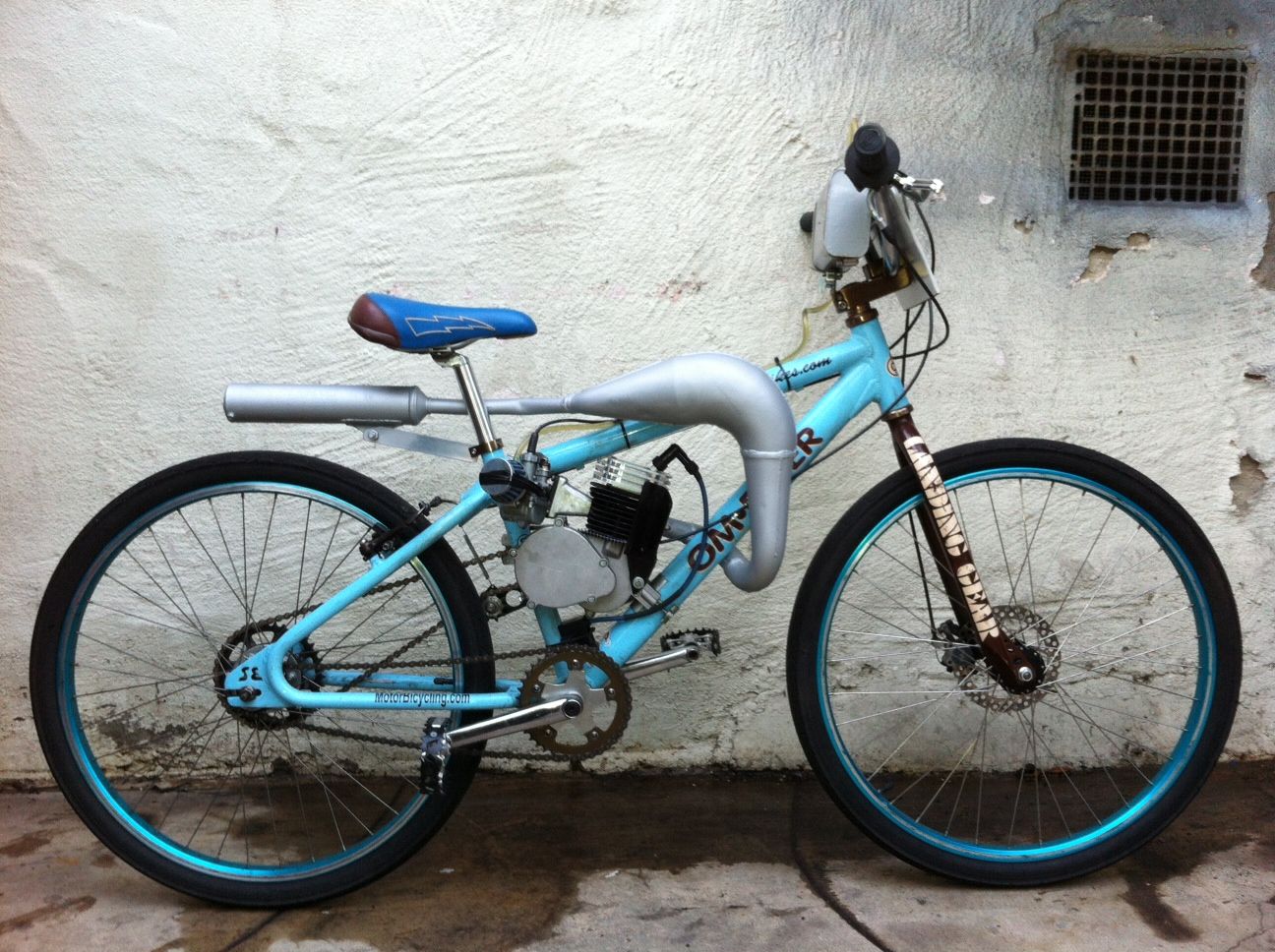

I finally had a little time today to cut up a used KX60 expansion pipe that I've had laying around the shop, & weld it to fit my OM Flyer race bike.
This new larger pipe has already added a little more power over the old pipe, but I still need to mix up some fresh race gas & re-jet the carb to work with this pipe.
In the first pic, you can also see where I cut off the factory hanger & ground it smooth.
Here's some pix...
I want to give thanks to Jeff (CCC) & Andy (Headtrama) for encouraging me to try to do this myself!
I've never done this before but they both pushed me to go for it; (& I think it came out nice)!

This pipe is actually far enough out front that there's plenty of room so I won't burn my leg... (Unlike the last pipe that was on the bike). :rolleyes:
I still might wrap it in some heat wrap, (just incase). ;)

I made the flange from a kit front engine mount & a short piece of EMT pipe.
I welded everything with a $70 MIG welder. ;)
*edit*
This is what I use on everything... I know it's a POS, but once you develop some skills, it works very well!

I'm not sure of the EMT size, (I just grabbed a piece that was laying around the shop).
The front mount that I used is one of those older ones that are suppossed to be used for drilling the frame.
& last... I use BBQ paint. ;)
