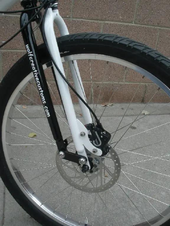

This is my latest build. Not really a person for white (have three white cars WTH) but after laying down some white primer I kind of like it. I am using the original rims that came on the bike and have added a disk brake hub to the front wheel. I have also added the sweet front end to this build. If you know what I ride this is a first...just love a ridged bike. I have also made a new style tank to hold more gas. The tank is raw with clear coat.

That's the start of a sweet MB! Have you seen the posts on those forks?or have they been beefed up already?Nice work! Kip.

That's an Abraham Linkage fork, right? I thought it was the Monarch fork that needed beefed up and not these. I looks plenty strong. Been thinking about using one of those on a future build.

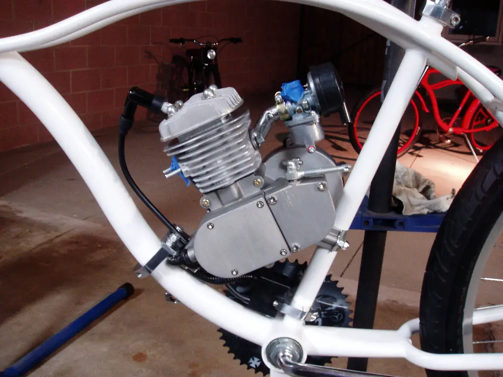

I posted some mock up pictures of my latest build (Albino AKA Aldyno) and now I have proceeded to have it stay white. The frame was powder coated and I detailed the motor. I finished it off with stainless hardware. The stock intake manifold was port matched the best I could to the ported cylinder jug. I gave some love to that boring sprocket and polished it all while I was at it. So far it is looking too clean to ride.
I am making a bracket for the front fork to install the disk brake. I will then weld it to the fork and repaint it.

The bike is now completed and running as of 11:00 am today. This bike sits different than my normal builds; the front position is higher due to the fork. I really like the way it rides and handles; the front fork is solid and takes the bumps well. I added a hydraulic front disk to the fork which required me to make a special bracket to hold the caliper. It stops on a dime.
The bike fired right up and to my surprise lots of low end torque for a new motor.
The bad: that little ***** (to make) tank has a small pin hole leak and I even used tank sealer on it…wtf The tank was pulled out and I will attempt to repair it. I may also not leave it raw and paint it. I just think the bike needs some contrast colors. Well maybe.

The Aldyno is now complete and running. The last item I needed to satisfy myself was the exhaust. Well this is it.
I have resolved my gas tank issues and added a little different design to the raw tank. I added a little sparkle to it also.
This is a very well riding bike and is now becoming my favorite ride if I can get my kid off of it.

Aldino is now done and running like a b--ch in heat. The chamber is complete and the carb upgrades are also complete. The upgrades to the carb worked out so well that I might have to offer an up-graded version of this carb if people are interested.
To this date this is the best motor on my builds; low end torque with scarry top end. This bike is a rocket.
