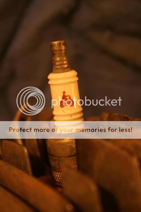

That is not really accurate, a plug size is meant to fit a given engine, if you look at the image the only thing that changes is the amount of white insulator in contact with the plugs outside metal case, the more insulator (colder the plug) the less pink tip left in the same overall plug lenth.
