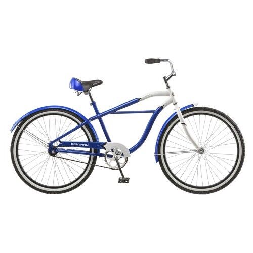

found a schwinn legacy frame that i think i might end up using for this bike on craigslist will know tommorrow.
Really?
Are you really thinking about mounting that monster engine in a used $129 Wallmart bike frame?
You should be looking at big 'ole Felt bikes like an MP and not kids toys IMO.
