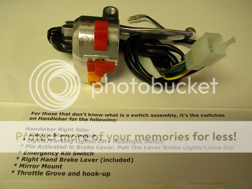

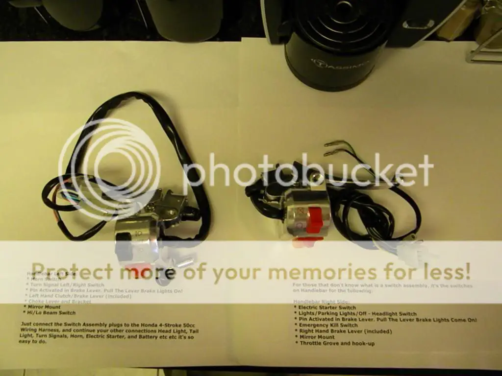

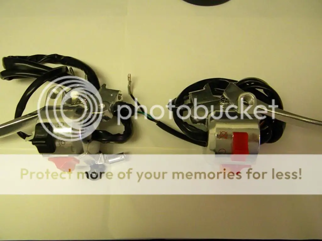

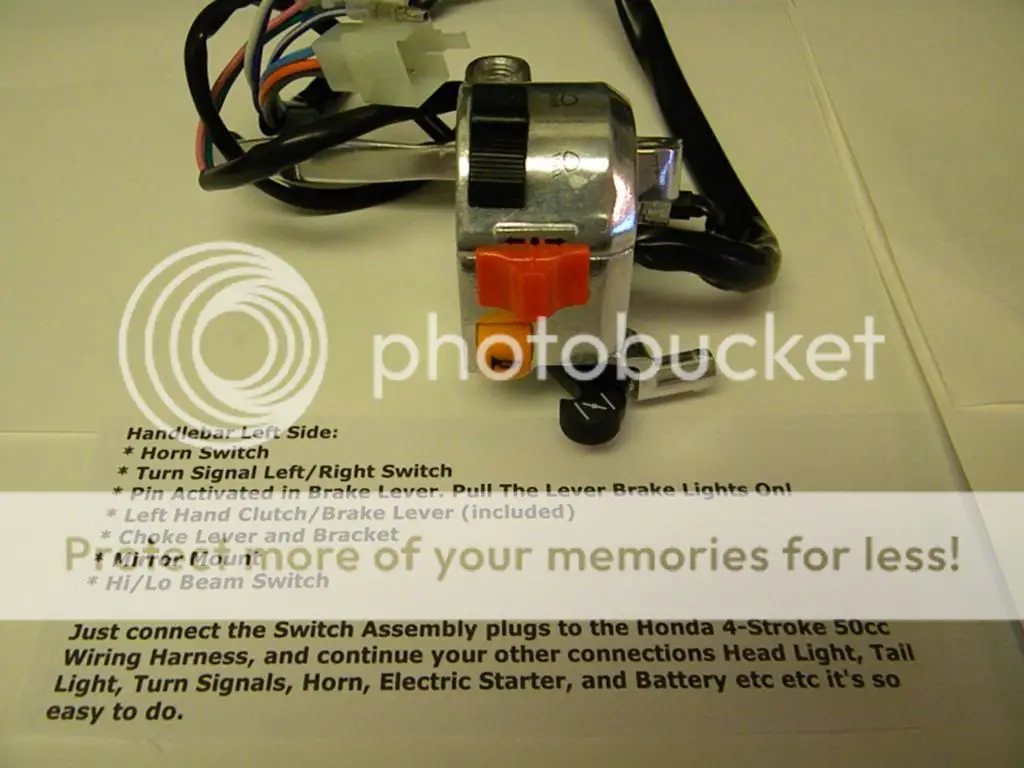

Charles8102, here's the switch assembly info I posted earlier in the thread!
My switch assembly's were delivered yesterday these are the same as were used on original Honda CT 70's & Honda Mini Trail 50cc Trail Bikes.
These are pre-wired to connect to the wiring harness for chinese cloned or original Honda CT 70 or any of the Honda cloned horizontal 4-Stroke 50cc 70cc 90cc up to 110cc engines, just connect the plugs together and your done.

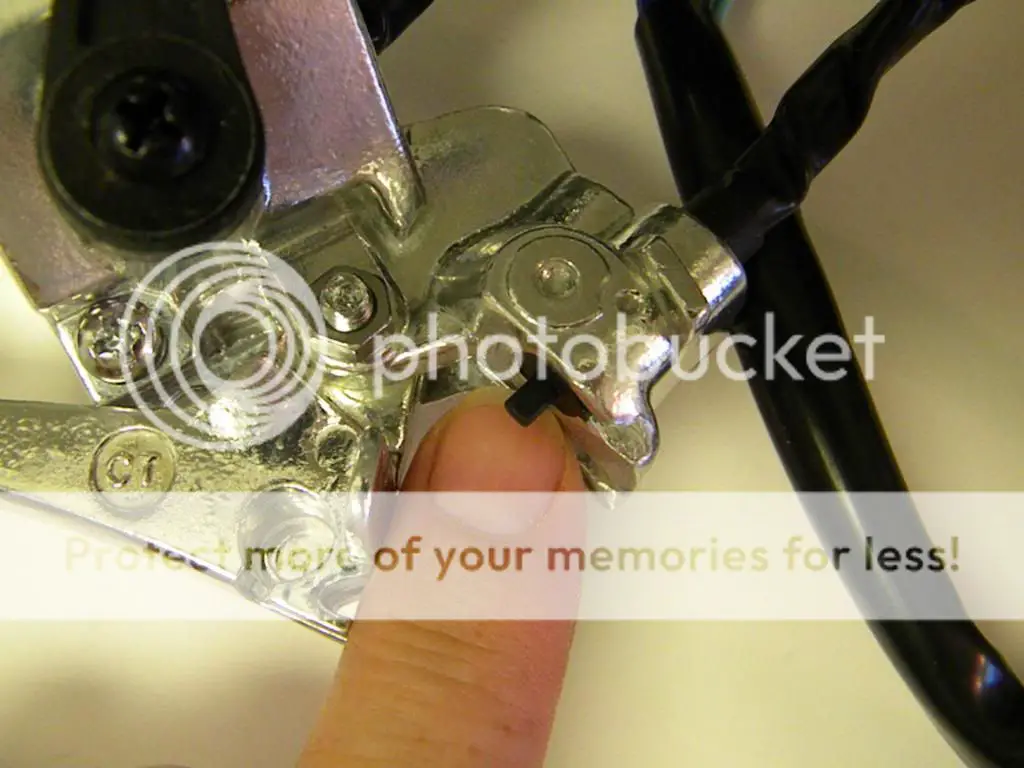

One of the nice functions with these switch assembly's is they have spring loaded PIN in the brake lever when you pull your break lever it activates your brake lights, this is great if you don't have a foot brake to activate your brake lights.
These have 5-Pin plugs for the 5-Pin wiring harness and can be modified for use with a 4-pin wiring harness.
Here's the pic's one has finger pointing to Pin that activates brake light when lever is pulled:
I purchased these switch assembly's from Greendragonimports on flebay $35.00
C.H.

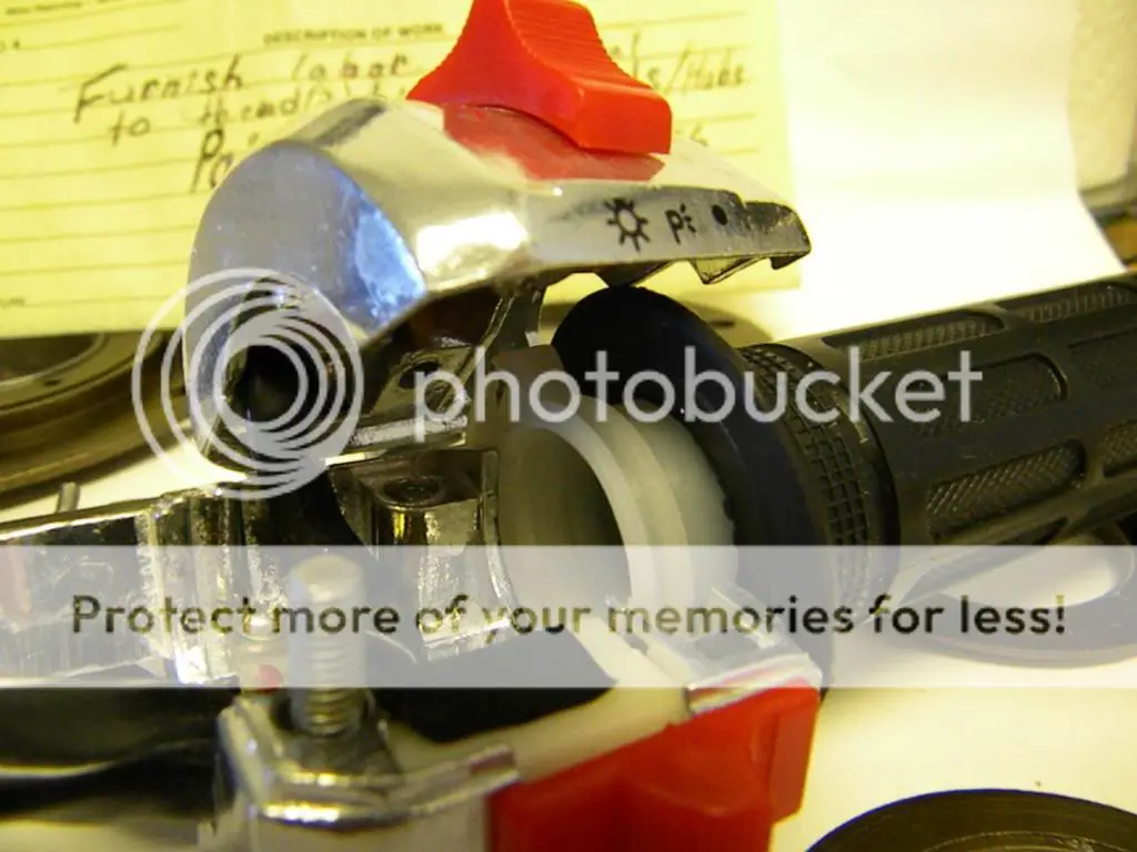

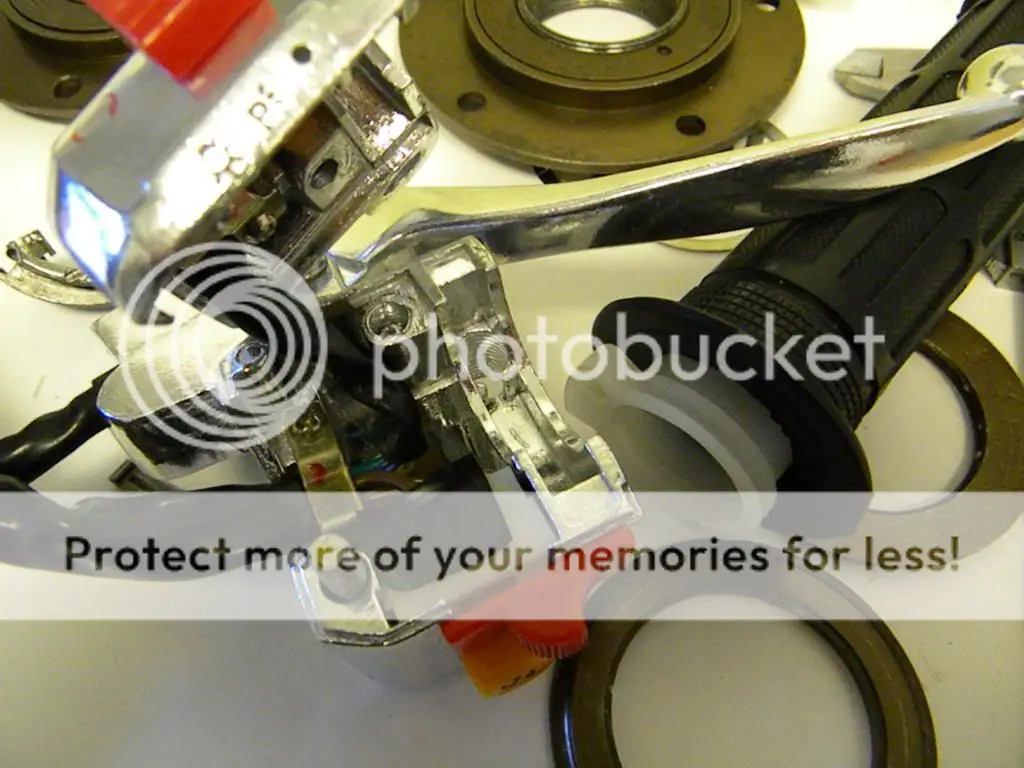

This post shows the throttle built into the handlebar switch assembly, for the Schwinn Stingray OCC Chopper & XL-Chopper builds!
Can't remember if I answered this someone was curious about the handlebar switch assembly, the question was where is the throttle it's in the right hand switch assembly.
See attached pic's:
C.H.
