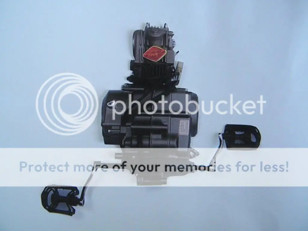

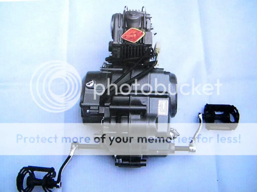

Here I go again with a different chinese Honda PC-50 cloned horizontal 50cc 4-stroke engine only difference is the pedals are built in to the engine seriously!
The pedals are on the same shaft as the one which is used normally to mount a kick start Lever!
Peace Crazy Horse.
so a all in one unit sweet. The combos could be endless with this set up. pedels made into the engine like some mopeds have but a lot stronger engine great find, where?
Still working on getting these engines from manufacturer!
And yes you can convert almost any bike to accept this all in one engine & pedaling system.
This is the one to solve many problems like chain alignment issues!
Peace Crazy Horse.
Sorry for the Confusion Gene,
I meant to post that I most likely will switch to this engine with the built in pedals.
This is a Lifan or Loncin chinese cloned version of the Honda 4-stroke 50cc fully automatic, I've contacted the manufacturer and am waiting for more info ie pricing, engine displacement available etc etc...
I'm really excited about the prospects of this being an engine kit for motorizing bicycles!
Just think about the possibilities using this cloned Honda 4-stroke with built in pedaling system.
Peace Crazy Horse.
the mount setup on these things are so easy! two bolts in the back. I can see unlimited options with this. 4 stroke, can be 50 cc auto for legal or could boost it up to 125cc 4 speed semi auto. I have 5 or 6 of these things laying around i wonder how that pedel shaft works?
